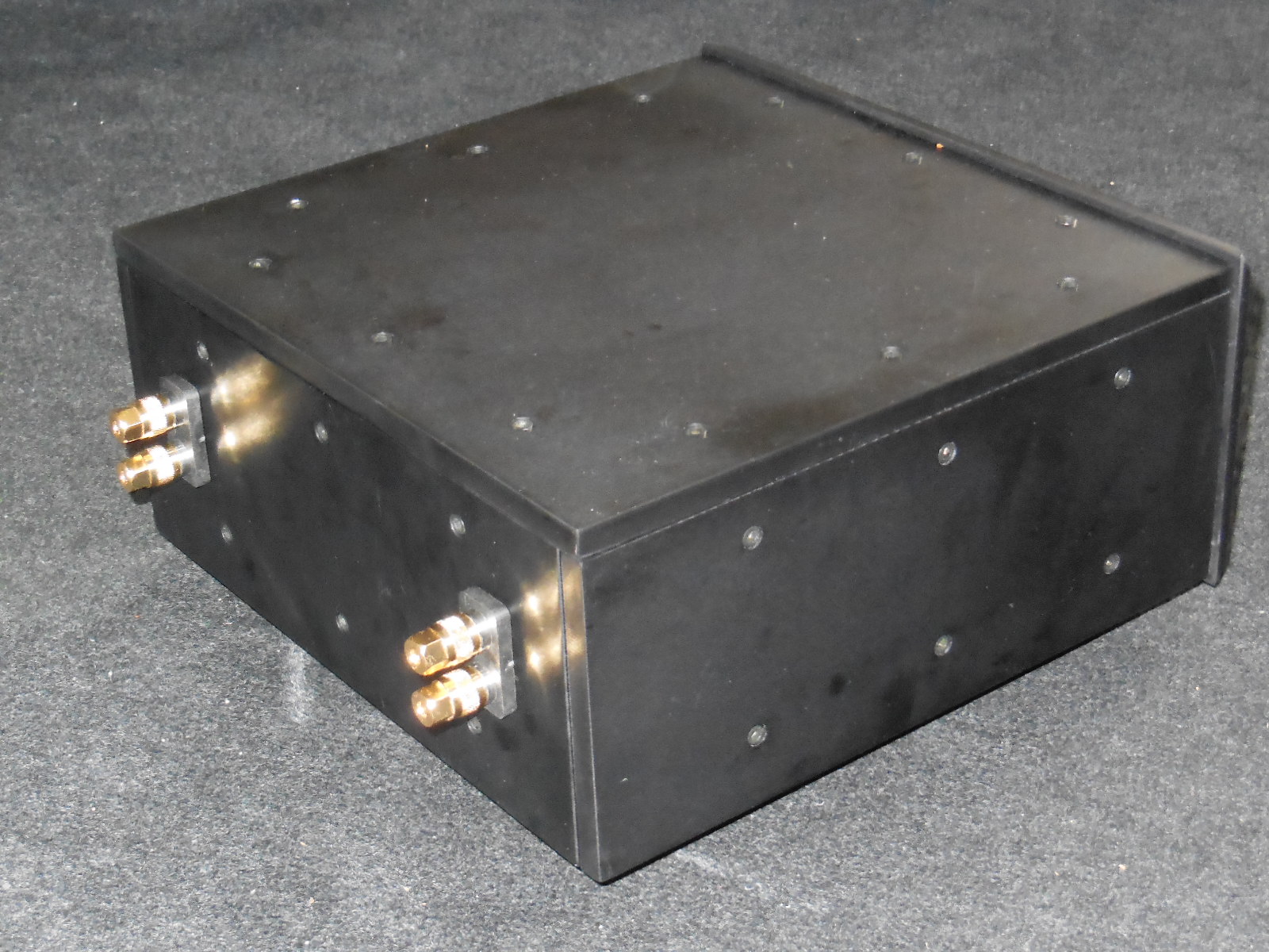

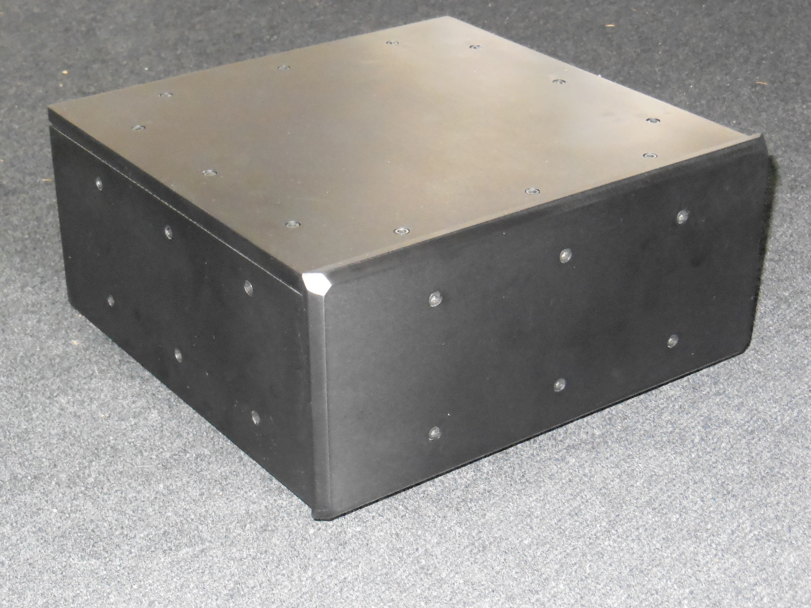

    In july 2012 (Post # 291 above) I described my experience with the installation of Perreaux Prisma 750 monoblocks to drive SDA SRS1.2a speakers. The monoblocks are not common- ground amps, and the experience of "firing them Up" for the first time with the SDA SRSs was not fun. The Perreaux folks steered me to this thread and advised me to build a Dreadnought using a Toroid Corporation of Maryland 600VA isolation transformer.
    I built the Dreadnought, and not knowing that eventually I would be able to purchase one of Larry's enclosures, I designed an enclosure, ordered pre-cut 3/8" aluminum plates, 1" x 1" x 3/16" aluminum angle irons, Cardas CCGR binding posts, and brass spikes to fabricate the enclosure. My goal was to have the aluminum components black, hard-anodized and to chamfer the face plate to resemble the face plates on my Perreaux equipment. While designing the enclosure, I assembled a prototype enclosure from 11/32" plywood, which I have been using for the last seven months with great satisfaction. (While the crossovers and binding post cups for the SAD SRS were being upgraded by Vr3 Mods -- that is, Trey -- I also used it with great success with my 1Cs and a common ground amp in a second system).
    After several months -- involving work with a local machine shop and a not-so-local anodizer -- I have finally completed the assembly, and I installed it in my system last night. In the new enclosure, I installed the A-L 1000VA toroidal transformer I acquired in the recent group purchase nspindel orchestrated.
    My first listening experience with the new Dreadnought v. the plywood-enclosed TCM 600VA AI was as follows:
    1. The most obvious difference was that to hear the music at the same level required a significantly higher volume setting.
    2. The soundstage was dramatically expanded horizontally and vertically -- about 4-6 feet beyond the speakers on horizontally and about 3 feet vertically. (As I recall, this is consistent with Darqueknight's experience with the A-L 1000VA transformer.)
    3. The geometry of the sound stage was altered. Darqueknight described his experience as a "crescent" or "m" shape that is thicker in the middle. His description is as good as I can come up with. In the center of the sound stage, instruments and vocals appeared to have a deeper space to perform in.
    4. Vocals sounded veiled; instruments sounded more prominent in the music. This effect was so pronounced that my wife almost immediately experienced what she described as "listener fatigue." She did not enjoy listening to the music unless I lowered the volume to a level that did not satisfactorily render the sound for me.
    5. Bass was emphasized, but was not as tight or well defined as with the plywood-enclosed TCM 600VA AI.
    6. Overall, the initial impression -- I expect it to change with playing time -- was that the very good sound we were getting from the plywood-enclosed 600VA TCM transformer was much better than the sound from the heavy aluminum-enclosed 1000VA A-L transformer.
    Attached are some pictures of the process of fabricating the new Dreadnought. In case anybody is curious the assembly weighs about 45 pounds! (More pictures in the following post.)

    I have additional pictures of my Dreadnought enclosure that I could not include in my prior post. As soon as I figure out how to reduce the size of each image (about 3.5 MB), I'll post them.
    Sorry for this glitch.

    Here are some more pictures of the Dreadnought enclosure in various stages of assembly and as finally assembled.
