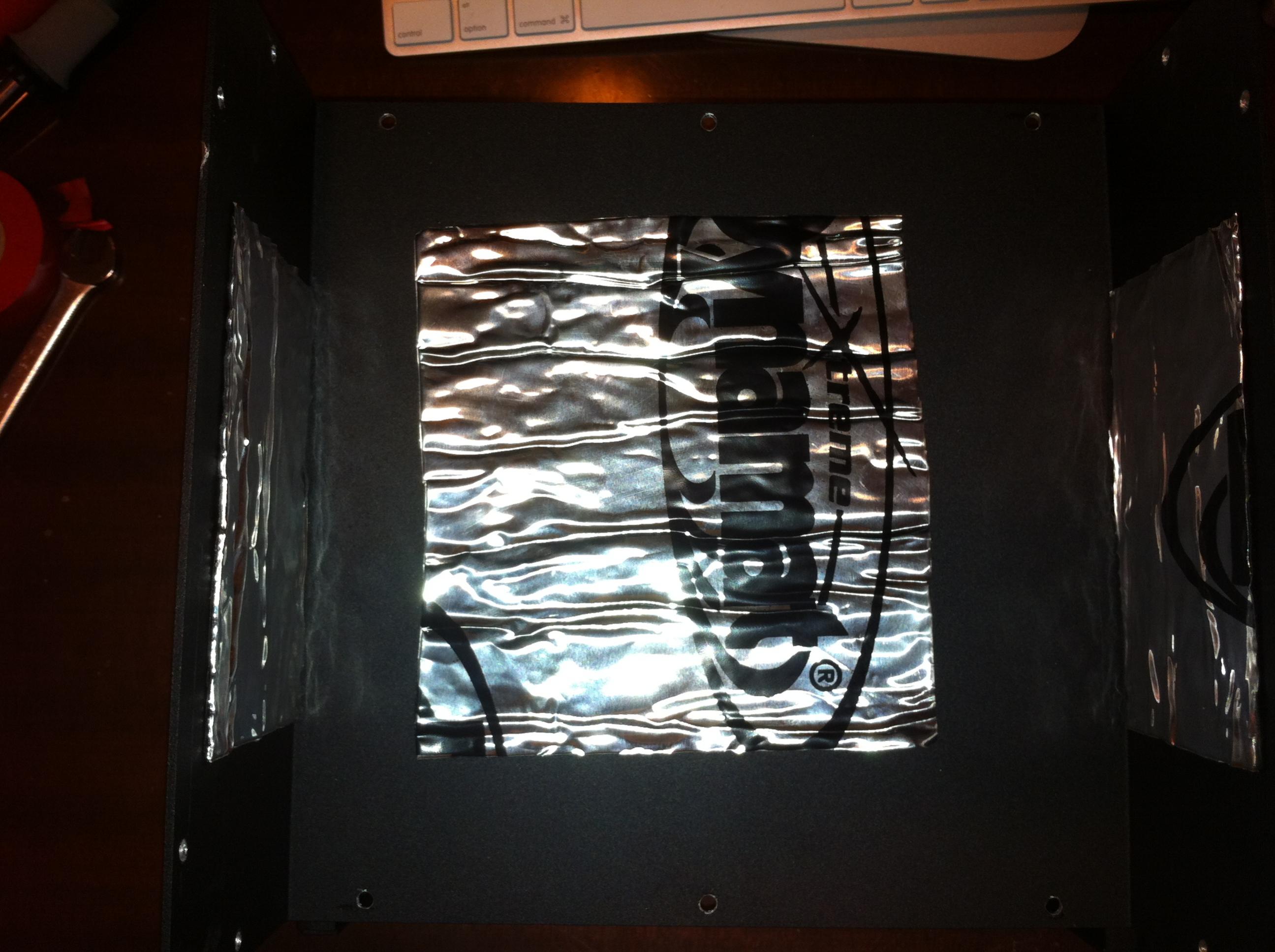

    I just finished my second unit and a transformer upgrade to my first.
    Dreadnought parts for a pair of CRS+'s.
    I had about 1/4" of clearance in the front of this smaller 10" x 10" x 4" case. I would have just drilled a new
    mounting hole further back if I hadn't had enough space in front.
    The obligatory Dynamat Xtreme to damp case ringing.
    The obligatory Cardas CCGR-S binding posts...only because they look so good.
    Interior pics of the new Dreadnaught. Very psyched I finally got this done!

    nspindel wrote: »
    Neil,
    Thanks for posting these pictures. I would never have thought of putting Dynamat Xtreme on the metal "washer" used to secure the transformer.
    Every little bit helps!
  • Moose68Bash
    Moose68Bash Posts: 3,843
    edited September 2012
    thsmith wrote: »
    Is there any reason not to build a case from wood ?
    I built a Dreadnought in a 11/32" plywood case that I wanted as a prototype for a 3/8" aluminum case that I am working on.
    The plywood improved the performance of the Dreadnought. My wife verified the appreciable difference. When I heard it, I was afraid it was only a placebo effect!
    I expect the improvement to be even greater when I get the aluminum case machined, anodized, and assembled. I plan to use it for the Avel Lindberg 1000VA transformer on order, and I hope to purchase a case from Larry to replace the plywood prototype.
