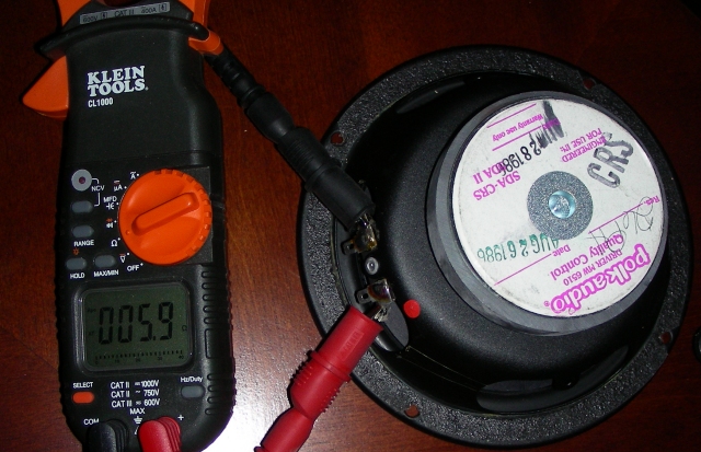

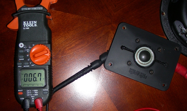

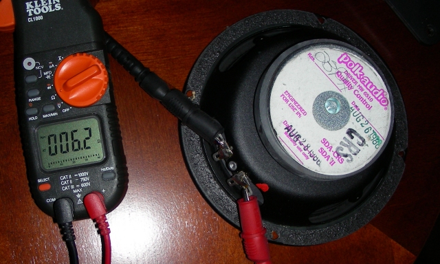

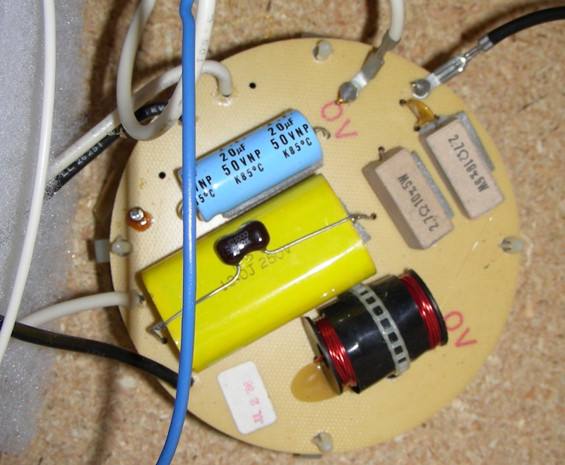

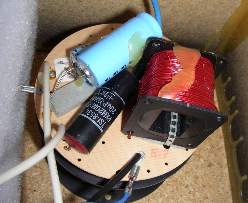

They are definitely blade/blade and the date on almost all the drivers is aug 26th 1986.
with all drivers unhooked, basically there is nothing but open circuits between the red and black and blade 1 and blade 2 connections.
Here are pix of the drivers and crossovers.
Hope someone sees something. -

Thanks for taking the photos, nothing looks like a likely candidate. If you would like to remove the crossover and send it to me I'll check it out and correct the problem at no charge. When I worked in Polk's CS I repaired quite a few crossovers over the years. Send me a PM if you want.

His two photos show one driver with 5.9 Ohms and the other is 6.2 Ohms indicating that neither driver is open.
