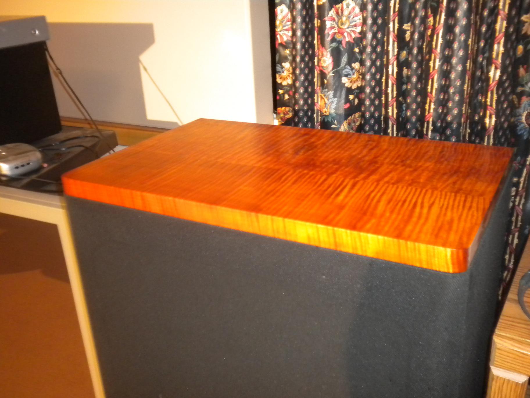

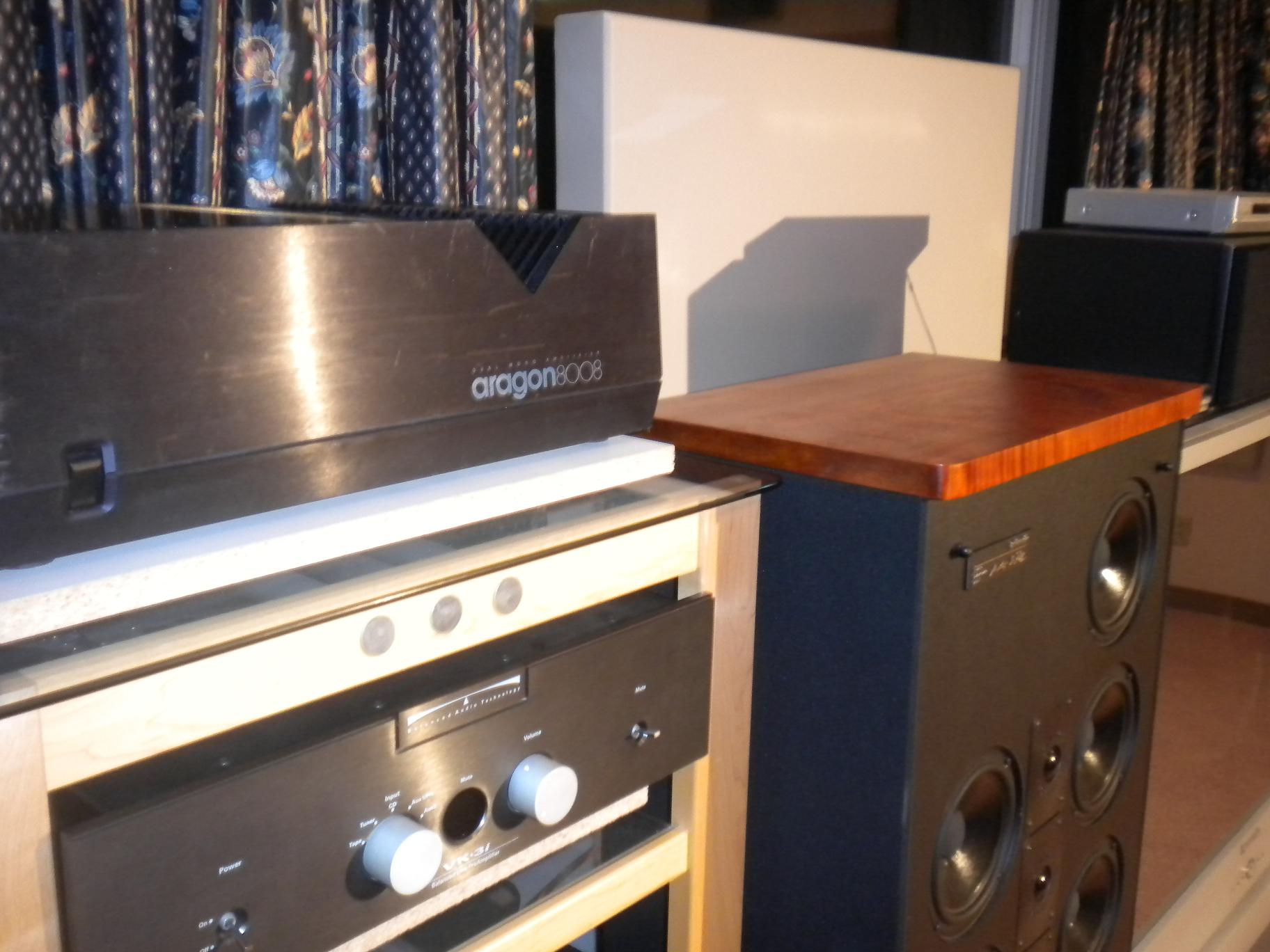

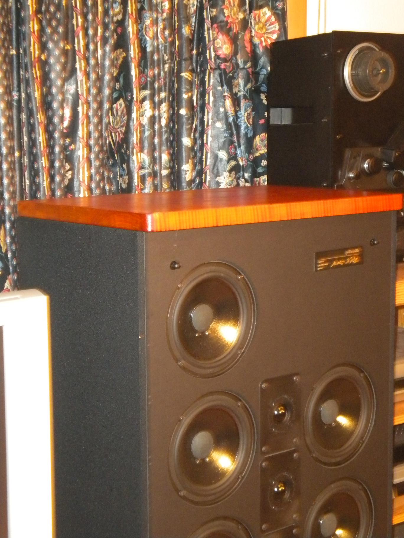

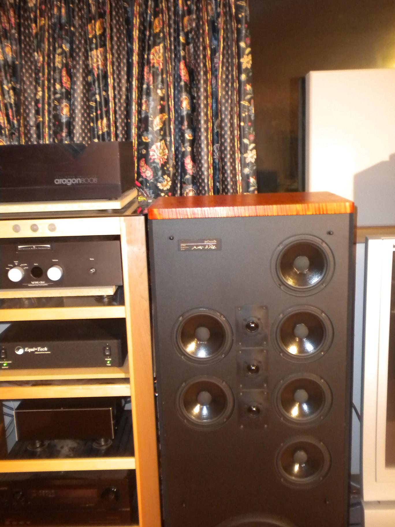

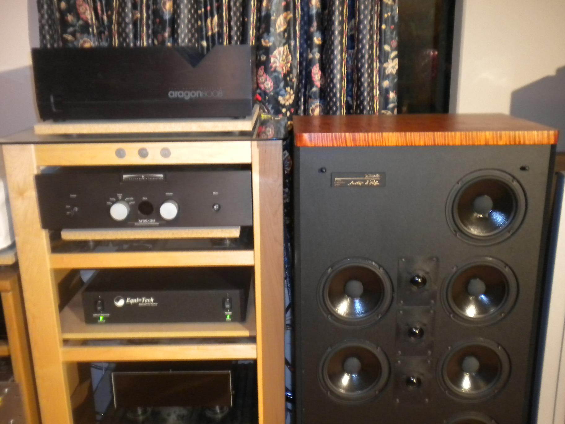

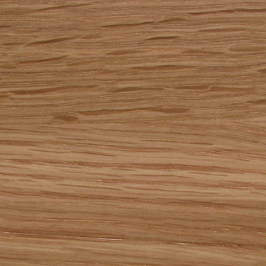

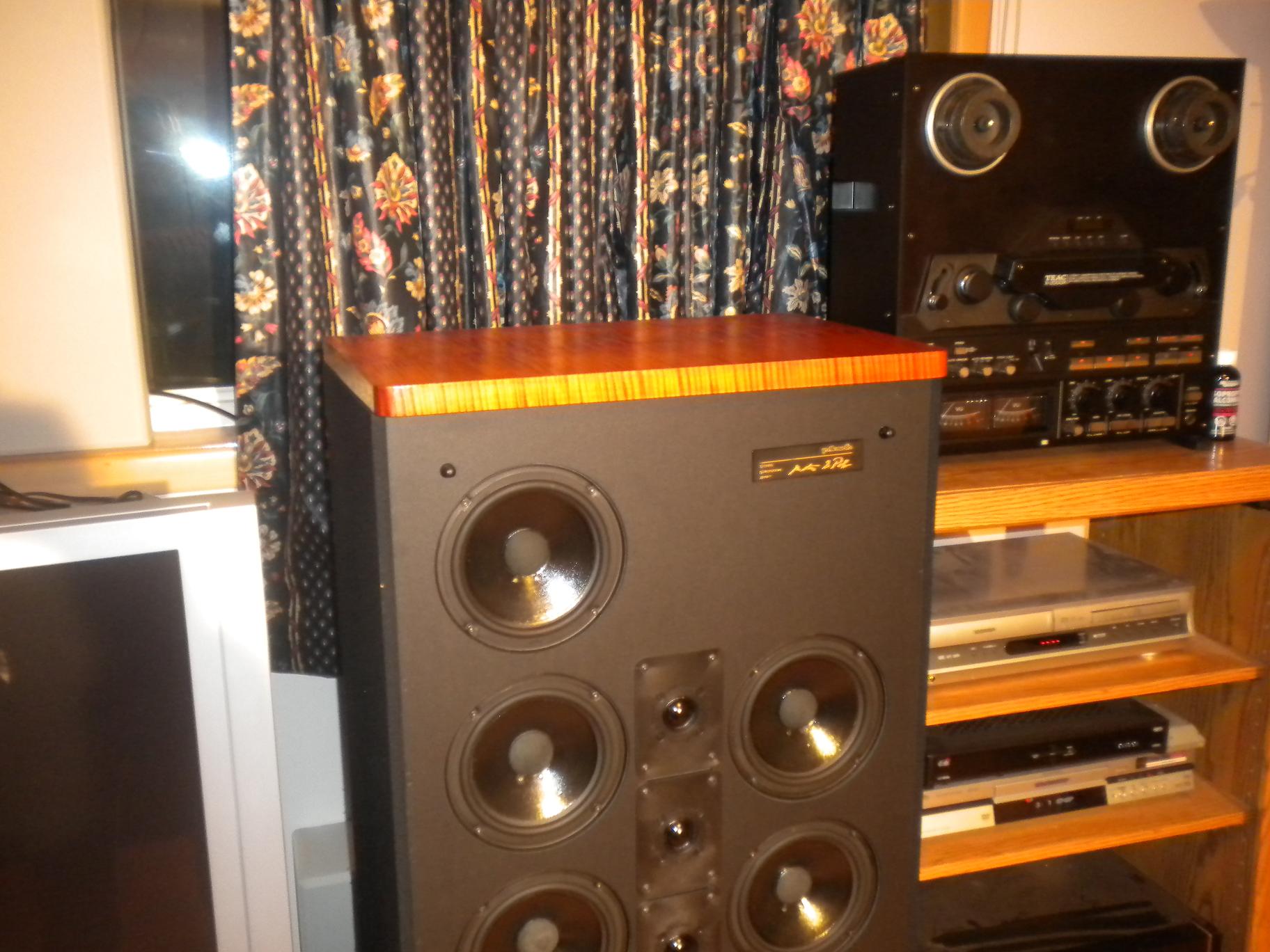

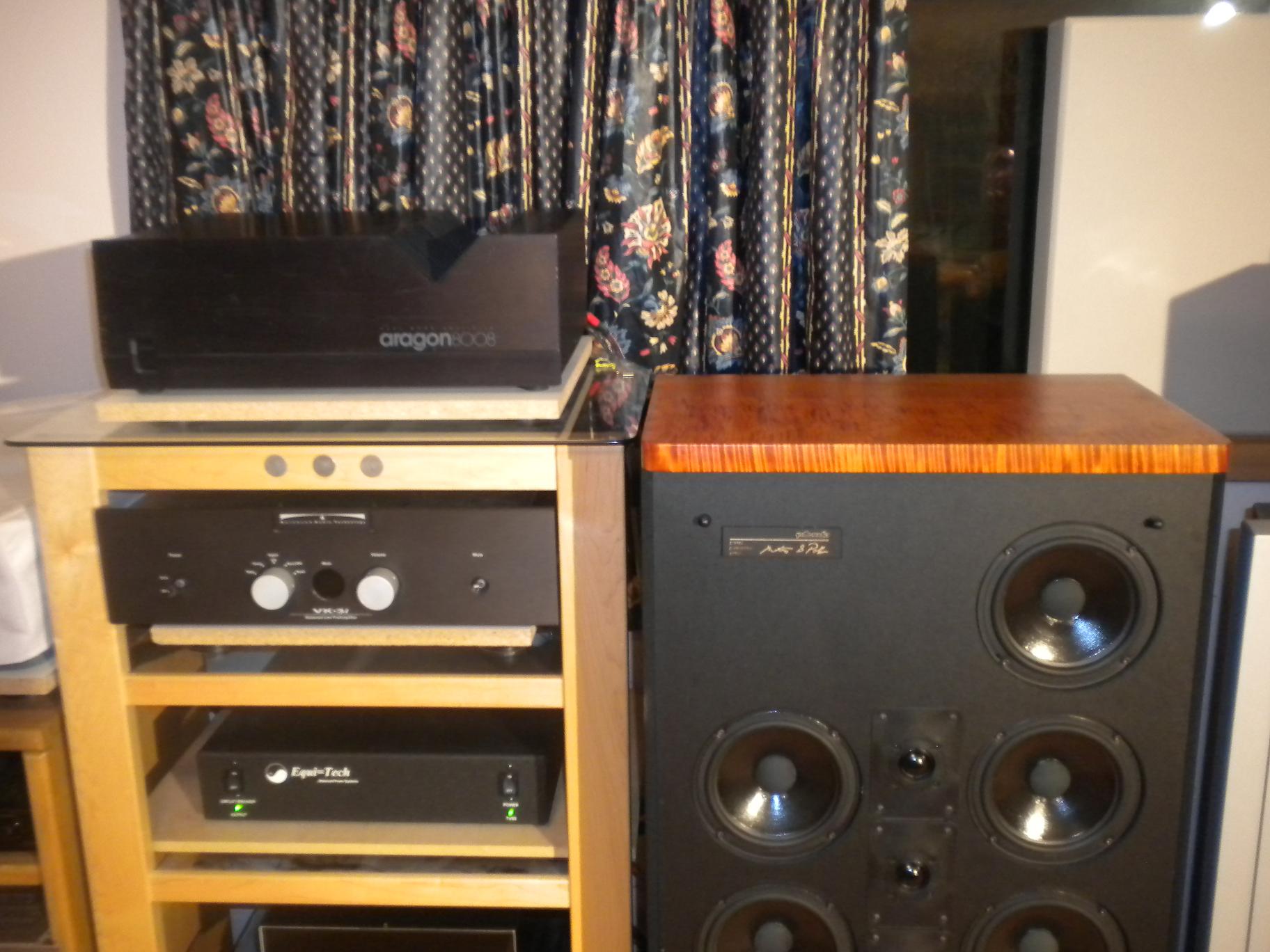

    Curly (tiger) maple end caps and side strips for my SDA SRS's:
    Figure 1. Curly maple end caps awaiting installation.
    Figure 2. I have never been a fan of any type of oak finish.
    Figure 3. Exotic curly maple is a more appropriate finish for a vintage flagship loudspeaker.
    Figure 4. Curly maple cap and the oak cap it replaced.
    Figure 5. Curly maple and original oak side strip.
    Figure 6. The exotic tiger strip figuring of the curly maple end caps is a much better compliment to the other wood finishes in my home.
    Figure 7. Even in this low resolution picture, the iridescent, three-dimensional appearance of the curly
    figuring is easily seen.
    Figure 8. Closeup of side strip figuring.
    Figure 9. Front/top/side view after installation.
    Figure 10. "Tiger" striping along front edge.
    Installation details coming in a separate thread.

    Even in this low resolution picture, the iridescent, three-dimensional appearance of the curly figuring is easily seen.
    This is due, in no small part, to the fact he uses an Aniline dye instead of a pigmented stain such as the type used by Polk on the original caps. The other part is how the wood is cut. Had Polk used dyed quartersawn oak instead of stained flatcut they would have had the same iridescent, 3-D appearance.

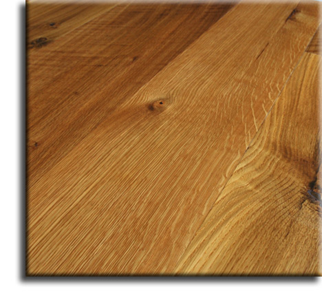

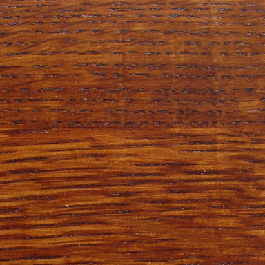

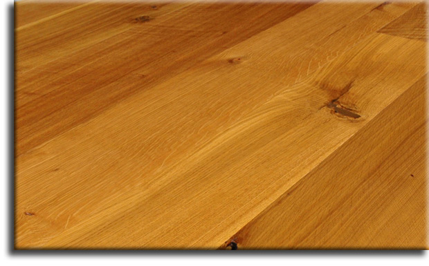

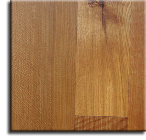

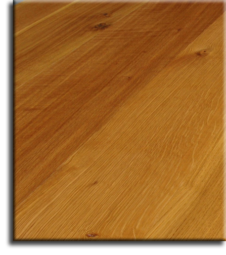

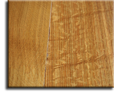

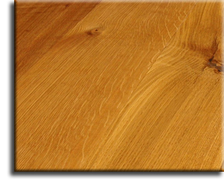

    I know quartersawing reduces the amount of retrievable lumber from a log. Is there a significant cost difference between flat cut and quartersawn and between Aniline dye and pigmented stain?
    But I still wouldn't have liked it. I looked up some examples of quatersawn oak.

    There is most definitely a price difference. Whether one thinks it is significant I'll leave up to the individual.
    There is also a cost difference between pigmented wiping stains and dyes. The cost difference varies even between the types of dye. There is one dye I use that is made in Italy. It's not cheap at all, but it's a concentrate, so depending on the application the actual cost per item can be quite reasonable.
    Those aren't the best examples. It looks like clear coated flooring without a dye, so the "pop" isn't going to be there. However, you still might not like it. Personally, I don't care much for oak.
