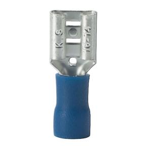

    Okay, I bought the 12 awg THHN wire from Home Depot, BUT, the female disconnects I bought for the speaker terminals (MW's) are not fitting properly. I mean, I can get them on and crimp but I don't think that's the best route.
    Here are the ones I bought: http://www.homedepot.com/h_d1/N-5yc1v/R-202522639/h_d2/ProductDisplay?langId=-1&storeId=10051&catalogId=10053
    Like I said, I can make them work, but I'd rather do things right. Where can I find the correct disconnects for the MW drivers? Also, I'll need the small disconnects for the tweeters too. Where can I find those? I thought about soldering them direct too...

    ****, the 12awg was too big to fit into the Molex connectors. Hmmm....

    You need to use 16 gauge tinned OFC wire (it's what Polk used), That Faston is the correct size for the MW drivers but not that 12 gauge wire. Also I think 16 gauge is the max size for the molex connectors. You'll need 0.110" Fastons for the small terminals on the tweeters. Try mouser or digikey.
    The "16-14" stamped into the side of the connector is the gauge of wire it is intended to accept. Typical of blue-colored connectors.
    Yellow-colored crimp terminals are for 10-12 gauge.
    I think the red ones are 18 and smaller.
    Can you "cheat" at the Molex end by clipping a couple of strands at a time until the wire fits, crimp and solder to the full-strand section? I've never worked with Molex, I don't know.
