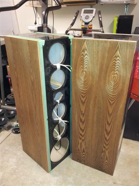

    I have a pair of the black rta's and looking to sand the black colour off, as I assume there is some veneer underneath, then once I get the natural wood colour, to use danish oil to finish off. At the same time, I will be rebuilding the xover and installing hopefully the new tweeters.
    Any other tips? leave standard wiring in or what?

    edited August 2011
    Sorry to burst your bubble, but It is a veneer, so you will not be able to 'sand the black off'. The cabinets are MDF underneath. You 'might' (used very loosely) be able to strip it, and bleach it, and then stain it, but I seriously doubt even that wold produce a desirable result. More than likely all that would likely produce some wrinkling or delaminating of the Veneer.
    If you are looking for a natural wood finish, you are going to be better off re-veneering them with a wood veneer you like, and then stain and finish them, OR get a pair in a natural wood finish.

    Thats fantastic tips, thanks kindly for letting me know before I started the process of sanding! in this case I will just sort out the spikes, and terminals, and await the new tweeters, once they arrive I will get onto the xover. and maybe at some stage I will re-veneer them. Once again thanks:)

    Decided to do it anyway, and here is what they look like now:
    Regards
    mark
    That's not a finish.

    Since you are clever enough to make statements like that, please explain your self, with your expertise in carpentry and I will be happy to accept your statement?

    Oil, like wax, offers very little to no protection from water vapor. Since one of the more important aspects of a finish is to keep water vapors out of the wood, I don't consider them to be a finish. They also perform very poorly in regards to durability because they do not cure hard.
    Use a grain filler to fill the pores, then apply a dye stain, top coat with lacquer and rub out. It will make the wood grain pop like nothing else while providing more than adequate protection and durability.

    Hi f1Nut, thanks for this... it is actually a very correct way too. I was going to use lacquer possibly at the end, but would not like the glossy finish, have you got any other ideas, so that the finish doesnt become glossy looking. Best Regards.

    Satin wipe on poly.
