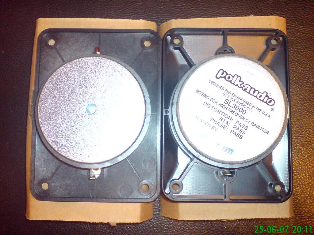

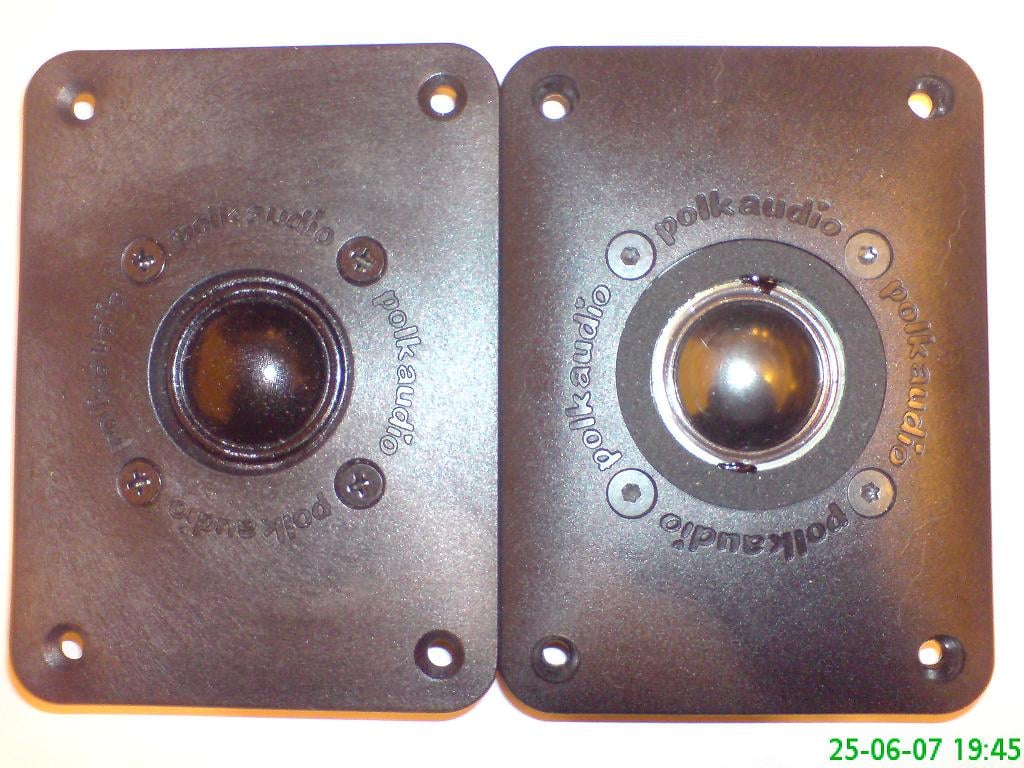

    Eight tweeters and two polyswitches were ordered last night. 48USD a piece +120 USD shipping :eek: . Anyway it will hopefully be worth it.

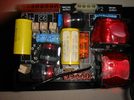

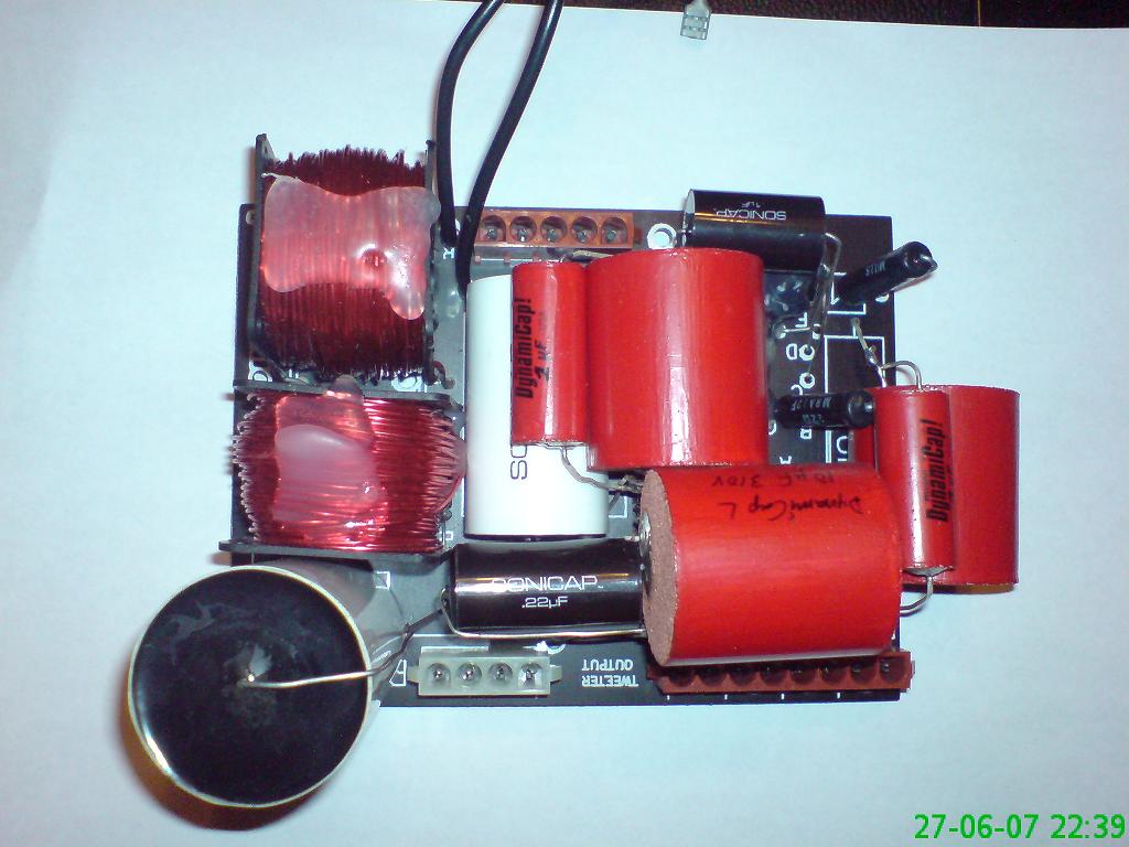

    There is one part of the upgrade which is very hairy. Look at the first picture. There is a royal blue capacitor half way up the board on the outer left hand side. This cap is butted up against the front of an inductor. One set of inductor leads is literally wound around the middle portion of the leads of the capacitor and soldered. You must be very, very careful when removing this cap from the board and from the inductor leads which are very fragile.
    The next pictures display how the new Sonic Cap is installed. When installing the new cap proceed with caution as not to break the inductor leads. . . if you do, you are in deep ****.
