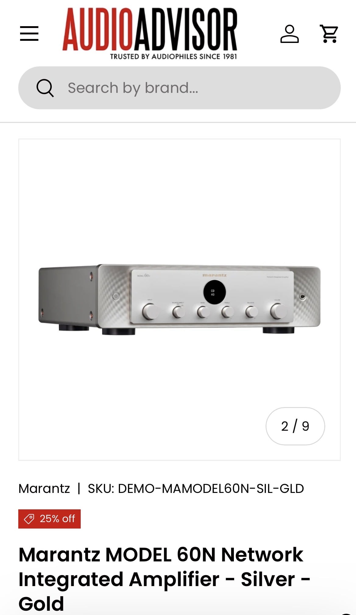

    A tad over budget, but a good deal on clearance at Audio Advisor: Marantz 60N for $1200.
