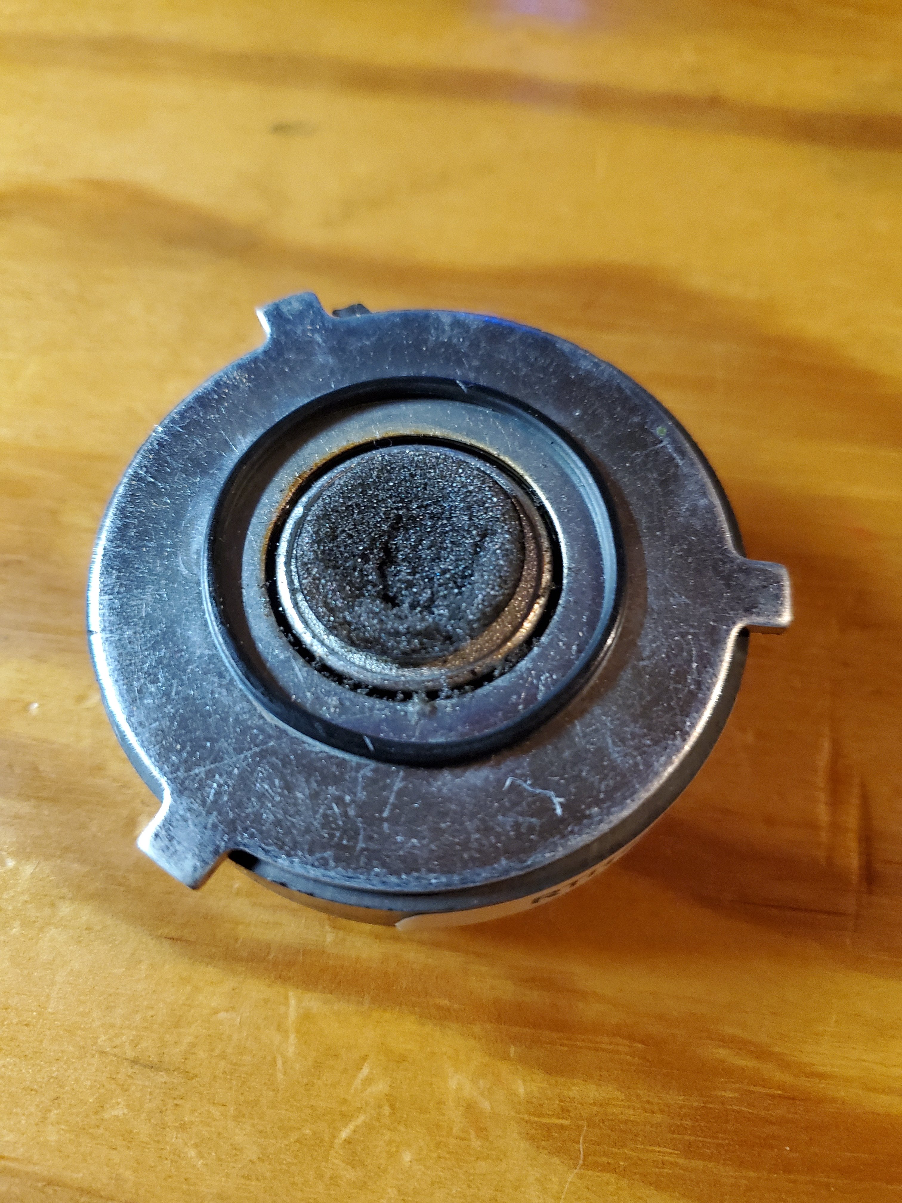

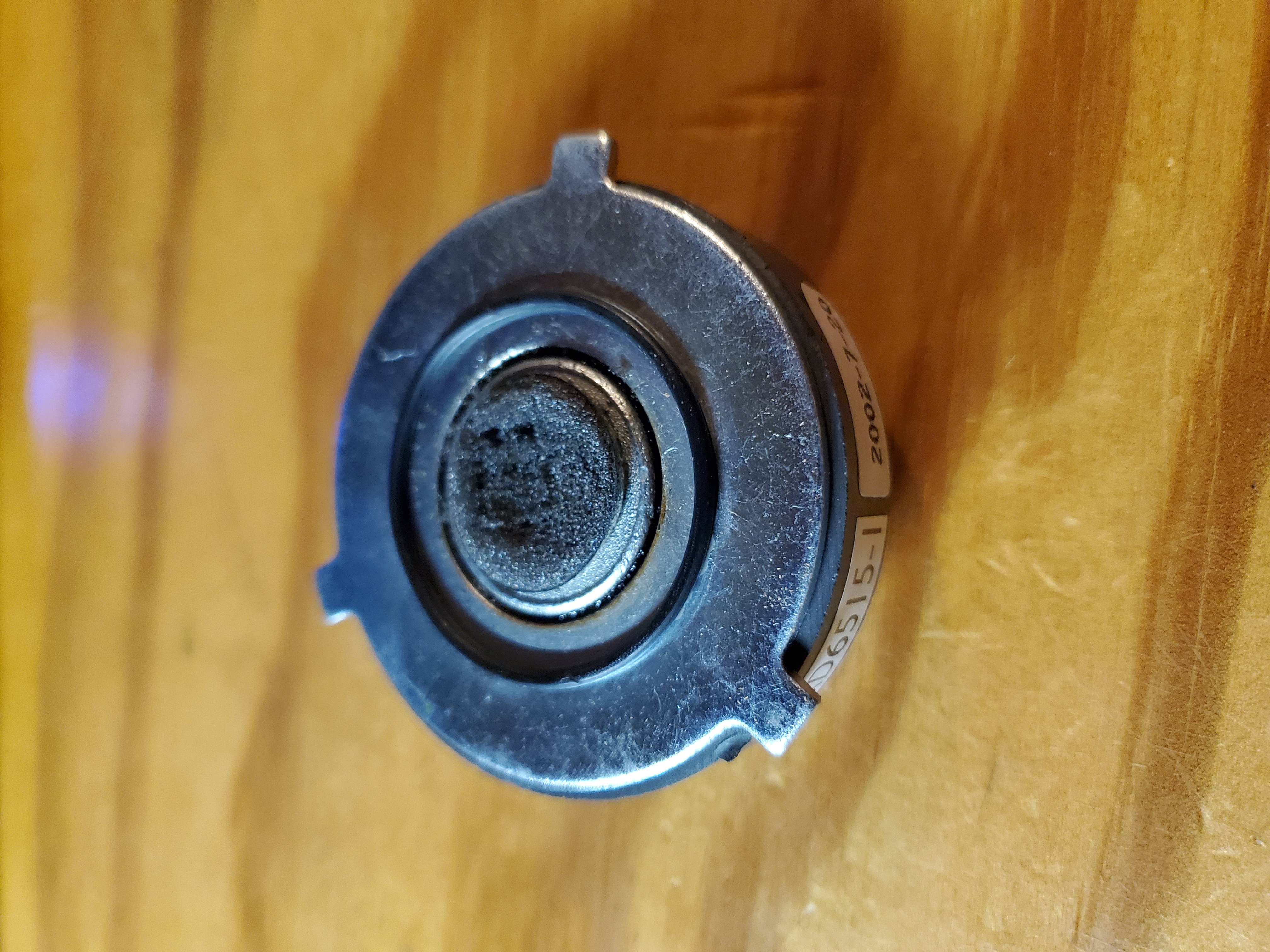

Polk RTi150's, RD615-1 Made 7-20-2002. Anyone know where to get new foam for behind the diaphragms? Reproductions would be better than none at all. These as you see have disintegrated. Thanks!
    pitdogg2 Posts: 27,914
    Try a felt dot.

    Is that pole piece just dished or is it vented all the way out the back?
    Looks like a layer of gray underneath.......maybe closed cell, with a coin/disc/dome of black open cell on top?

    Actually there is an open hole behind it. Nothing in it. These are the RD6515's that came out of a set of RTi150's that had both tweeters V.C. blown when I bought them. I replaced them with SL6506. Supposedly a Tri-Laminate 6 ohm. I have no problem with the sound. I just know that those are starting to disintegrate as well because I took them apart and changed out the ferrofluid. Not quite as bad as these but it needs to be replaced. I think @pitdogg2 has the right idea. I think that would work. Also thought of simply stuffing some lambs wool in the hole. Only question I have now is if the foam was supposed to touch the back side of the diaphragm. On the JBL 035Ti I restored it is. It supposedly cuts back on ringing/resonance. However, I saw no evidence that the foam was touching the back of these domes. These are those kits. https://reverb.com/item/93384868-jbl-035tia-tweeter-damping-replacement-pair
    Images of the Polk RD6515-1 cleaned off and the old foam. Looks almost exactly like the replacement JBL stuff.
