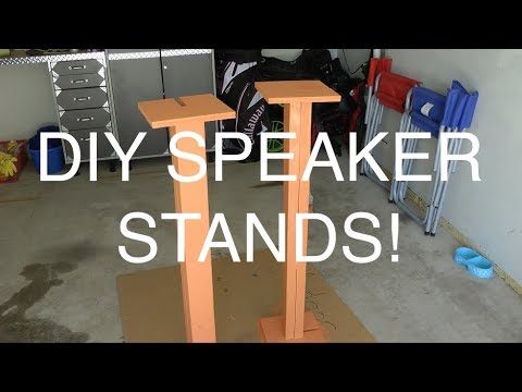

  • mrloren
    mrloren Posts: 2,474
    Build some stand to your desired height.
    https://www.youtube.com/watch?v=tljB1WmfwcM
    Use this to get the height you then either make or buy quality ones
    https://www.youtube.com/watch?v=CkoiDlDFRaM
