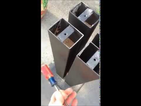

    Here's a short video with a demonstration of the differences that Dynamat and Mass Loading can make to the hollow, ring-y effect of thin steel.
    (Apologies for the portrait perspective; wasn't thinking much on the presentation at the time)
    https://youtu.be/SDqssPtTZOk

    When I was testing the damping methods I would employ, I started off trying Dynamat installed in the Pillars as others have done. I found it awkward to apply, essentially having to cut strips of Dynamat, lower them into the void without them sticking prematurely, and then finding something I could use as a "follower" to press the strips against the sides. I tested this with one strip about 15" long, and used a straight-edge narrow enough to get in there. It was okay, but I noticed that it really only damped in the area where the Dynamat was applied. Having the benefit of the experience with mass loading the SF26es, I knew that I wouldn't be completely satisfied with that, so decided to proceed with mass loading with Play Sand. In the interest of keeping things even, I still went ahead and put these 1-1/2" x 15" strips in each of the Pillars. Others seem to have found satisfactory results just with Dynamat, wanting damping without the weight, but I knew I wanted weight, too.

      thanks, man - yeah, I figured it would be a good attempt at demo'ing the difference after mass loaded for damping. these things feel really solid afterward. like you've got your speakers perched on a concrete birdbath pedestal or something.
    27. voltz
      voltz Posts: 5,384
      I got the 24" version and wish they were a little taller so I spiked my stands and even though I have not weighted mine down yet I feel they safely hold my 703's just fine.
