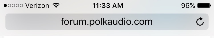

    Erik - I'm not sure how to better describe the problem. My phone shows full signal
    The computer also shows good connection strength (full signal) and internet connection (no yellow exclamation point through it). It even says "internet connection" when you hover the mouse pointer over the wifi signal symbol. However, it's almost like there is a split second interruption and even though all indicators say I'm online with an internet connection, going to a new web page or refreshing the current one results in a spinning circle on the phone for about 20-30 seconds and then the dreaded "safari could not connect because you are offline" or something. On the computer, it just says you are not connected to the internet when you try to go to another page (even though the wifi status says "internet connection.
    If I disconnect from the wifi and reconnect, all is good again for about a half hour. On the phone, I turn wifi off and right back on and it fixes it. I'm so frustrated with it. Just in the time I'm writing these two posts, I've had to turn wifi off and on twice...
