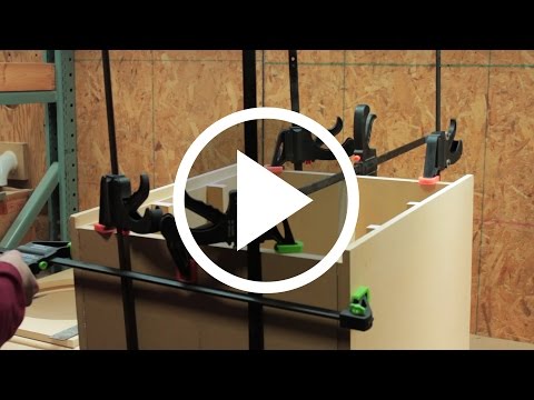

    That's a lot of kit for the money.That looks like a very capable woofer. Looking forward to seeing the finished product.
    Sure is!
    https://youtu.be/NcydtduDNec
    Watch the end when they throw down some test tones...
