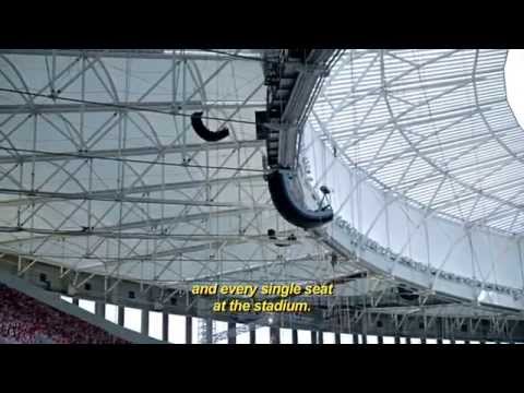

Many people don't know about Bose's Pro line of products. We do make some big stuff. Below is one of my favorite videos. This company was tasked with installing the sound system for the main stadium. A couple of the guys in the video came to Mass to give a presentation of their work. It was cool to hear about it. This isn't a Bose marketing video, but one for the installers. There are many other videos for the Roommatch speakers out there if you are interested.
https://youtu.be/aNpE3leHTVg -
Very cool. The Jonathan Livingston Seagull Theatre Sound System Competition essentially started the Pro Bose line, and dealers were reporting that musicians and small local bands were buying up 901s, turning them around for PA use.Home Theater/2 Channel:
