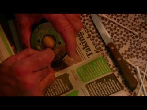

    True, but how do you remove magnetic sludge from the gap between the pole piece and the surrounding magnet?

    I don't know. Any ideas? Some Googling lead me to this, he uses a q-tip, alcohol, and what looks like masking tape? Skip to 17:35 maybe you know what it is for sure.
    https://www.youtube.com/watch?v=wtfqarUiFhw
    Looks like painters tape.
