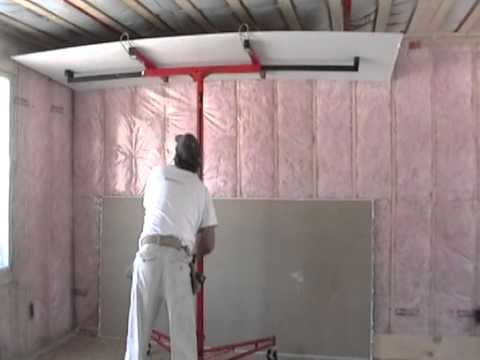

    Forget about the adhesive. Rent a sheet rock lifter and use 5/8" 12' sheets. Don't punch the screws through the paper layer of the sheet rock. Make sure that the butt joints are sister studded and/or fastened securely to an existing stud and look into a product called Levelline. This can be seen below;
    This will give you laser straight lines at all of your corners, provided your sheet rock install was completed properly, and is much easier (and long term reliable) than Straightflex or paper tape. If you were aiming for a level 5 finish, then some parameters need to change at the butt joints and finishing process but this should get you to a good level 4 finish....which 95+% of houses in America are max. spec'd too.
    Use a flashlight slapped up against the wall to find and/or correct any unwanted bumps, waves or other abnormalities BEFORE you go to prime or paint. Just don't get too hung up on perfection with this process or you will drive yourself nuckin' futz. It's much easier to correct any issues using the flashlight than it is to correct things after painting and priming have started. One note - If you can see any imperfections with the flashlight trick, you will see the same thing after the walls are primed and painted....without the flashlight. This becomes exemplified when any sheen above Satin or Eggshell are to be used on the drywall.

    Hanging drywall with a lift isnt a big deal, but your neck will hurt and it's time consuming.
    I hung all the dry wall in my little 650 sq ft shop-house. We have low ceilings which made it cake.
    Taping and floating on the other hand, sucks. Big time. I built my entire shop (2000 sq ft with 650 sq ft of living area) and did the entire thing except for the slab and...taping and floating. I refuse to do an area bigger than 25 sq ft. Walls aren't that bad, but still bad enough where I paid someone to do it.
