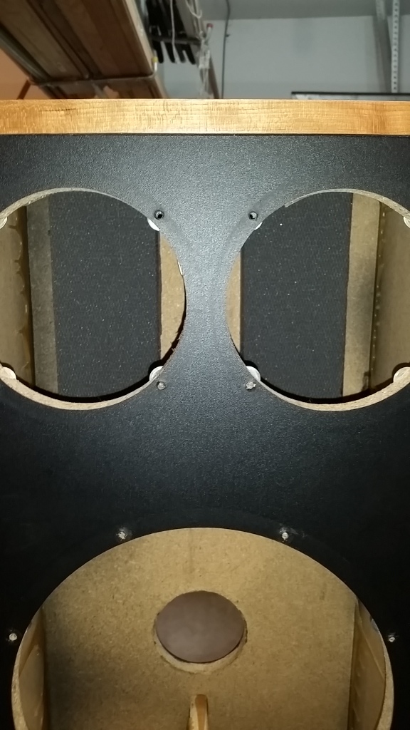

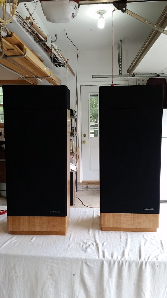

I have been working on the cabinets of my RTA 12c's for the past few weeks, patching, sanding, and applying new cherry veneer. Finished the girls up yesterday and moved them back into the living room. I used a neutral stain on them and hand rubbed poly. I opted to make new bases out of solid cherry to replace the beat up black ones. While they were apart I installed some Black Hole 5 behind the MW6501's. New 14 gauge cabinet wire was used to replace the flimsy original wiring. Gold plated copper binding posts completed the final upgrades....and yes Dave, they are a pita to tighten down. Thinking about modifying an open end wretch to make the next ones easier to install. It was a fun project and I was quite pleased with the results. I have enough of the veneer left to re-do my Monitor 7's but those may have to wait until winter.

    Thanks everyone. It was a fun project and it might be my imagination but the even sound better than before. lol

    Thank you. I just cleaned them with a soft cloth and a little 409. Slow and careful cleaning and they look 100% better. Amazing how much crud came off of them.
