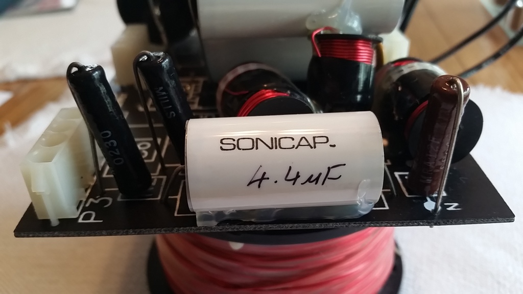

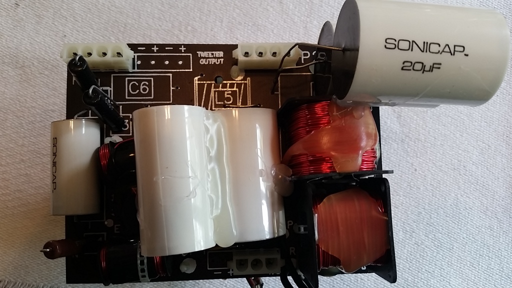

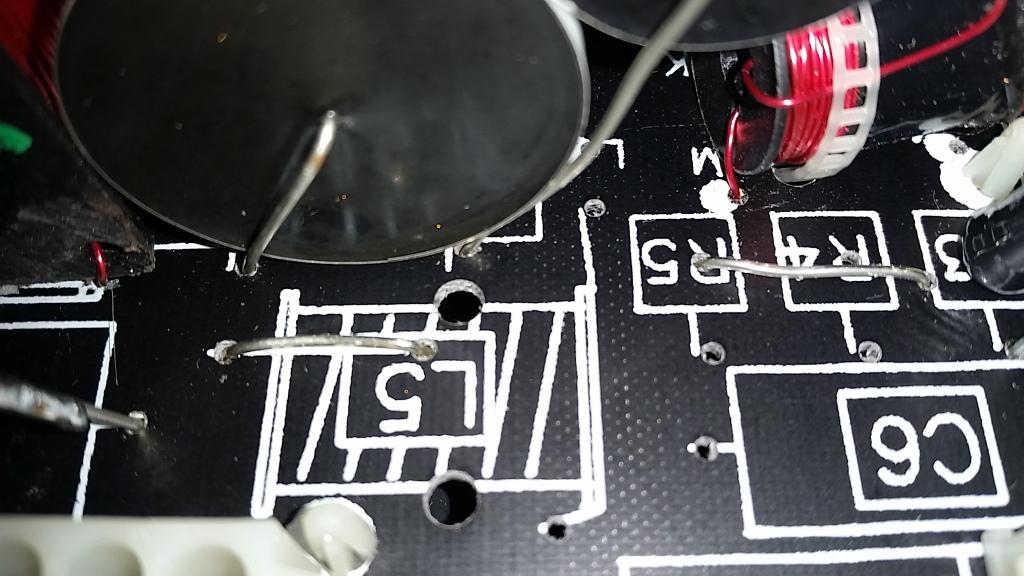

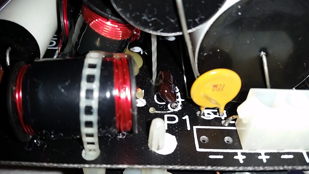

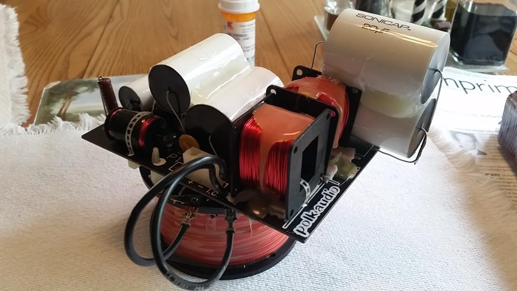

    Here are some pictures of one of the crossovers. Solder points look good. Cap and resistor values look right. Poly switch is still in. Anyone see something amiss?
  • westmassguy
    westmassguy Posts: 6,850
    edited May 2014
    Yeah Bruce, the Silver Mica Caps are still in place which could be causing the problems your having with the RDOs. Just de-solder them, do not jumper. Replace the Polyswitches with two 1 ohm resistors in parallel..

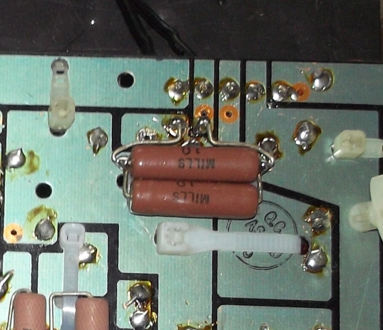

    Here's how to parallel and mount the resistors to the bottom of the board. I use a strip of 3M VHB tape under them.

    Sounds good. Is the silver mica caps the brown component next to the yellow poly switch? Not familiar with them.
  • westmassguy
    edited May 2014
    Yup, not required with Metalized Polypropylenes
