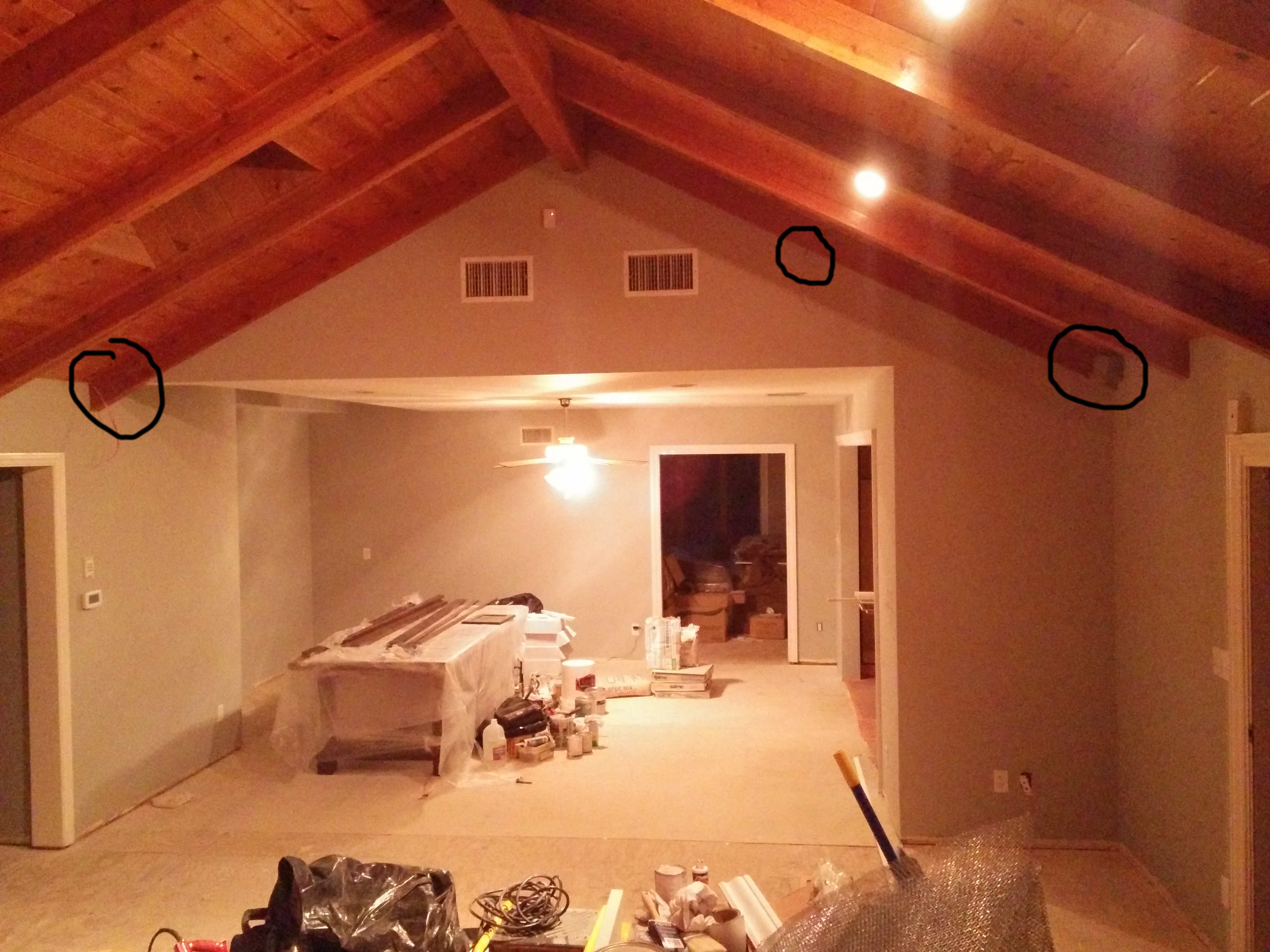

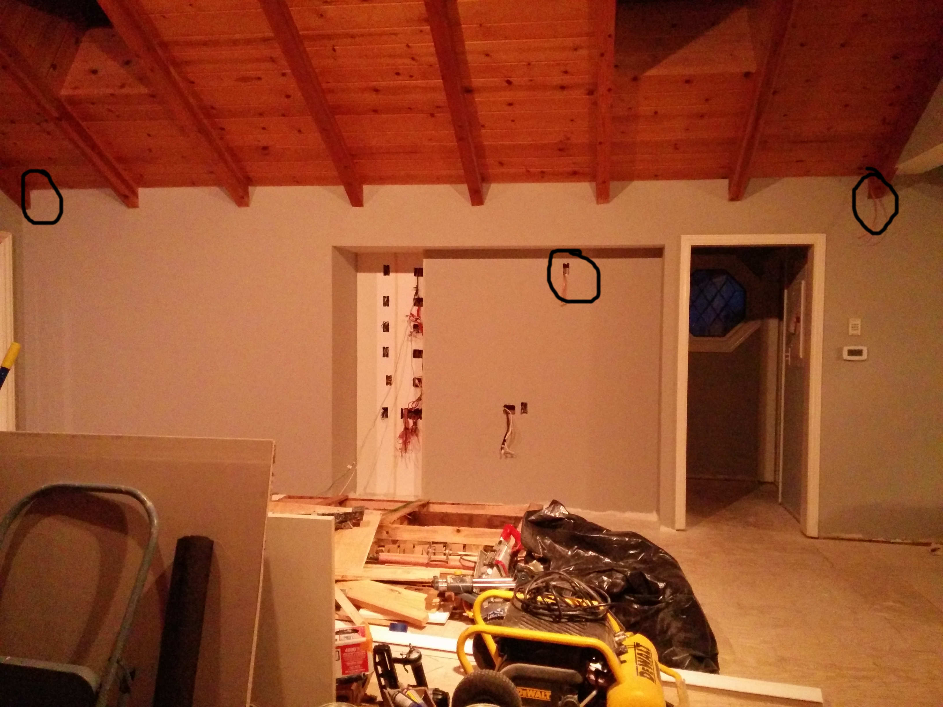

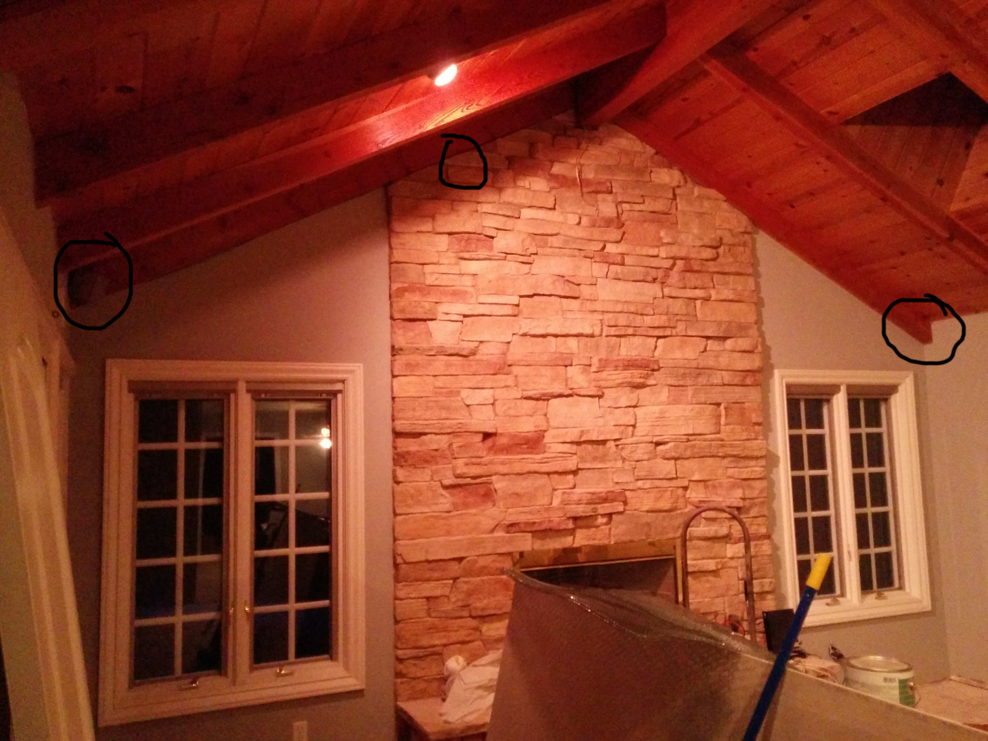

    It's probably easier to describe the layout via photo than descriptively. The vaulted ceilings are probably 12'. I'm planning on mounting all the speakers on the wall (except the center which will be on a shelf). I know it is probably far from the ideal layout, but it's what I have to work with.

    My goal is to put together as much bang for the buck as I can get. I'm not at all shy about going used to get more quality/$ than I'd be able to get new.
    Given that, would http://www.polkaudio.com/forums/showthread.php?160104-FX1000-Surrounds-For-sale-200 be a good investment?

    Those would be a good start. And considering you've got the walls right next to the rear speaker locations the outward facing drivers would have something to bounce the sound off of and you may not need the extra left and right surrounds.
