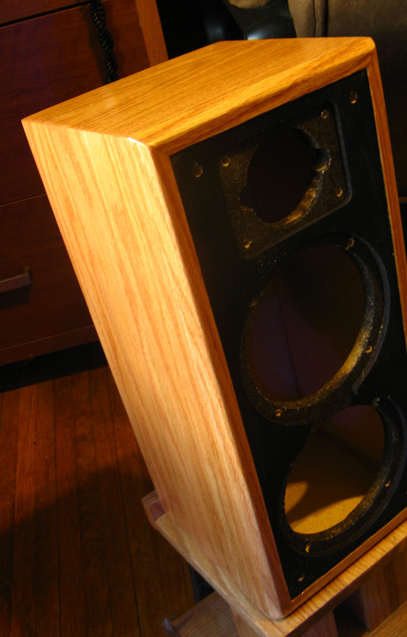

    just a quick pic for now... I have been busy with going back to work and long hours. This is 8 coats of semi-gloss finish, sanded, and drilled for hurricane nut installs. Slowly but surely the wheels of time are grinding....
    5jr.jpg 150.5K

  • Mikey081057
    Mikey081057 Posts: 7,127
    edited March 2014
    i Did my 5bs about 20 years ago with red oak veneer.. I remember using a file on the edges and they came out and still look great.
