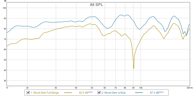

    Settings: High pass: 80hz, Low pass: 50hz, (both at 12db/octave) no smoothing, no EQ
    Since I have recently changed out gear and moved the speakers around, I re-ran some comparison tests to see what I'm doing with the movements and gear changes. My speakers are flatish to 30hz and have usable output to ~28hz. Pretty much full range to most people but there's a huge dip in the midbass region. Is it audible? Yes, I lose some of the kick drum slam and sense of heft in the region.
    Here comes in the sub to compensate. Even though the sub is set well below the 90hz dip (sub comes in at 50hz @ 12db/octave), it alleviates the dip there. Did the sub help? Sure thing. The sub also blends seemlessly into the speaker with a slight bump in the 50hz and 80hz region which is ~+/-5db which isn't very conspicuous to my ear.
    However the sub doesn't really affect much above 100-200hz where the speaker's woofers take over. So the can't really help in this department. FYI, the sub also helps resonances from the speakers and the waterfalls look much cleaner and there is less audible overhang so bass sounds much quicker on drums.
