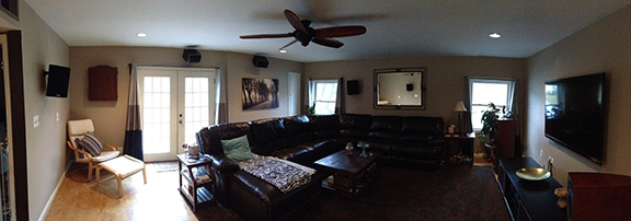

    I use a similar setup with RTi4s as rear surrounds.
    I ended up mounting my FXi's much lower than most (maybe about 6ft off the ground). I was also forced to put the RTis near the ceiling in a downfiring position. Just food for thought.
