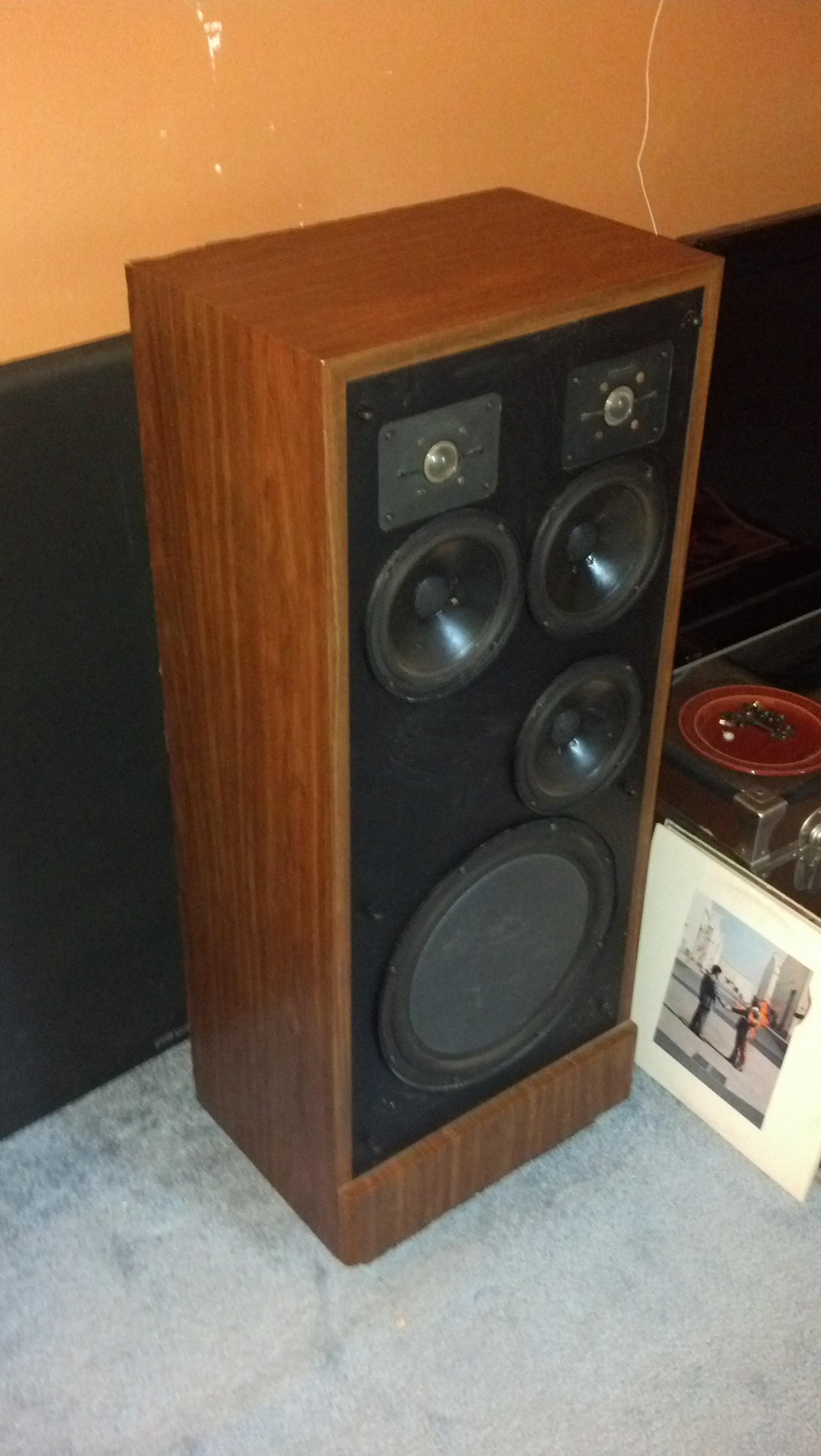

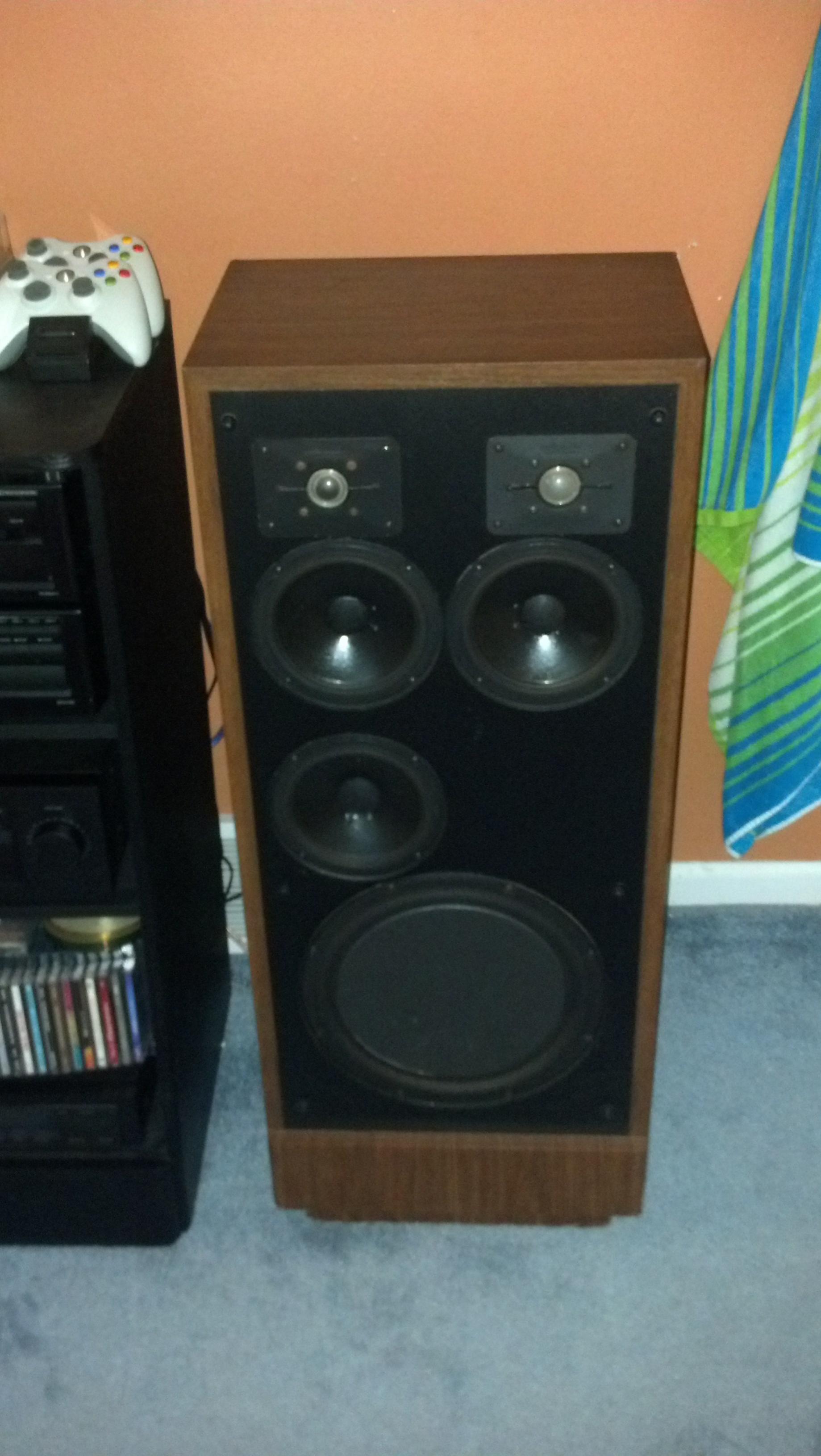

Hi I am new here, long time polk fan (dad has 11t's i have rt3's) and i just recently bought my dream speakers for 65 bucks a set of sda2's dated 1985. One cabinet appears to be fully working but the other, both tweeters are shot and I also need a sda cable. I am handy so working on them isn't a issue, was wondering how to make a sda cable (i know if its backwards it will do damage thinking of making one with xlr) and where to get sl2000 tweeters other then ebay.
Thanks!

    You can order RDO194 tweeters from Polk, these are a better replacement for the 2000's. Check the vintage forum for how to make a new cable, you will probably want to use new connectors on the speakers and the cable because I don't think the original style connectors are available anymore. Let Polk know you are a member of the forum for a discount.

    Sounds like you have the original 2's with 2 tweeters in each.I believe many have decided to bypass one of these tweeters now to get better sound.
    I'll let the experts chime in on this but you may find this as an option and will only need 2 working tweeters.

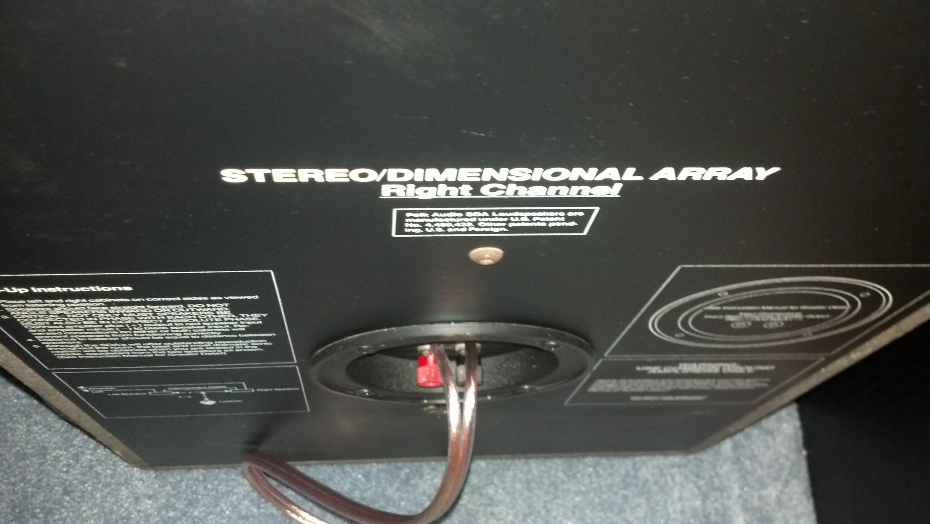

    Welcome to Club Polk. The original SDA 2s with two tweeters used a blade/blade connector. Polk may still have the replacement cable, however it's very easy to make your own using quality 12-14 gauge ofc speaker cable, and Speakon connectors. The sockets and plugs are available from Parts Express:
    Socket: http://www.parts-express.com/pe/showdetl.cfm?partnumber=092-059
    Plug: http://www.parts-express.com/pe/showdetl.cfm?partnumber=092-058
    These are far superior to the original blade/blade or pin/blade connectors and IC Cables.

    You would wire the cable large blade to large blade, small blade to small blade. There's no polarity reversal on the outside, that's done internally on the early series. I'd still recommend the Speakons over binding posts, they're fool-proof, will never disconnect accidentally, and you can change the wire gauge or length anytime you want.

    XLRs are old school, and subject to deterioration. They're good, but the Speakons are the best choice. $40.00 for Speakons? $20.00 max with shipping. Don't worry about crossing the wires, do one cabinet at a time. Decide ahead of time, small blade goes to #1 terminal, large blade goes to #2 terminal. On the plugs, just make sure the marked wire (there's always one that has some type of marking on it) goes tot he same #1 or #2 terminal on both plugs.
    On the Binding post cup, you'll have to enlarge the hole after you remove the blade/blade connector. The wire colors may be different from one cabinet to the other. I had one that had white/blue, while the other had white/black. Stick with what I said earlier. small blade wire to #1, large blade wire to #2. You'll do fine

    That's even easier to enlarge the hole then. The Speakon will take up to #8 or #10 wire If memory serves, so your #12 will be fine.
    you can solder the male spades on the socket, but I prefer to use 3/16" female spades. you can order a small bag when you order from Parts Express. The plugs are solderless
