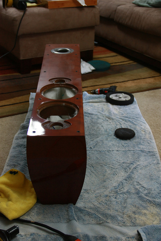

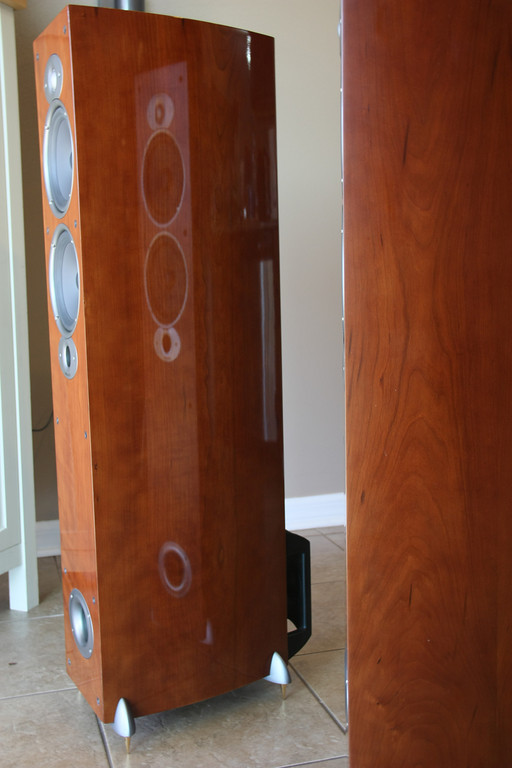

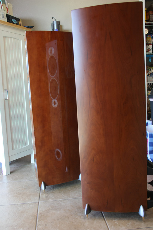

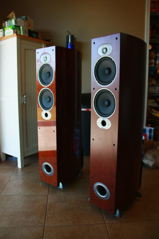

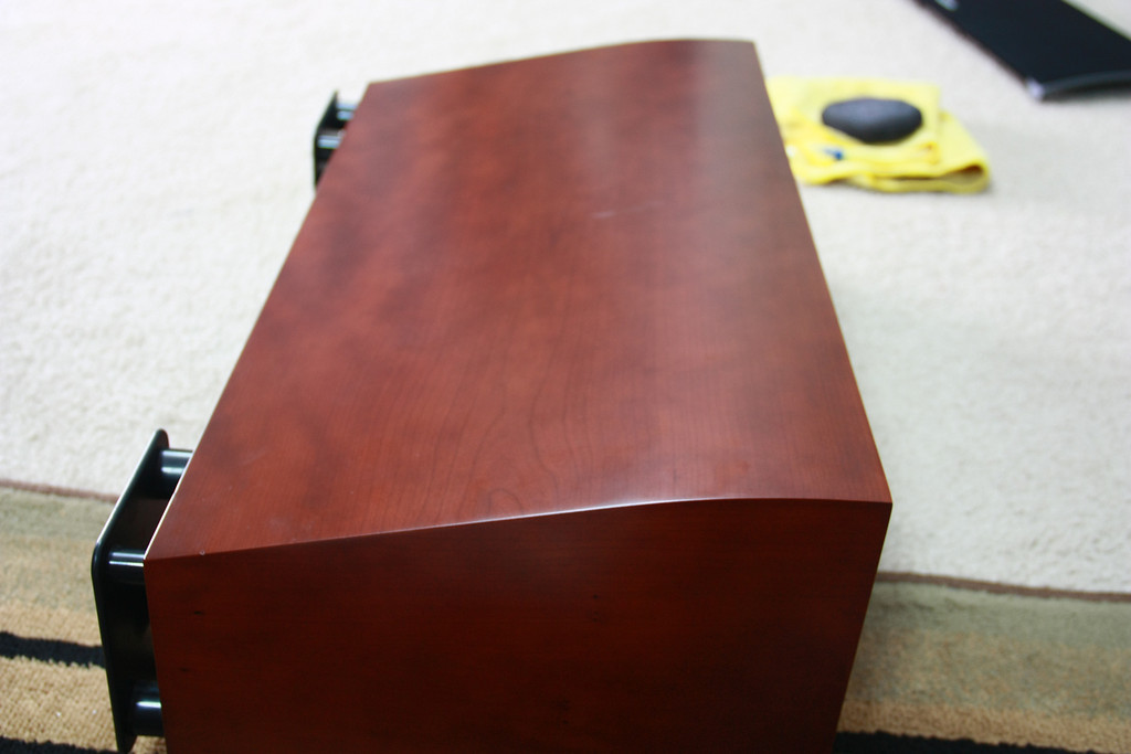

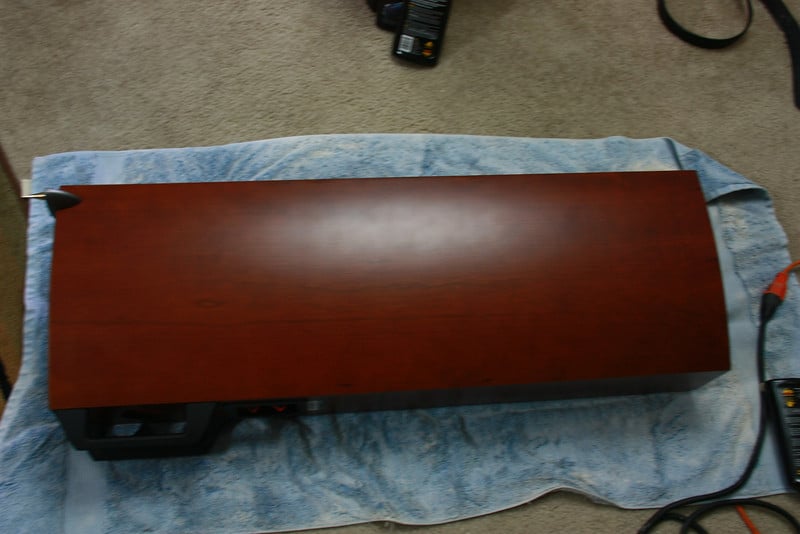

I always loved Piano finished cherry wood or rose wood speakers. But 90% of them are out of my price range. For the longest time I have been considering doing a lacquer finish over the original cherry stain. I was googling how to do it when I cam across a guy who greatly improved his Lsi7 just by hand polishing them with some automotive polishing compounds. I used paint and detail cars so I had the same compound he used as well as a random orbit polisher and a high speed buffer.
So I took this guys idea and went one step further. I tested it by flipping over my center channel, hit with the high speed buffer and the polished it out with the random orbit. I did a 3 step process vs his 1 step. It came out great. So I did the rest of my setup.
Before
After
In the process of
Side by side comparison of the difference
No Photoshop I swear, thats just the finish
It took about 5hrs to do. I already had the tools and materials so it cost me nothing. If anyone is interested in doing it let me know I can offer some assistance

    Yes I did wool with a light cutting polish on high speed buffer. Polishing compound on orbital with a light cut foam pad. Wax on orbital with a finishing pad.
    Teekay. No swirl marks. I wouldn't allow it lol. For a person not familiar with buffing I would not recommend using a high speed buffer. You can get a nice shine by hand or a better shine using a orbital polisher . if you go by hand or by orbital u can't really do any damage.
    Well, that would have been a complete waste because there is a clear coat finish over the cherry stain already. That finish has a flat sheen and to obtain a flat sheen flatting agents are added to standard gloss clear coats. The amount of flatting agents added determines the final sheen. The problem with a flat sheen is when it gets rubbed the sheen is no longer flat. Rub a flat sheen enough and it becomes a satin to semi-gloss sheen. I see this all the time and a lot with dining room tables where the areas that people have their arms on the table top become shinier than the rest of the table. I advise my customers that while I can apply a new flat sheen clear coat on top of the exsisting finish the same thing will occur. I advise them that they are better off having me rub out the flat sheen to a stain or semi-gloss or if they wish I can use polishing agents to get a gloss sheen, which is what you have done here. The downside to a gloss sheen is it shows dust like crazy and any scratches really stand out. Satin is the best choice of sheens, IMO.
    3 step process I'm assuming you used. Cut polish and wax.
    In this case there would be no need to cut or use rubbing compound as the finish is already smooth. Just proceed straight to using polishing agents. There would be no need to wax either. 99% of the time wax is a complete waste of time and money. As long as the clear coat finish is in good conditon it needs nothing applied to it.
    What about a cleaning Polish? What is some Oxidation has occurred over the years , maybe some sunlight hitting the one side of the speaker? I would think some kind of light compound or a polish with cleaners would help remove the sun staining?
    Waxing I thought would help protect the finish after it's been prepped and polished. In the automotive field , I use to detail cars and ran detail shops. I know Automotive paint is very different then finishes on wood but I would assume some of the technic's used to clean and protect the finish would be the same.
    I'm assuming your in the wood finishing or making business?
    Dan
  • specd_out
    specd_out Posts: 505
    edited January 2013
    Ok well that explains a lot. I had no idea that it was clear coated. I was in disbelief when I polished it up and it shined. I figured there was a protective lacquer that was dull. I have painted a few flat semi and gloss clears in the past. I never thought that it would be used on wood.
    The "cutting" polish I used was just a mequiers polish that uses the polymers that react with the heat from buffing to become abrasive. Its doesnt have any grit. Just slightly more aggressive then the polish. Wool pad definitely help speed up the process.
    It's BIG business and completely unnecessary. Fine to use for cleaning if one must use something, but it does nothing to "help" a finish, nor can it moisturize the wood or any of the other stuff they say. All that is needed is a damp cloth to remove the dust....done.
    What i[f] some Oxidation has occurred over the years , maybe some sunlight hitting the one side of the speaker?
    You can't stop or fix oxidation, it will happen no matter what. You can apply a liquid polish that will help hide the issue until the polish evaporates. Since wax doesn't evaporate it will hide the issue longer. Neither wax or polish protect against oxidation, solvents, sunlight, heat or water. If sunlight has caused actual damage to the clear coat, it's time to restore the finish (depending on the finish) or refinish the item.
    Sunlight doesn't stain, it bleaches. Once the color is gone, it's gone. There are tricks to restore the color, but nothing you can buy off the shelf.
    Wax only protects in the sense that it reduces friction and therefore objects tend to slide rather than grab or dig in. Wax does nothing to "help" the finish.
    Same in the sense that the wax reduces friction and therefore objects tend to slide rather than grab or dig in. Wax does nothing to "help" the finish.
    I restore/conserve/refinish antique furniture as well as do work on newer furntiure. I am not a cabinetmaker.
    F1nut Posts: 51,786
    edited January 2013
    Roger that. I got in the habit of using 3M products, but know some others that use Meguiars.
    I started with 3m but dare I say it, I felt that 3m didnt have some of the latest tech in polishes. I found I could get better finished product quicker and easier with Meguiars and I was able to use it on fresh paint. But thats in the automotive field.
    Heat activated abrasives are a god send when working on fresh paint
    I use 3m wet/dry sand paper

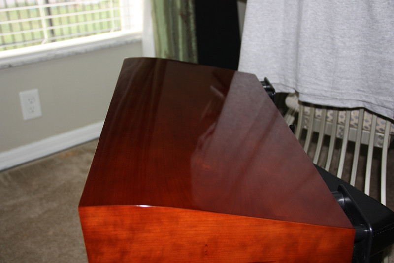

    Took a few better shots with my accent lighting.
    the wood has so much vibrance to it now.
