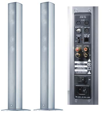

    Repairs on active speakers are certainly a concern, and something to consider as I continue to consider active speakers for my set-up.
    There aren't too many powered speakers options out there, but some of the offerings are interesting...

  • zingo

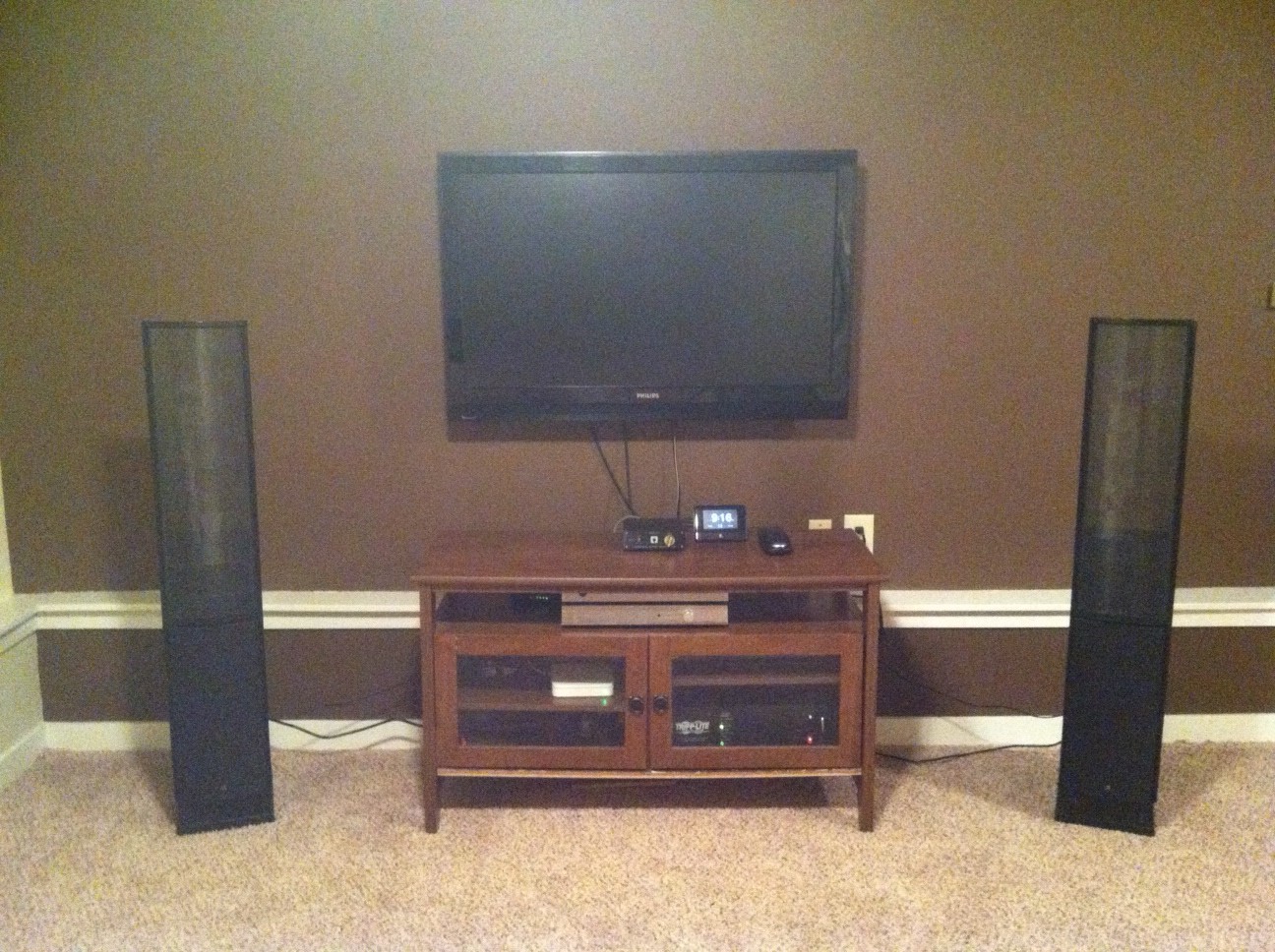

    Decided to put my money where my mouth is and try a pair of fully powered speakers...
    Wow! Those are the ones I have been wanting to try. How do they sound?
  • zingo
    zingo Posts: 11,258
    edited January 2013
    Powered subwoofers KellyMic are one thing, but these are completely active speakers that use a 200wpc B&O ICEpower amp to power the panel and woofers in each speaker. Plug the speakers in (which you would have to do anyway), run RCA cables from your preamp, and press play. They easy factor is off the chart as they simply go into standby when they have no signal.
    The sound quality is at least as good as compareable sized electrostatics, plus a little better synergy since the monoblocks are hardwired inside. The bass is great too as it uses two 6.5" woofers which blends much better with than the larger woofers, and still has good output.

    They are the Purity. I obviously got them used as they have been discontinued, but this pair was built in 2010 and not purchased u til 6 months ago, so I'm happy. The only thing they didn't come with was the spikes, but those will be easy enough to get.

    zingo wrote: »
    Technically these are powered not fully active since the crossover is done at speaker level not line level,and only a single ch of amplification.

    Fair enough. You are right as they have the amp module mounted to the floor of the speaker cabinet which feets a standard, passive two-way crossover, which feeds the drivers.
