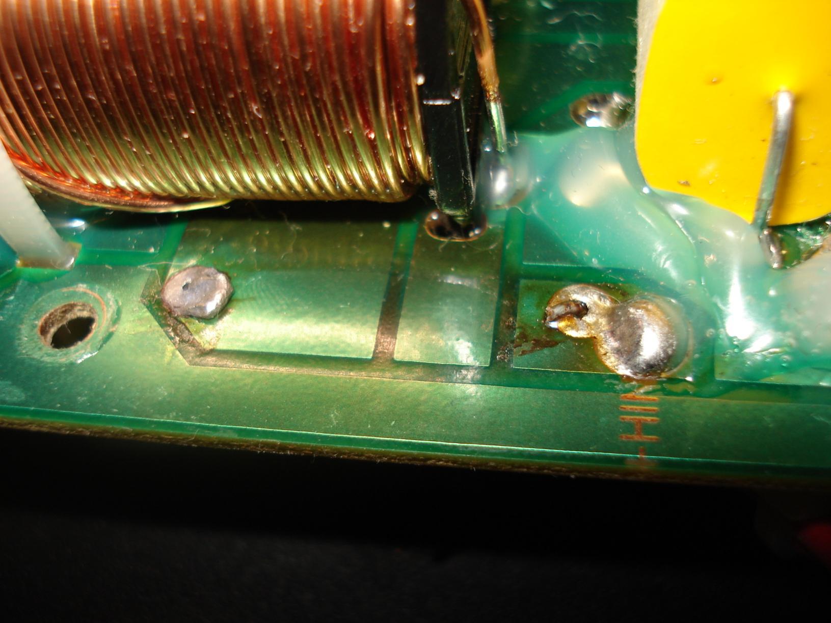

What I found interesting is the lack of solder on one post and the other a very poor connection. I have no idea if this could be the cause, but certainly does not look as though it would help matters any. Seeing this level of quality was also disappointing!

    If you can solder, it's easy to replace the resistors yourself and get them running again. Here's the LSi15's schematic: http://www.polkaudio.com/forums/attachment.php?attachmentid=18678&d=1155780535
    Here's a link to the resistors you need(purchase 2): http://www.parts-express.com/pe/showdetl.cfm?partnumber=005-2
    The newer resistors are more durable, but you need to find the cause of your problem. What are you powering them with?

    If your serious about getting them up and running, I'd just send the crossovers to VR3 and have him redo them for you. In addition, I wouldn't redo the crossovers until you dedicate an amplifier of decent quality to power them. No sense burning them up again if you use a receiver to power them.....if thats indeed the case.

    I thought of doing that, but there is really nothing to solder to. It is pretty much burned right through, just a thin crust of black.
    The next component in the chain. See the schematic.
