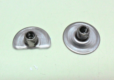

    I just finished installing h-nuts in my 2Bs. I installed the h-nuts in the holes for the tweeters and the binding posts.
    When I installed h-nuts in my 10Bs I didn't like the looks of the edge of the h-nut flange hanging out in the holes where the drivers go in. This time I removed the side of the flange so they don't hang over the inside edge of the holes. It takes a little more time but it makes a much better looking job. Does anyone else do that?
    I know Larry's rings would be a better solution but I'm on a tight budget and I have lots of time on my hands.

    TennMan I also cut down the flange on some of the h-nuts I installed on my SRS 2s but it was out of necessity and not cosmetic reasons. The SRS 2s have a cabinet brace immediately below the bottom mws. I could not get the h-nuts to install in the proper position without grinding down the buttom portion of the h-nut flange as you show in your pic. On the plus side this keeps the h-nuts from spinning.
    I'm sure this has already been covered many times but something I found helpful to properly seating the h-nuts was to put a little super-glue on the OD of the threaded portion and the flange. I would put the h-hunt in position and then use the screws and a flat washer to pull the h-nuts into the cabinet by tightening the screw. I have never had a problem with the h-nuts coming loose when installed in this manner.
    F1nut Posts: 51,776
    edited April 2013
    That is exactly how they should be installed.
