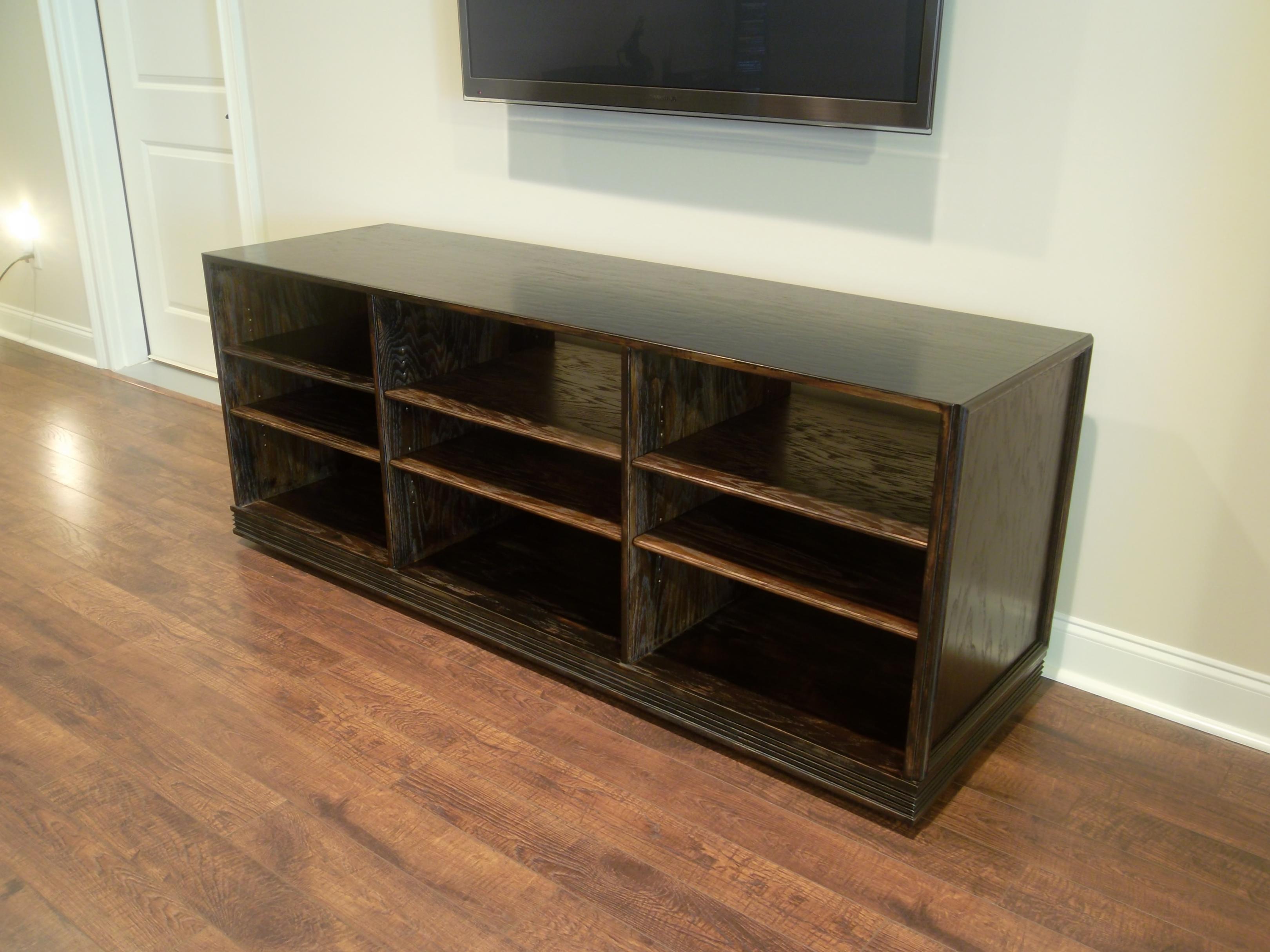

In my case I built my own A/V Console. Have a look:
Thats a cool looking console. I'm not that good with woodworking so i'll buy one and scrap the plans of building into my wall. -
Thanks. But to be honest with you that was my first project! I can share a link with a lot of information about others building their own AV consoles. Let me know.
