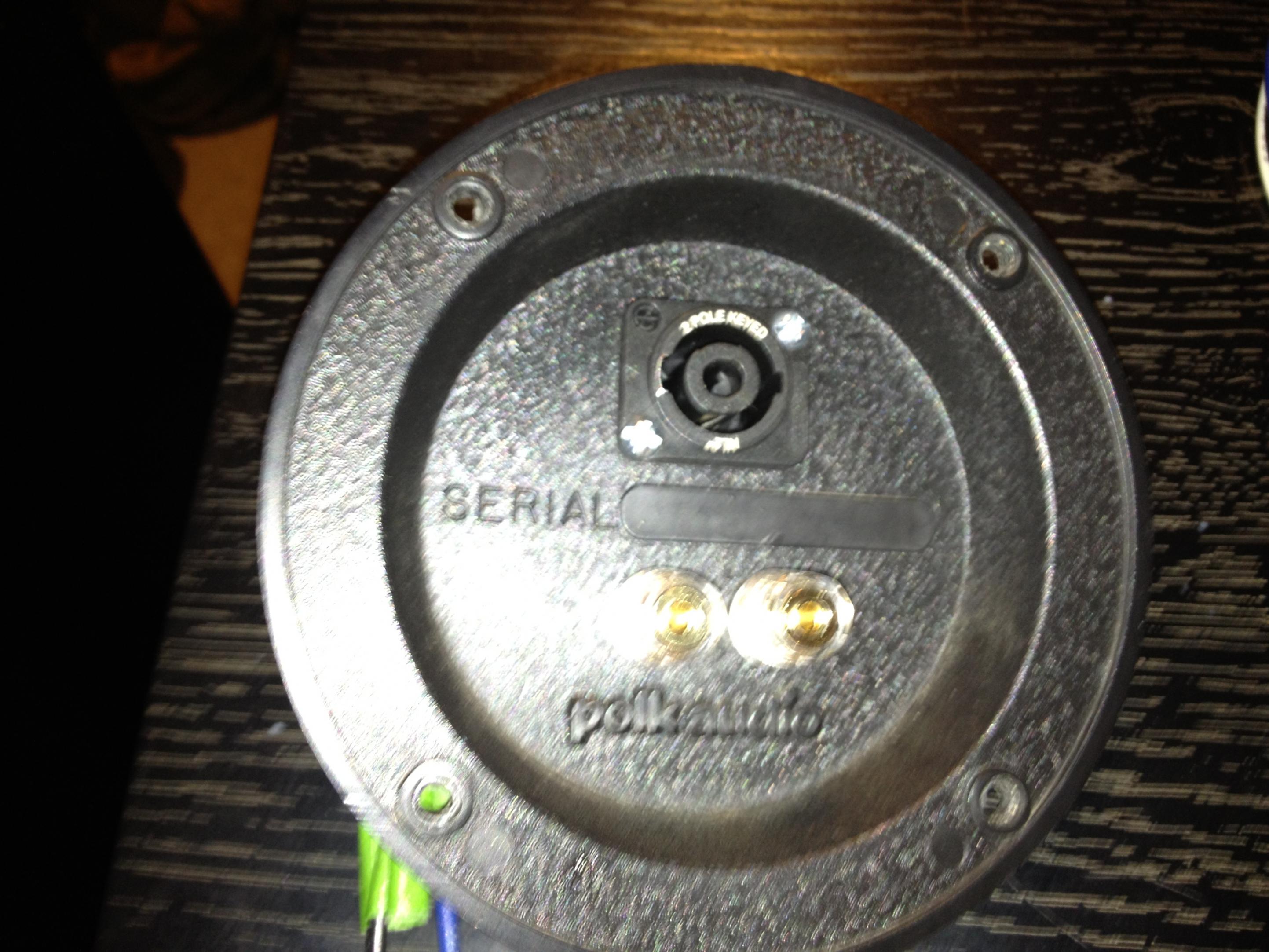

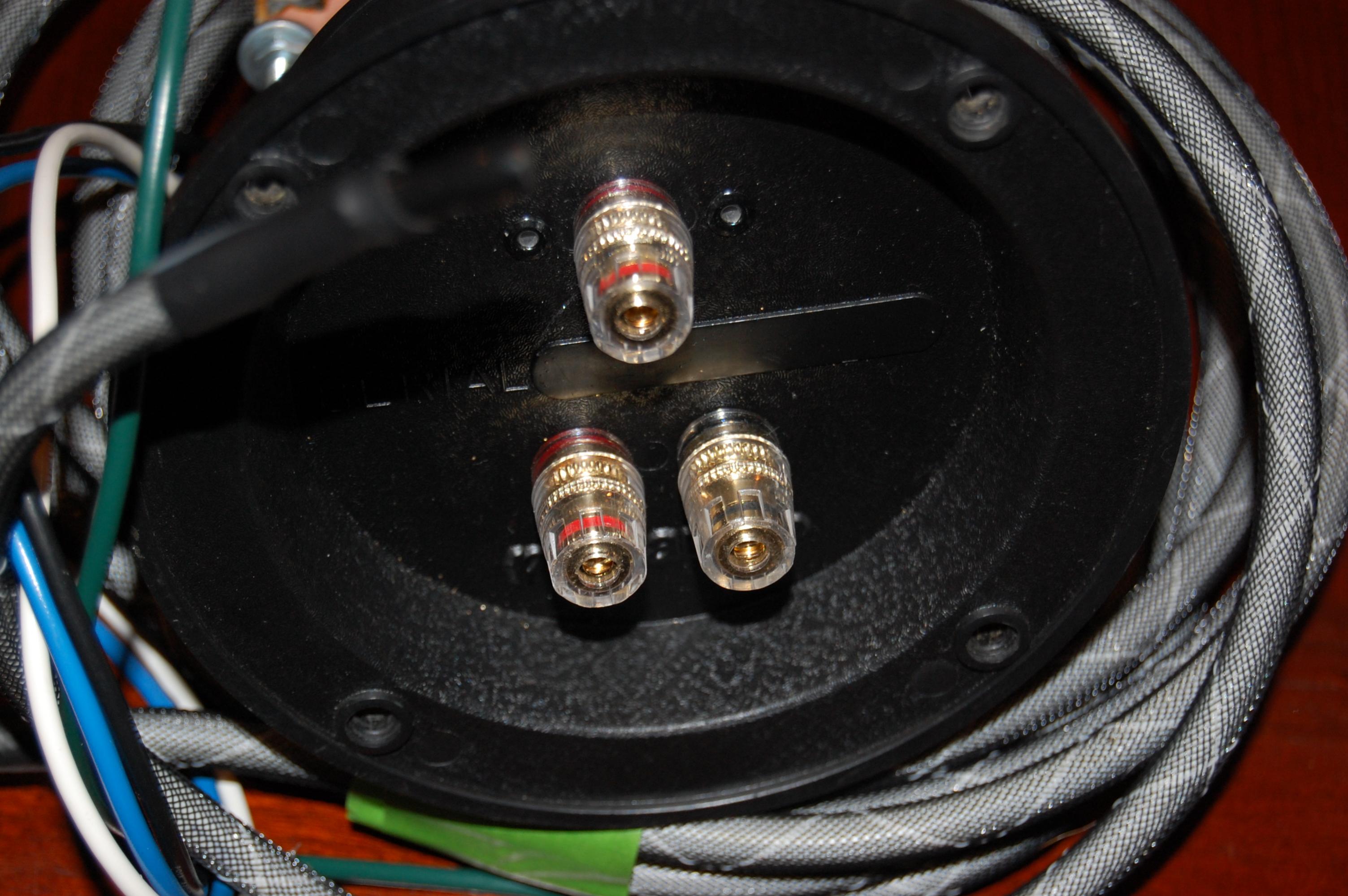

Replacing the SDA blade blade jack with a binding post as it is supposed to be a P/B...

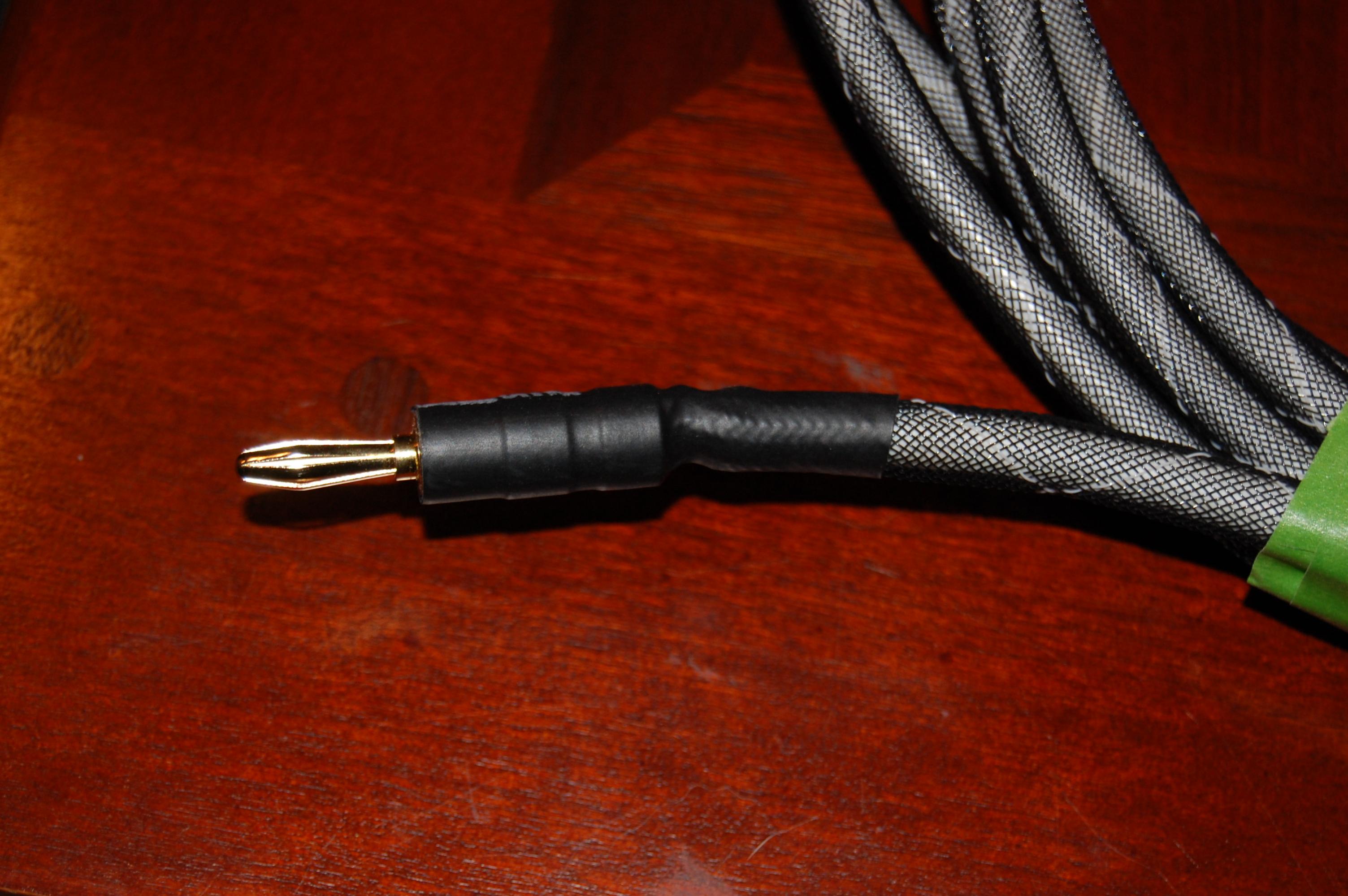

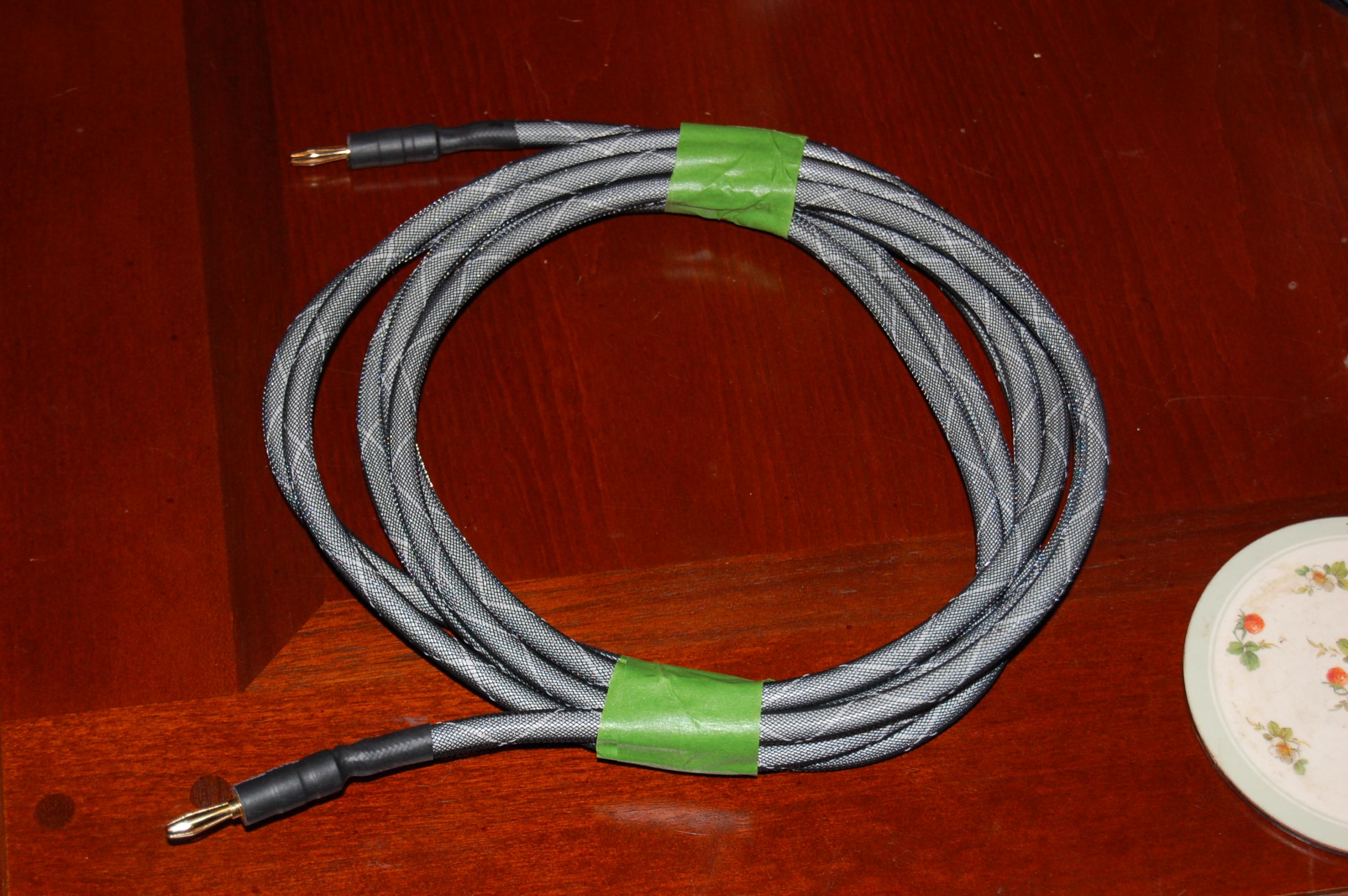

Building up a nice dual 14 awg run cable for the SDA cable - binding post...

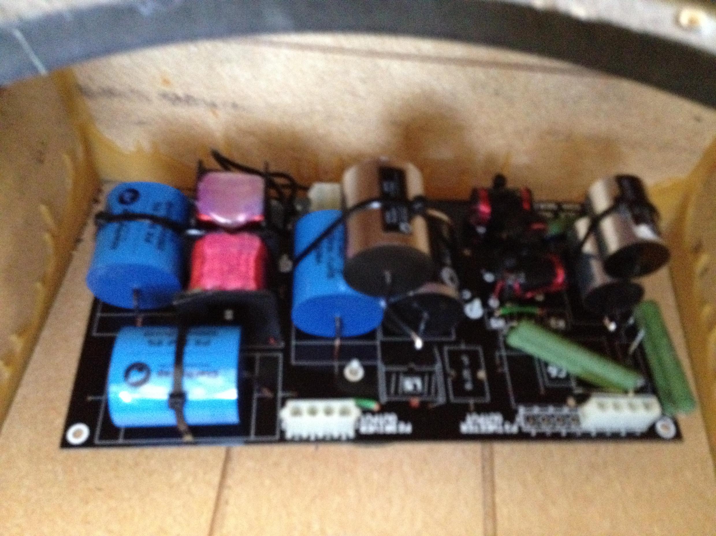

Clarity Cap ESA on the tweeter network and PX on the midbass and SDA board...
Mundorf 10 watt resistors - also am doing my "Power Stack'' on the main board so the tweeter caps will have their own board and the resistors will have their own - allows for easy maintenance and a cleaner install!

Two boards DONE
Note to other owners, check your inductor leads as they become fairly brittle with age...

The tweeter board is gonna look purdy!- Not Tom ::::::: Any system can play Diana Krall. Only the best can play Limp Bizkit. -
Resistor layout- Not Tom ::::::: Any system can play Diana Krall. Only the best can play Limp Bizkit.

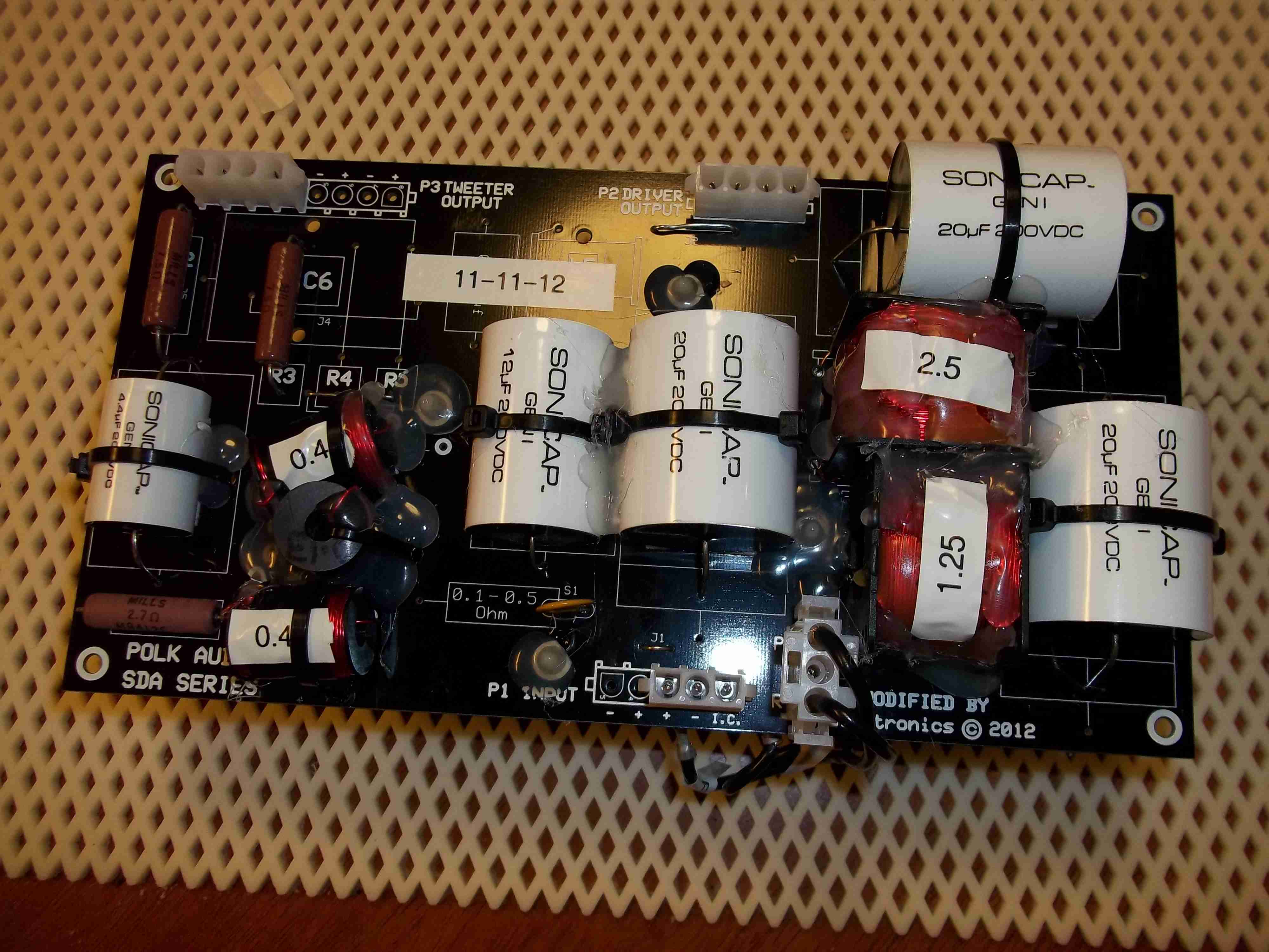

One set of crossovers are DONE...
Gotta do one more (tweeter caps and power stack) + a new SDA cable

That looks awesome! That one Cap is huge!
What is the cable going between the crossovers?

That is the cable that goes from your new SDA connection! :-D
I figured I would use the same cable I am using for your SDA cable

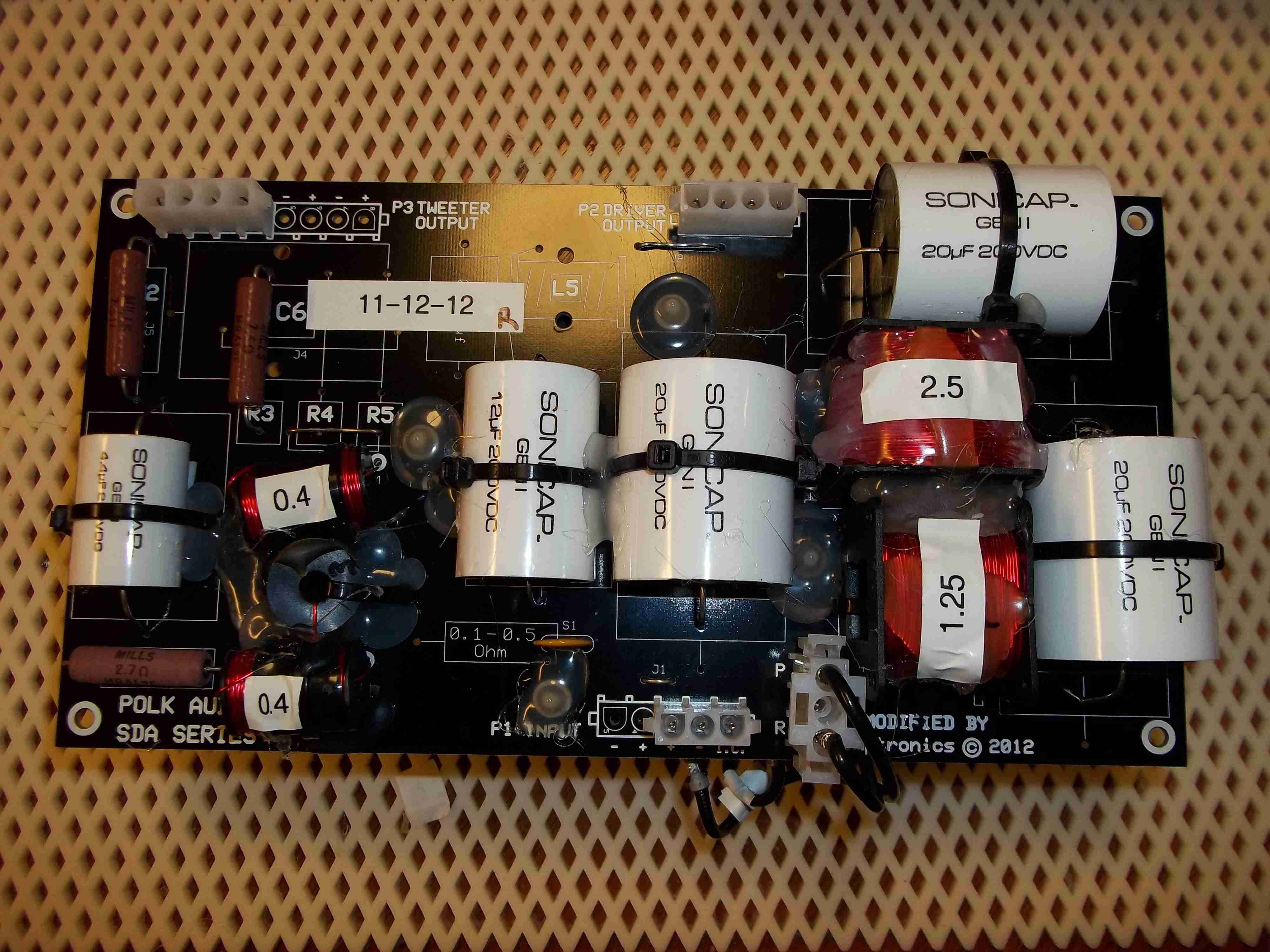

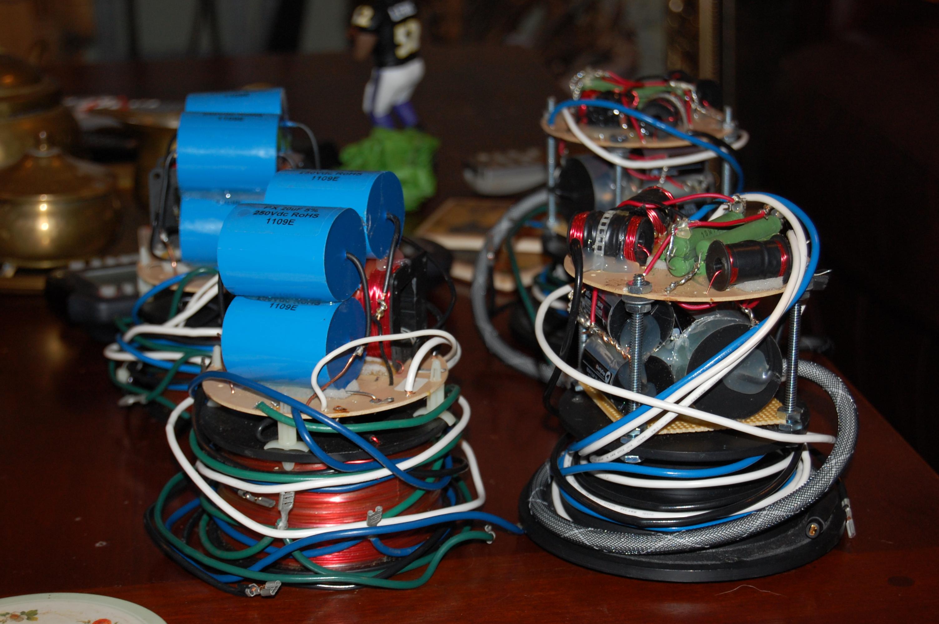

Received the finished product from Trey today. Packed well and they look great. Pics to come. Now to figure out where all these wires go. Ahhhhhh..
I am pretty sure I have the wires figured out for top crossovers to the mids. But the bottom crossovers to the tweets are slightly confusing.
The left crossover has Blue, Black, White and Green wires. The Right crossover has Blue, Black and White x2 wires. Hmmmmm????????????I got static in my head
The reflected sound of everything -
I spoke to Trey ( he even provides phone support ) and I think I have it figured out. It seems I may have had the tweets wired wrong previously. :redface:
Unfortunately the wife is asleep and I can't really give these a good listen. However, I can tell right off the bat that they are more efficient now.
Might have to go into work late tomorrow!I got static in my head

I think I have the wiring figured out. Cause it sounds damn good!!

First thing I noticed was improved vocals with more clarity and detail. With only 2hrs of burn on the Caps I am pretty happy. I am really looking forward to more listening and any improvement as time goes on will be a bonus!!
Trey does excellent work and does it quick! Do not hesitate to send him your crossovers.I got static in my head

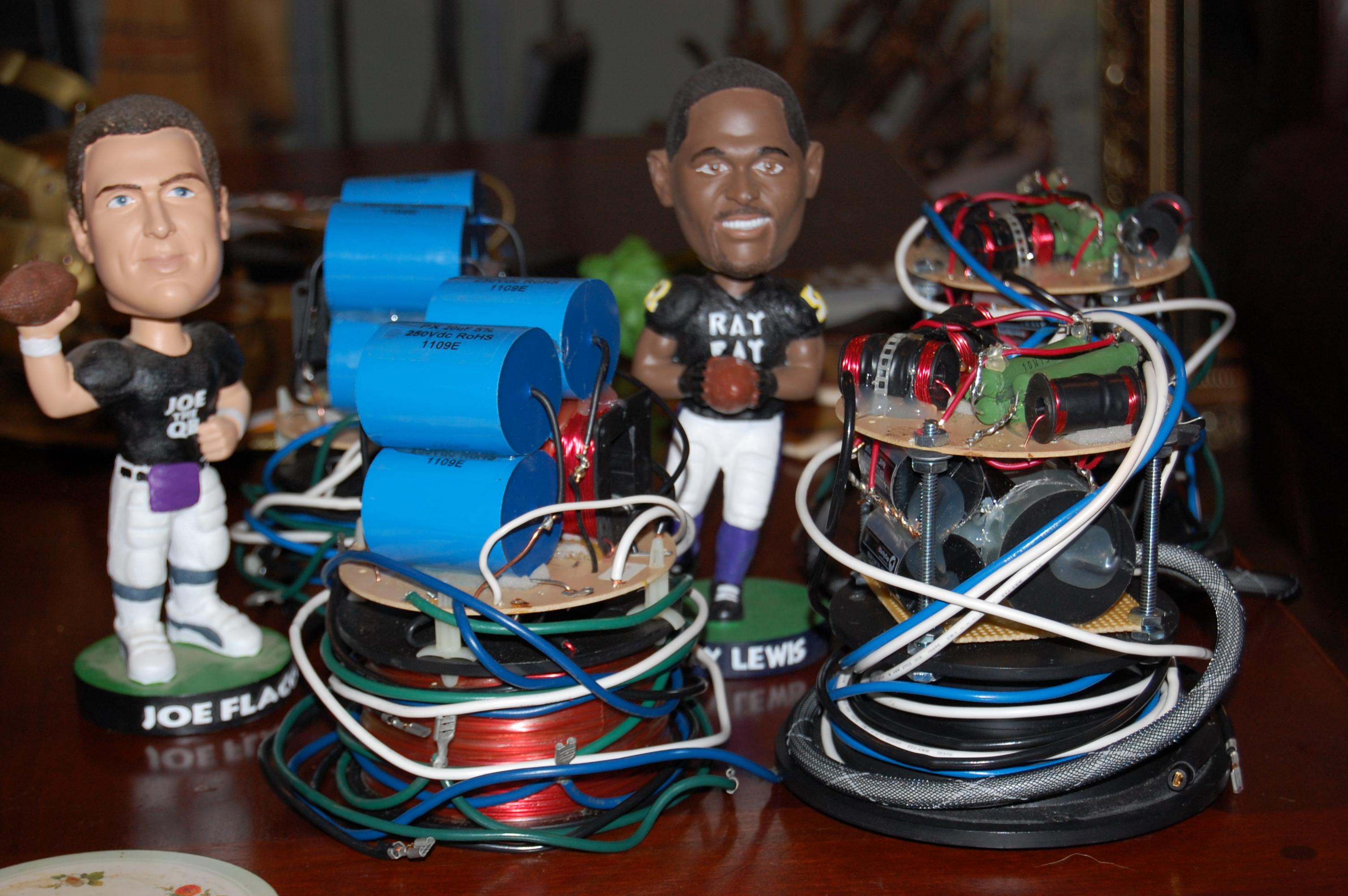

Stock inductors
Upgraded binding post
Speak On SDA cable and SUPRA RONDO SDA interconnect cable
