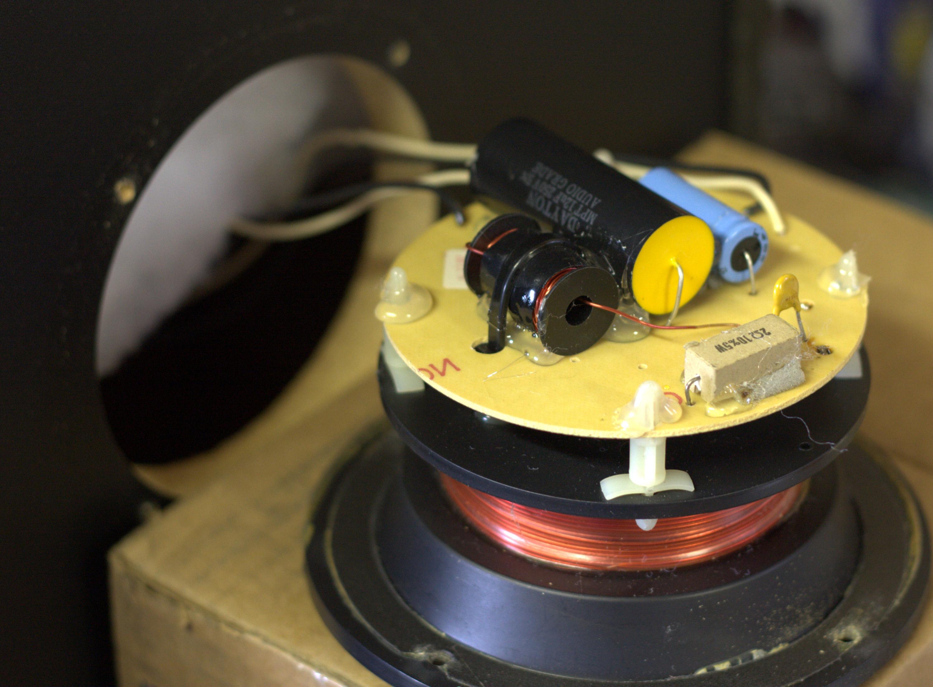

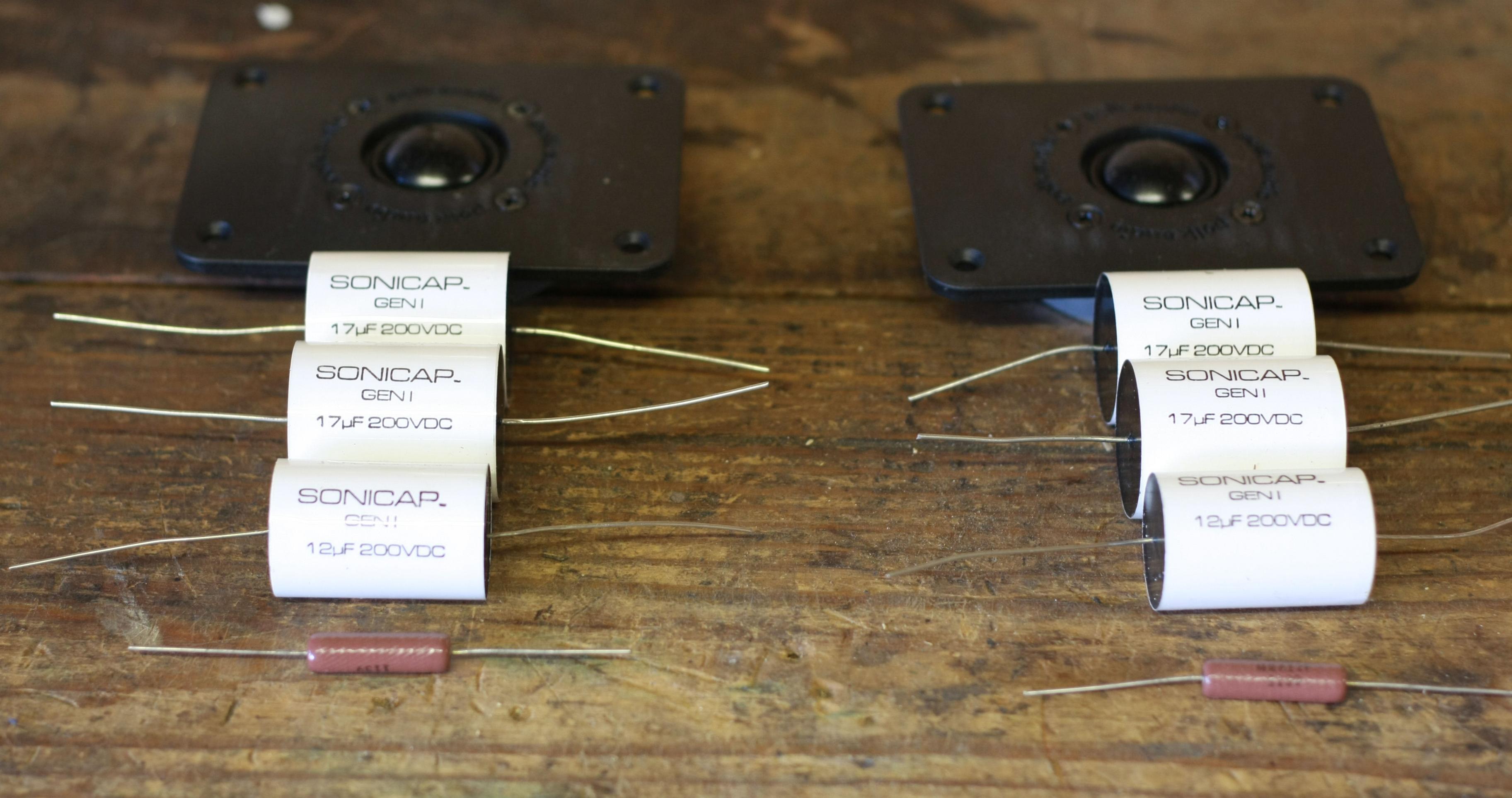

Hey all,
purchased some m 7c's locally and ordered rdo 194's and placed an order to sonic craft. Parts include: 2-2.2 ohm mills. 2-12 mf and 4-17mf sonic caps
Pulled the polly's and replaced with jumpers. Original high pass had 2 ohm resistor and polly switch. I jumped the polly and instead of adding a .5 ohm, I increased the 2 ohm to a 2.2 ohm. The seller had made an attempt to upgrade the speakers before I purchased them. However, they were too dull to my liking and lacked sparkle and detail. It will take 48 hrs to burn in the tweeters and a total of at least 100 hrs to burn in xo. I will let you all know. I will leave them on for one week.

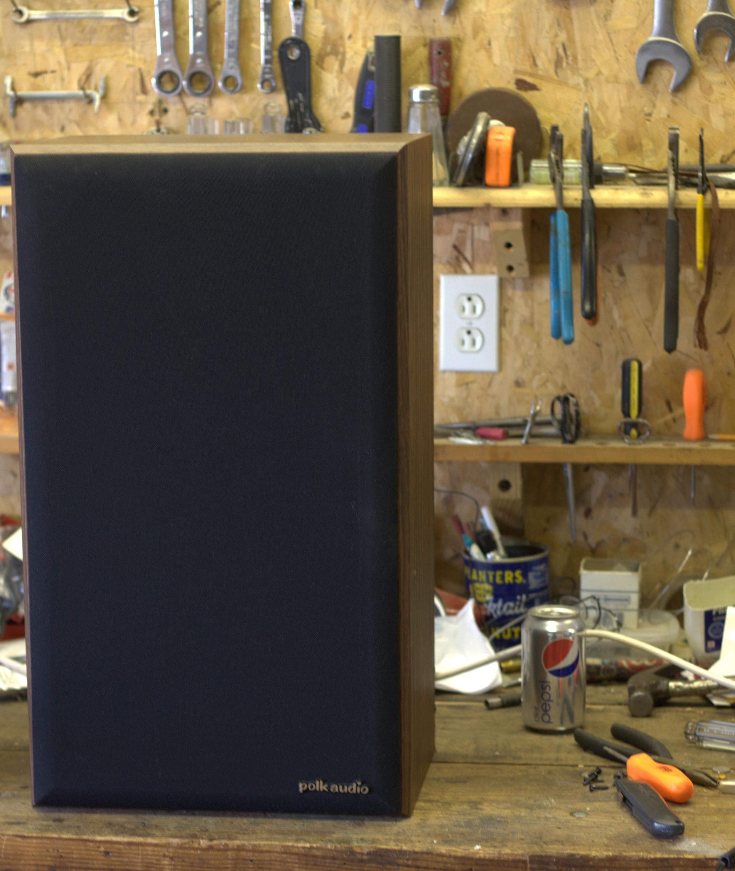

    Day 6 of running fm stereo signal through the xo's. I found out this was a very rewarding investment. They definately opened up (possible due to the pollys removel) more, however no more brash sounding highs. More clarity and sonics, the bass seems tighter.

    Was interesting you made that observation... I purposely wired the speakers out of phase and threw like 3 blankets to dampen the sound of the highs. To my surprise, two days into the burn in... I took a peek inside and found out it was too warm in there! (no damage... Magnet slippage etc. etc.) I then replaced with only 1 blanket!
    It is now 8 days into burn in. They are a part of my garage rig now.
    Day 8 and now in correct phase:
    The highs are crisper and in much richer detail as in before. It makes the transition between the two much more seemless.
    The lows (mid woofer) moves air as with the electrolytic cap. But now has a much tighter response and as aforementioned on the highs, has more accurate detailed bass. Not "boomy" or "flabby" as before upgrade.
    I do agree much more burn in time is needed as with any upgrade.
    Final conclusion: If you have a pair of 7's around...invest about $268.00 in rdo's and sonicaps and mills, You will be impressed enough to put 25+ year old speakers up againts side by side in todays generation of speakers with similar specs. IMHO This upgrade in no way is suptle. This was a fun project, thanks for looking.
