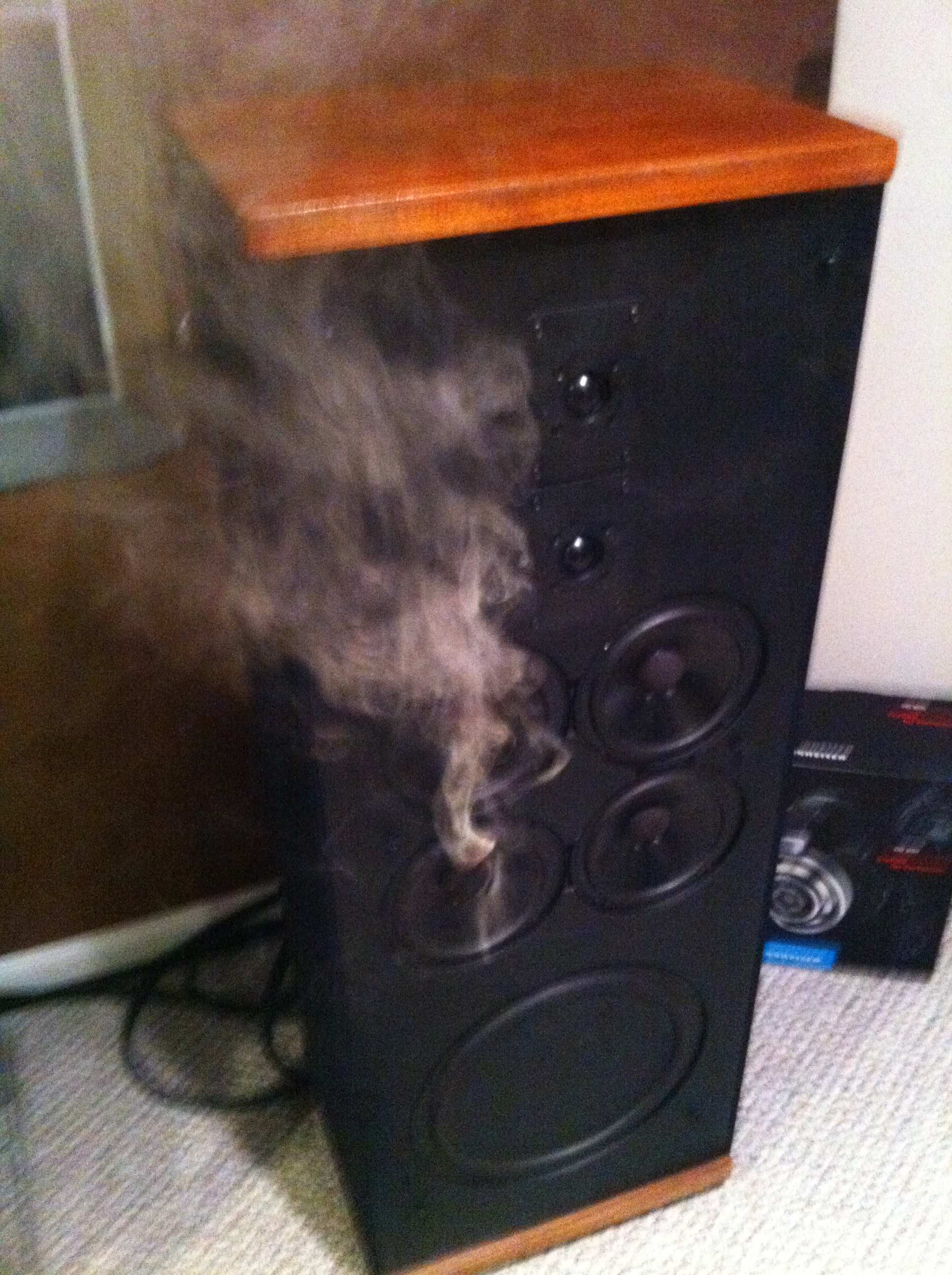

I just fried one of my 1C's. Like literally, smoke. See pic...
nspindel
nspindel Posts: 5,343
edited November 2011 in 2 Channel Audio
I'm no electrical engineer, but I think this is bad. Very very bad.
I made the mistake of powering up my amp before I turned on the tube preamp. When I switched the preamp from headphones to line output, there was a pop noise, and then....
I'm pretty sure all four drivers are fried. One is literally burnt to a crisp, the other ones are not moving in and out well.
Can someone help me out with the steps to diagnose exactly what I fried here? How can I test out the crossovers? And the tweeters?
Damn. This ain't good...

    The smoke looks to be from the voicecoils ,I suspect they protested so loudly because they recieved a large spike of DC.Get your credit card ready.

    My guess is that when he switch on his preamp it sent a DC voltage spike that the amp then sent to the woofers voicecoils,which if high enough in level will destroy them.Being a tube pre it will have DC blocking coupling caps at it's output but if they had insufficient time to charge fully(such as at turn on) or leaky ,DC can be passed to the amp.For this scenario to happen the amp would need to be a directly coupled design,I'm assuming it is.

    More good news, as good news goes here. Took everything apart, the tweeters have a dcr of 6.4 ohms each, and I can't find any evidence of burn marks on any of the Sonicaps, and meter readings don't show any shorts, resistors measure ok, etc. Drivers, different story. Three out of the four read dead on my meter, and the fourth is quite seized up even though it still shows a meter reading.
    So I'm going to look at the bright side here. First of all, I've been procrastinating pulling these apart anyway to do the mortite, jb weld, dynamat, and rings. Well, now one of them is already pulled apart. Also, it looks like I only need to replace the four drivers, and I'm fortunate enough to have a complete set of spares on hand.
    So I guess it's time to further mod my 1C's!

    The caps in series with the tweets saved them,the woofers have no such line of defense.

    Before using the amp and preamp again I would be putting a meter on their respective outputs to verify that there is not an excessive amount of DC offset present.(ie less than 50mv.)
