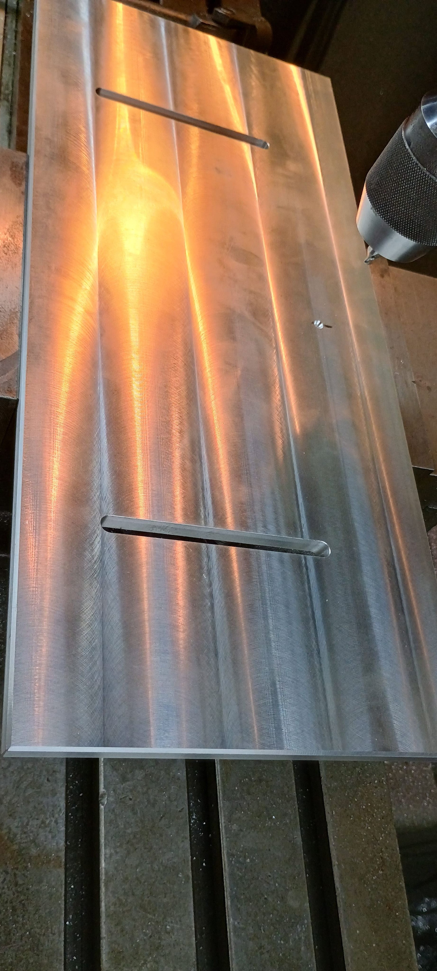

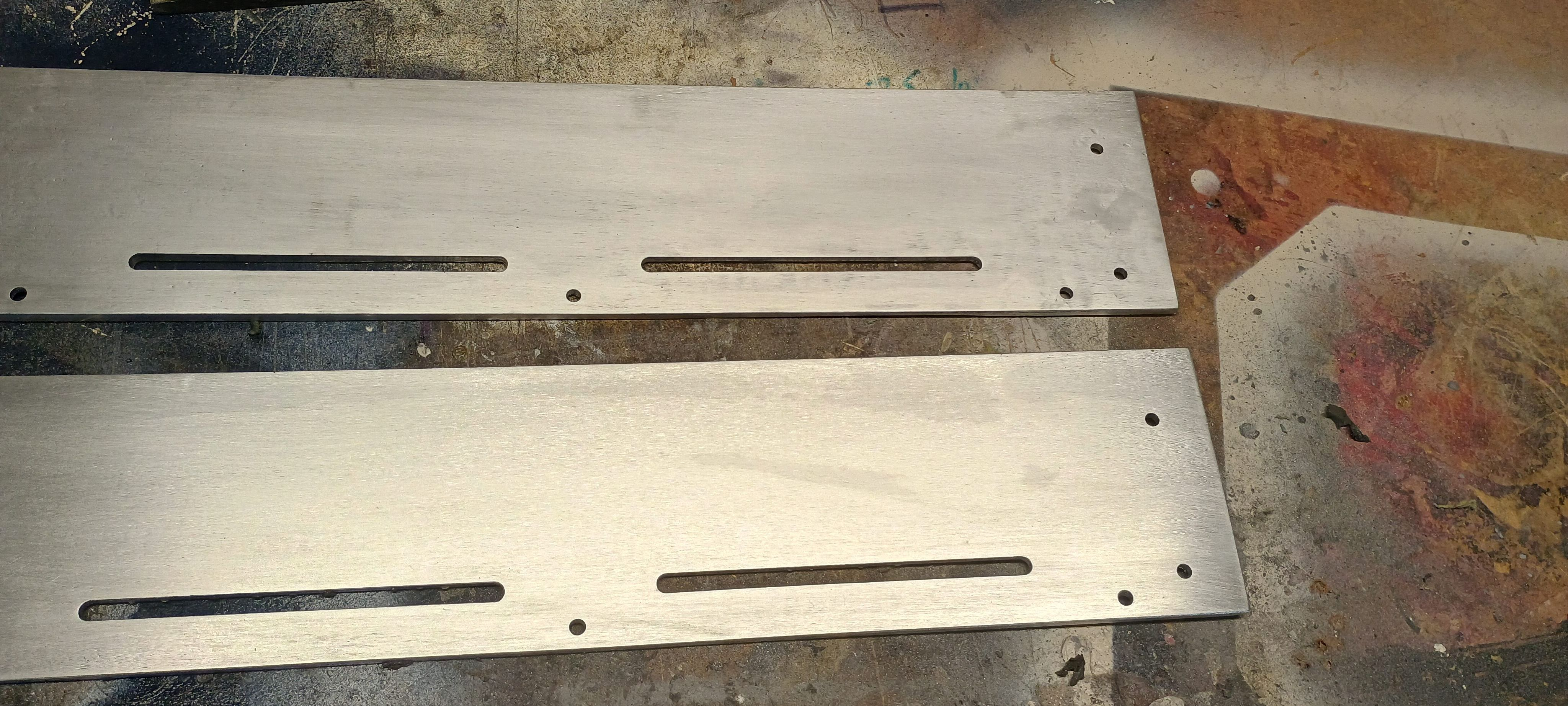

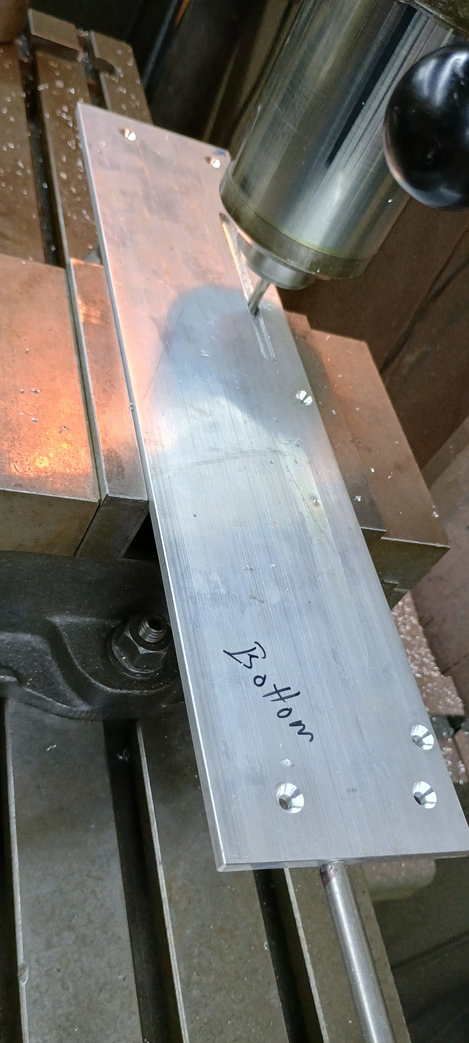

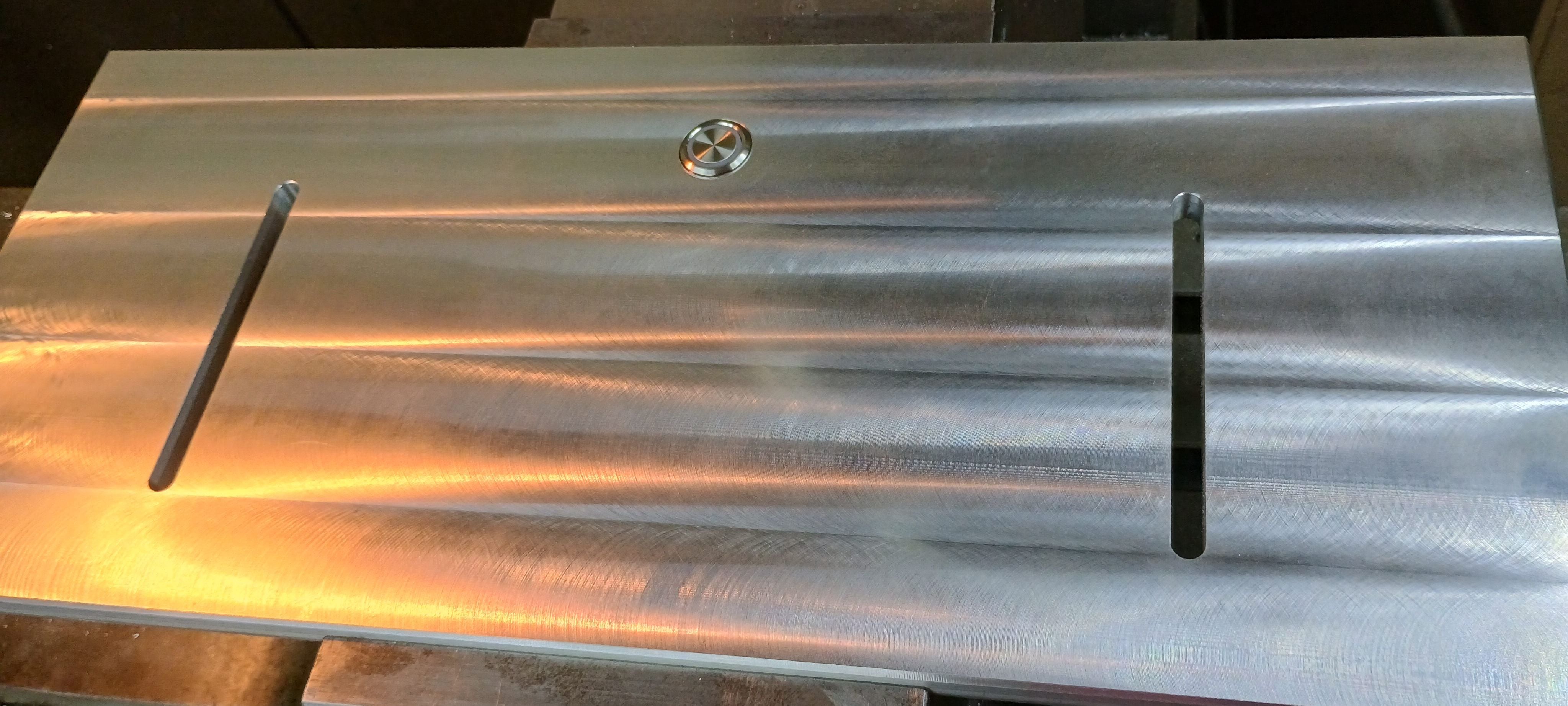

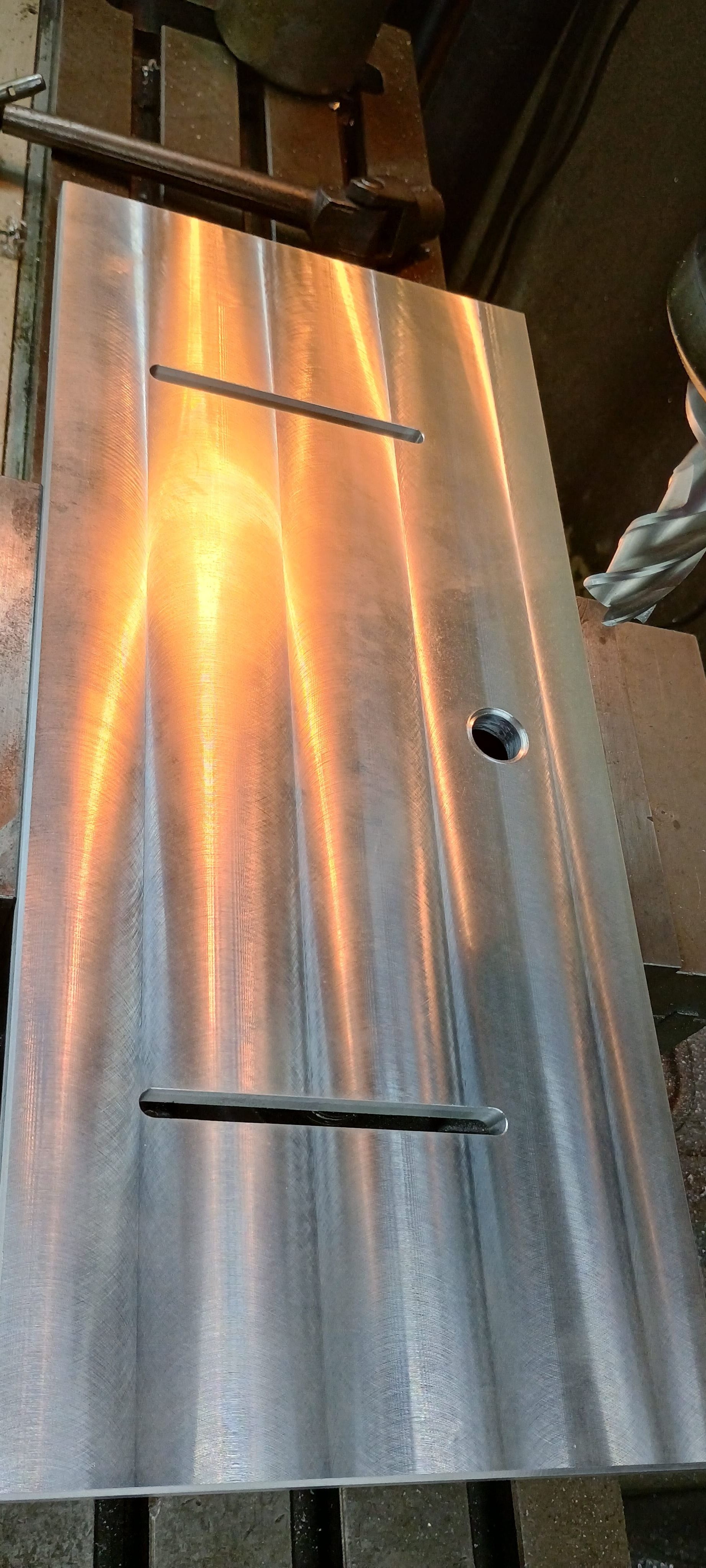

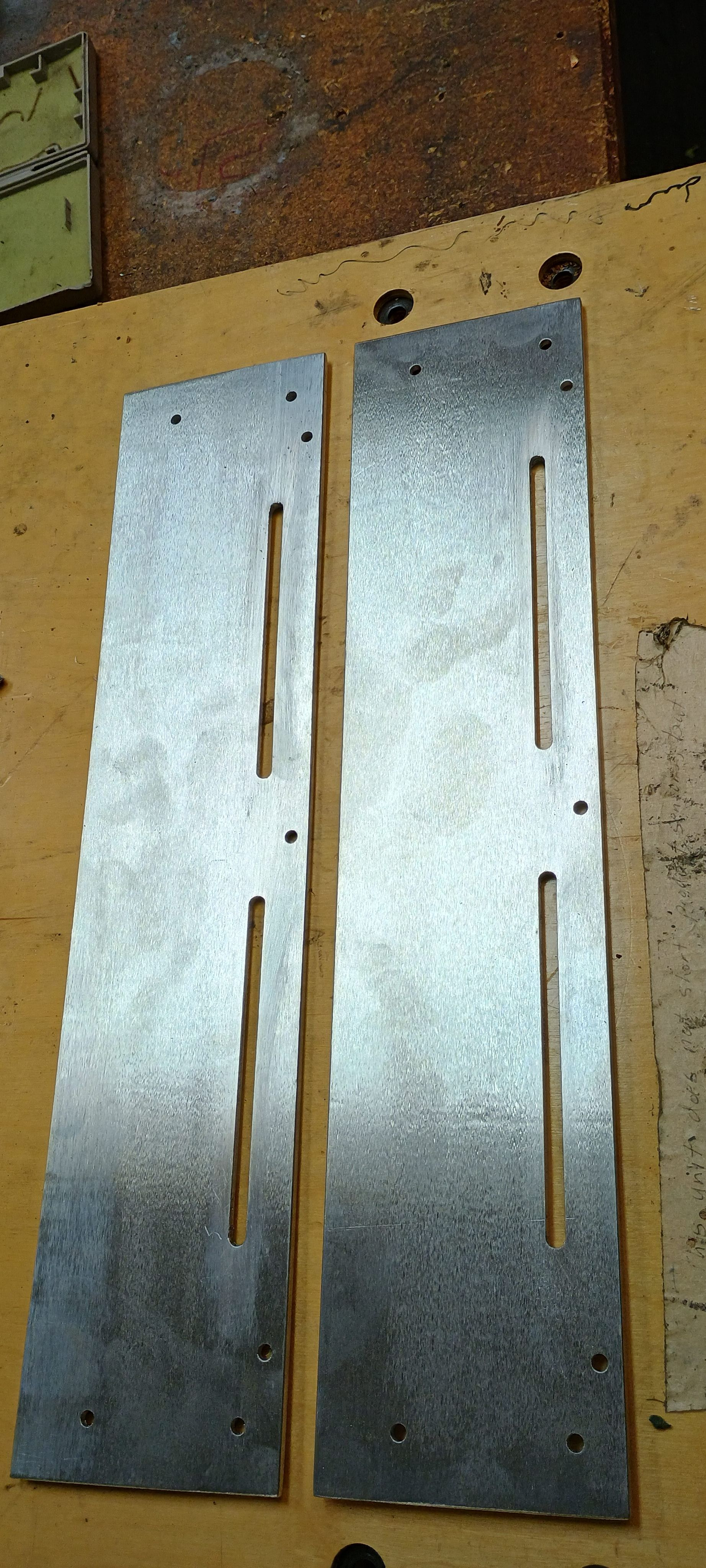

    Fly cutting the long thin covers caused to much heat and started to warp. Decided to put on large upright belt sander 120 grit and cleaned them up. Will finalize at 320 grit hand belt sander to contrast with the flycut faceplate...
    xschop Posts: 5,836
    240 wet sand....
    xschop Posts: 5,836

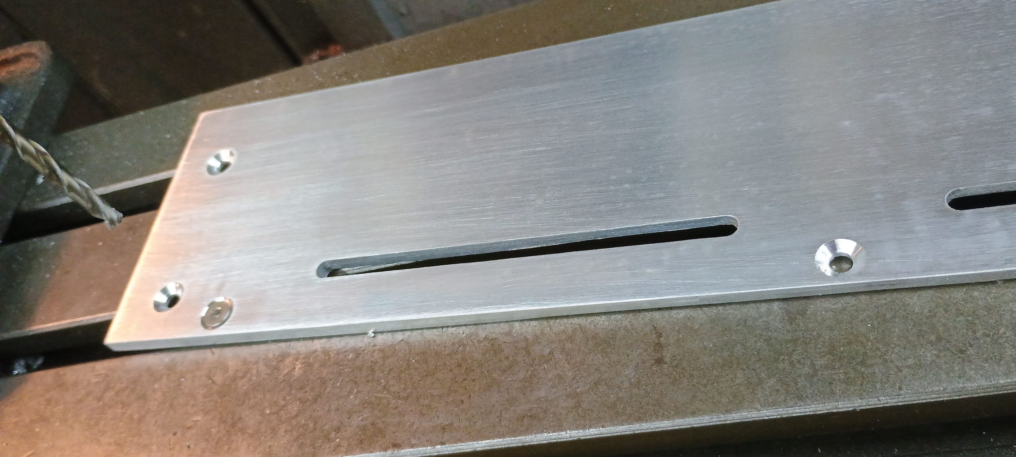

    Went with .218 drill thru and touch deeper countersink to give more case adjustment of stainless flat heads and add bling before final sand...
