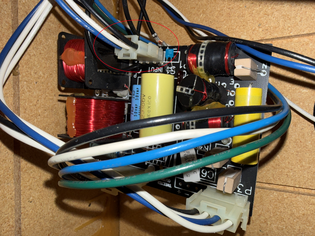

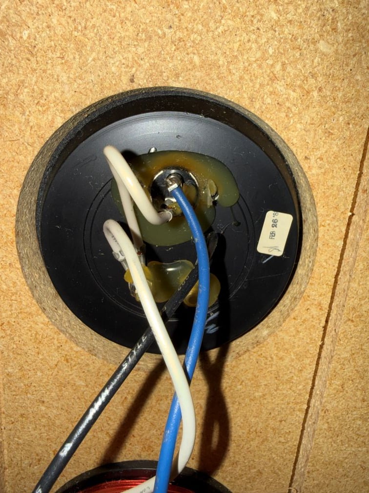

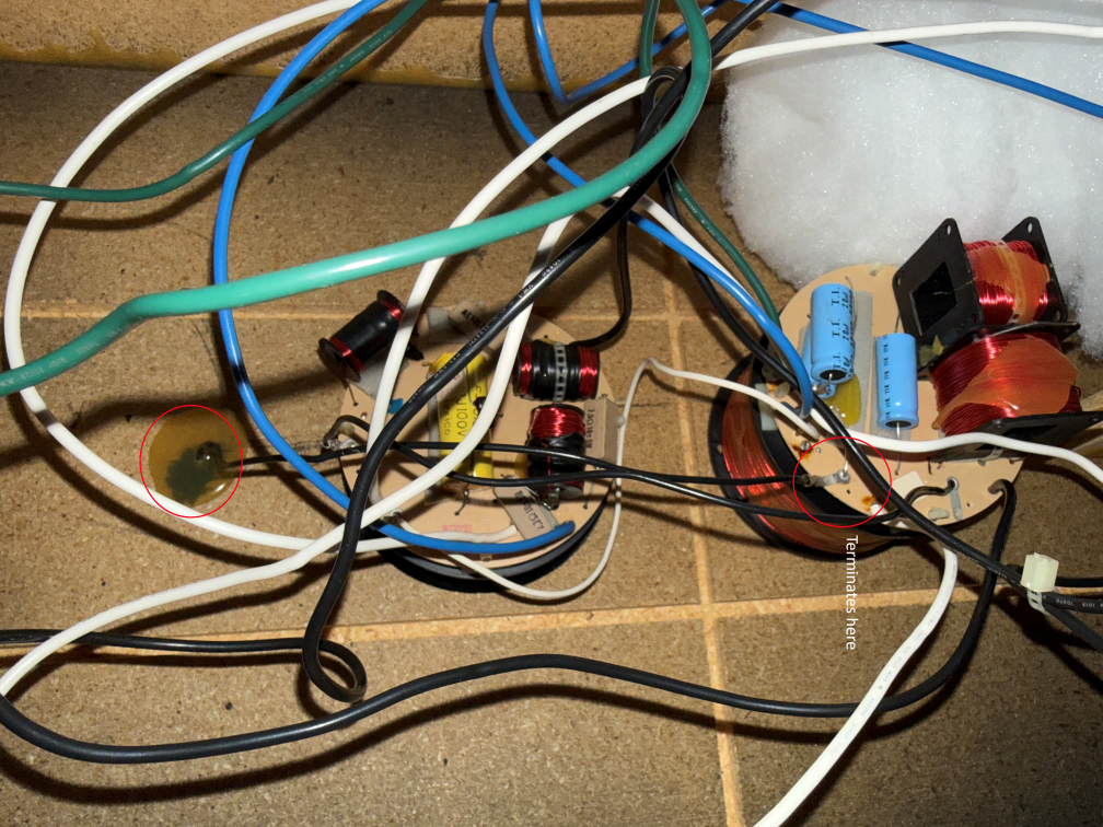

Thanks again to everyone who has responded. The drivers were a combination of 6510/6511 so they are a pair of SDA-1Cs, as I thought I'd purchased. But I still have the problem of the mismatched interconnection sockets. I took some photos while I had the speakers open. The right speaker with the blade/blade socket seems to have a single wire that is terminated at a large coil (crossover?). The left speaker (pin/blade) joins the blade with the -ve speaker terminal. The interconnection pin wire, -ve and +ve speaker terminals are joined into a single plug and inserted into a socket on the circuit board (the blue, black and white wires). So I guess my question is: how do I configure my the cable I need to fabricate?
My guess is to join the single cable from the right speaker to the blue wire on the left?
Yup.The pin of one cabinet goes to whichever blade is actually connected to something on the other cabinet.Homersapian wrote: »My guess is to join the single cable from the right speaker to the blue wire on the left?
IF (big IF) you ever would want to use an isolation transformer in the SDA cable, you'll have to connect the "non-connected" blade terminal to the negative speaker-cable connection. (No time like the present...) -
Interesting set of crossovers.
