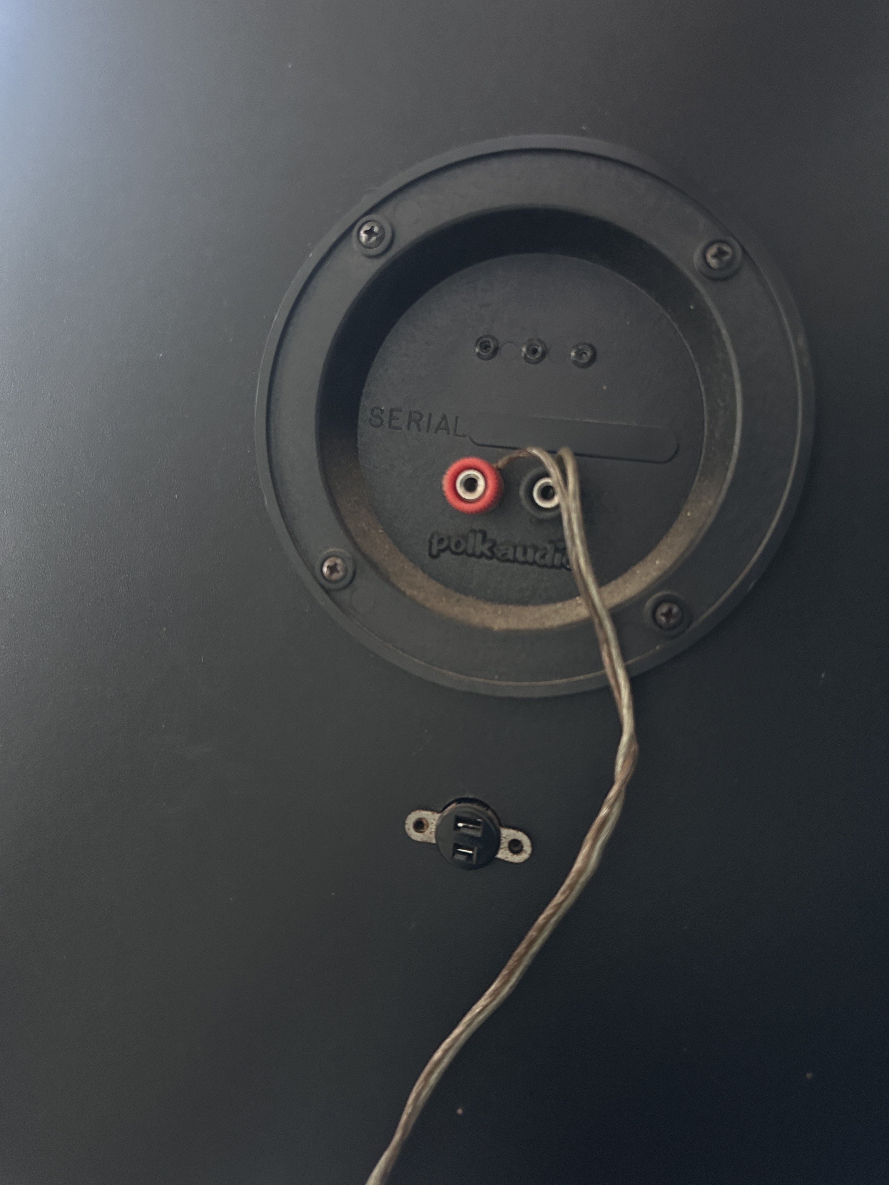

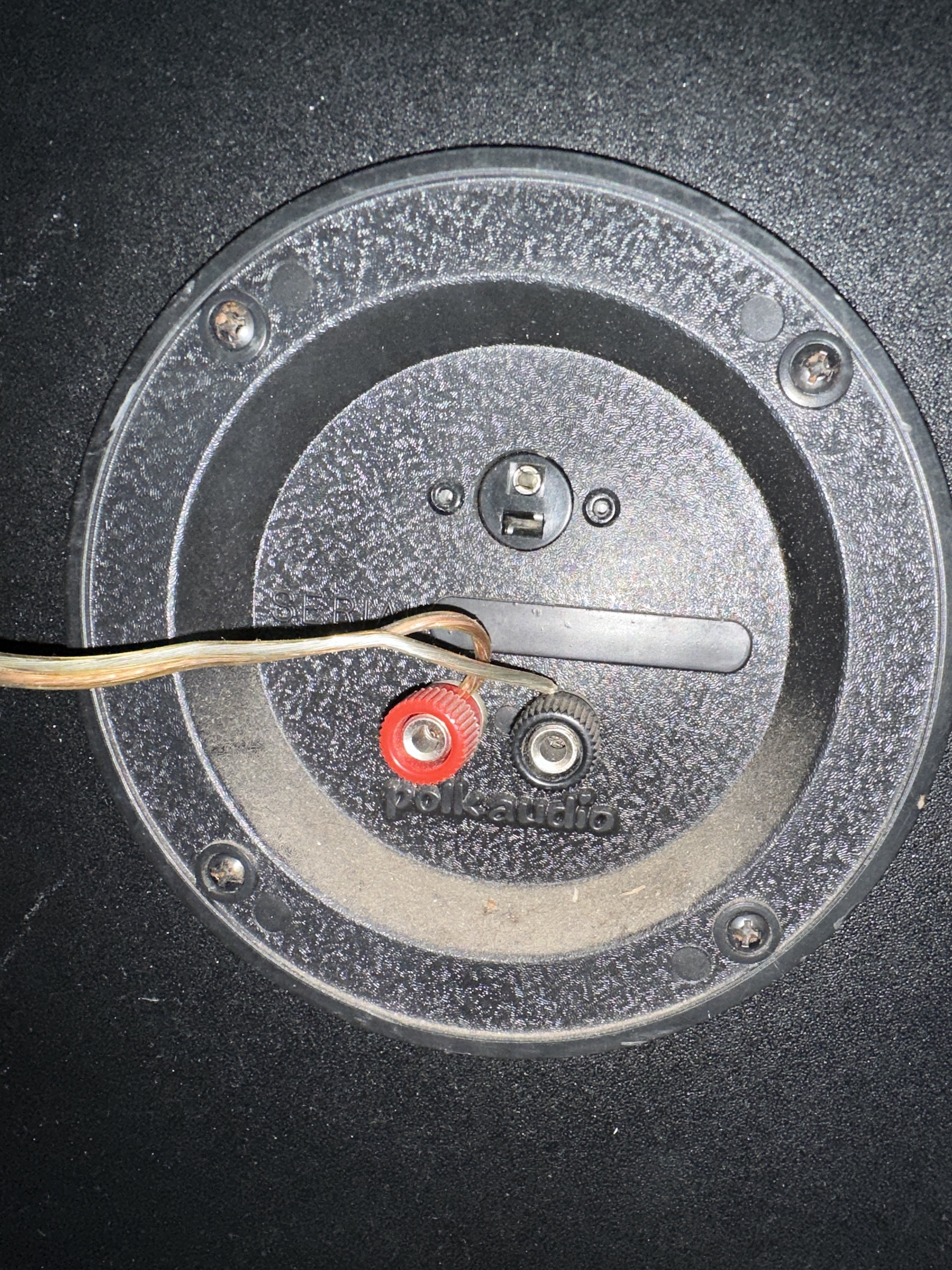

    Hi Everyone. I hope this forum is still monitored. Despite my wife's protests, I am reviving my SDA-1Cs. But I cannot find my interconnection cable. I have seen the workarounds presented in the forums, but I have an additional problem that my two speakers have different interconnection cable sockets - one has the two blades and the other has the pin/blade (photos attached ignore the inadequate speaker wire, I will be upgrading it before its final set up). I bought these as floor models from the PX at Pearl Harbor in 1988 and did not realize the issue until later. To their credit, Polk sent me an entirely new cable with an adapter which, in the ensuing 38 years, I have lost. If anyone can give me advice as to how to fabricate and fit a new cable, I would be grateful2gndeho66u2f.jpg

    I'd be interested in what drivers are in each of your speakers.
    Welcome aboard.
    I'm aware of the adapter you speak about. Knowing what drivers are in your speakers will give us the info to better give you the correct information.

    ASSUMING that these speakers really are a pair of 1Cs, and not a 1C and a 1B, for example:
    At minimum, you need to connect the pin of the pin/blade connector to one or the other of the blades on the Blade/blade connector. I can't remember which blade is active on those. In their original configuration, one blade will not be connected to anything else, so you could connect the pin end, and then touch the other end of the cable to each blade on the other cabinet--the one that changes the sound is the correct one.
    The factory recommended--but user-installed--fix was to connect the "dead" blade of the Blade/blade cabinet terminal to speaker-cable negative terminal. Kinda guessing that has not been done to your speakers, but all you'd have to do is connect an ohmmeter between the negative speaker terminal of that cabinet, and each of the two blades in the Blade/blade connector. If neither of them have continuity, the speaker has not been given the "factory-recommended" fix.
    It's a matter of finding wire-end connectors that mate with the speaker-cabinet connectors--pin on one end of your SDA cable, blade on the other end.
    The better fix is to bypass the OEM connectors, install and wire-in aftermarket connectors--the air-tight Neutriks heavily favored. Then you build an SDA cable of appropriate length with the matching Neutrik connectors.
    pitdogg2 Posts: 27,881
    In a pin/blade, only the pin is necessary.
    In a Blade/blade model SDA 1b for instance both blades carry signal
    Some very early Blade/blade SDA 1c had the Blade/blade connector, those I have seen were in the cup, not outside like the Blade/blade models.
