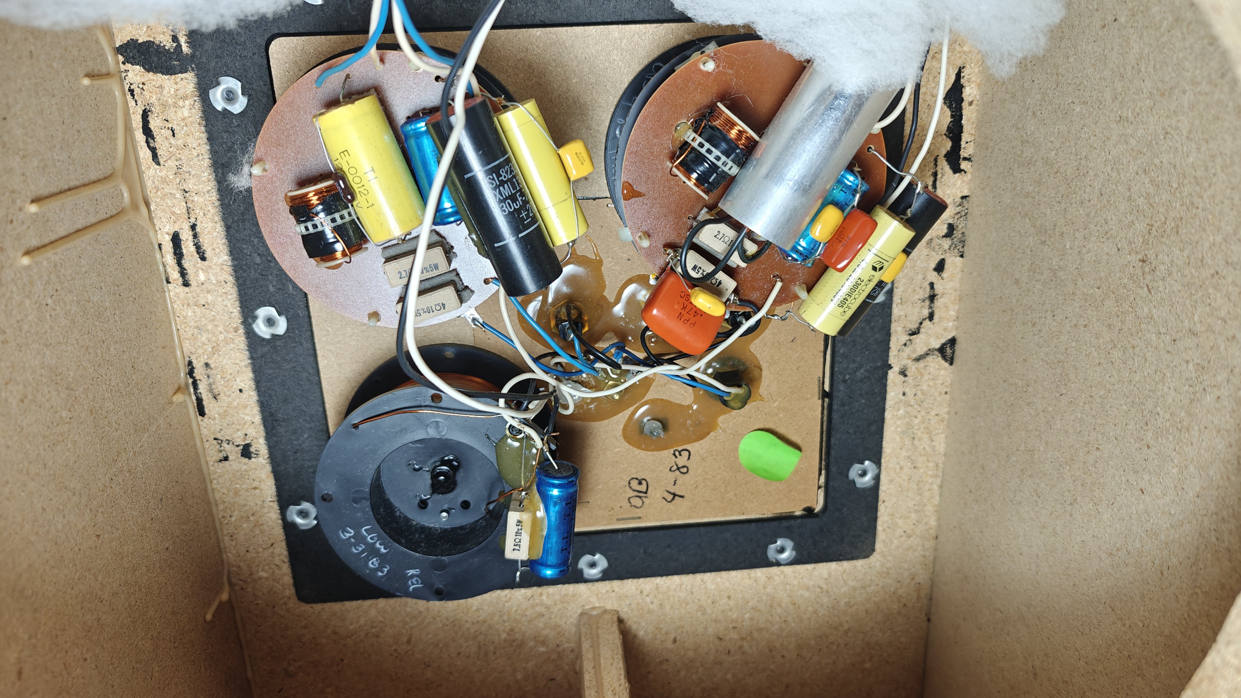

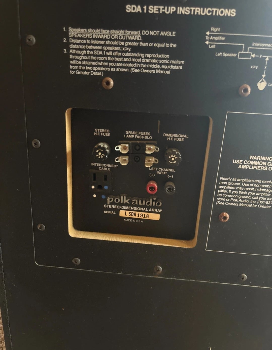

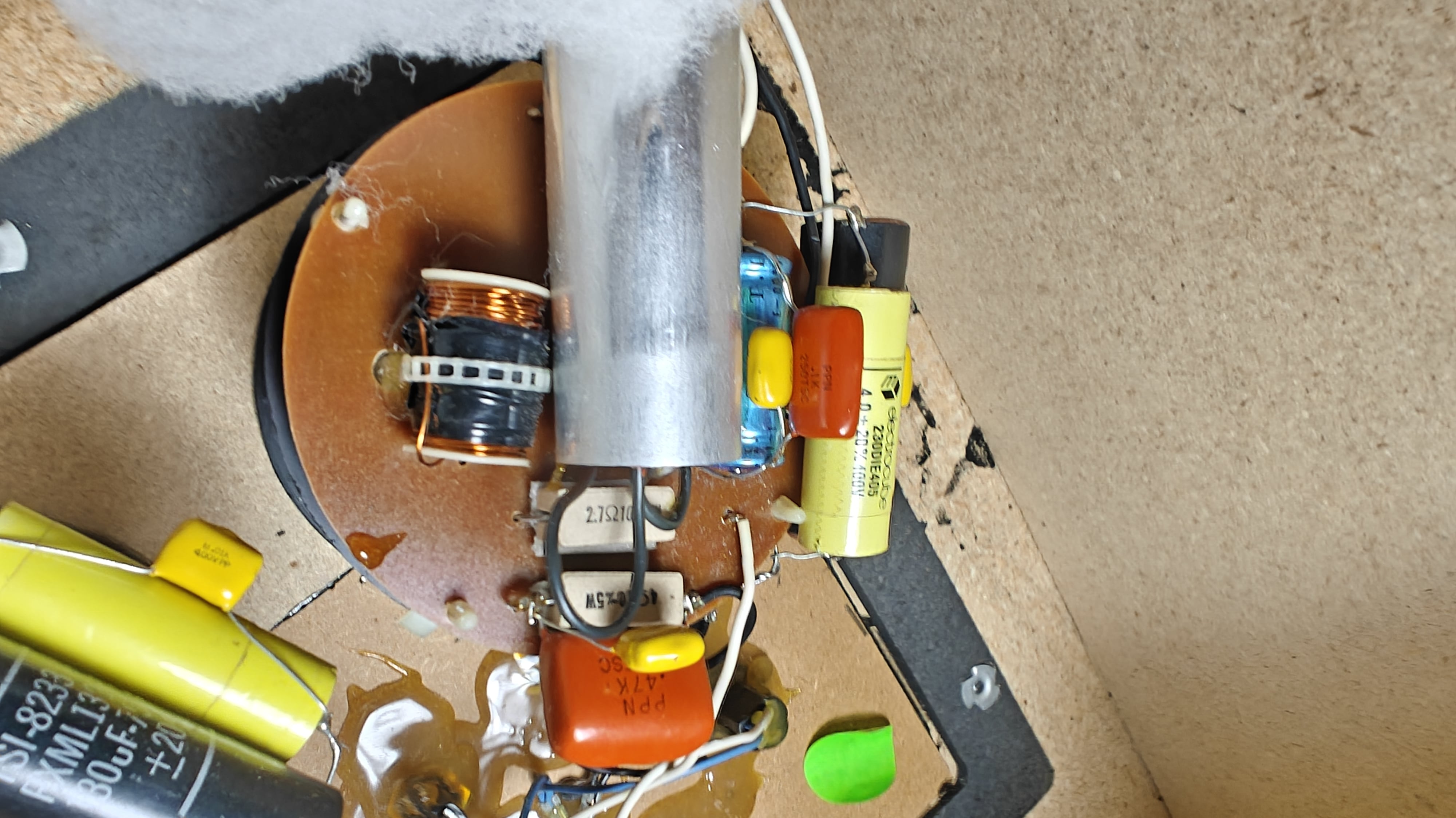

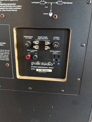

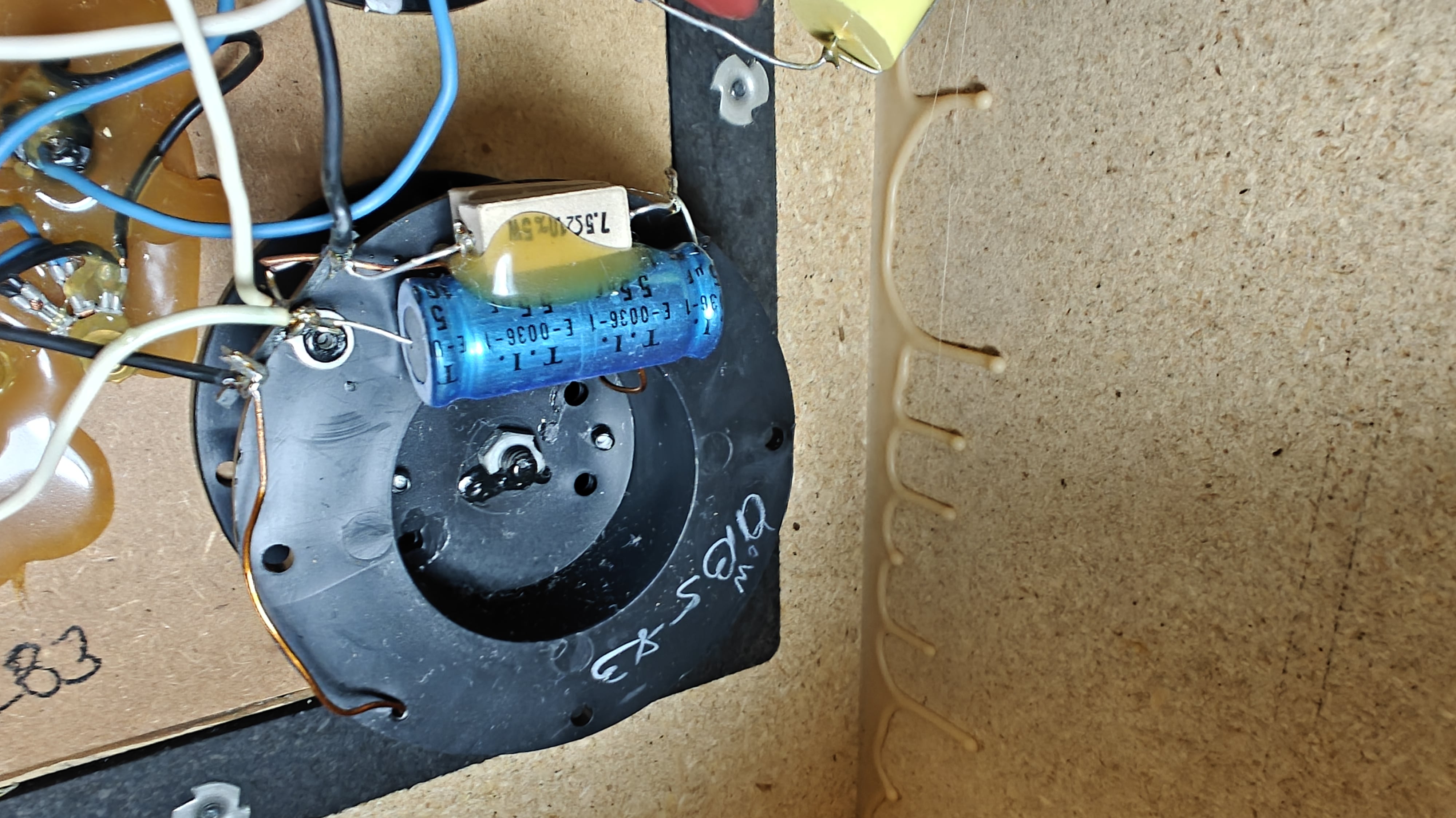

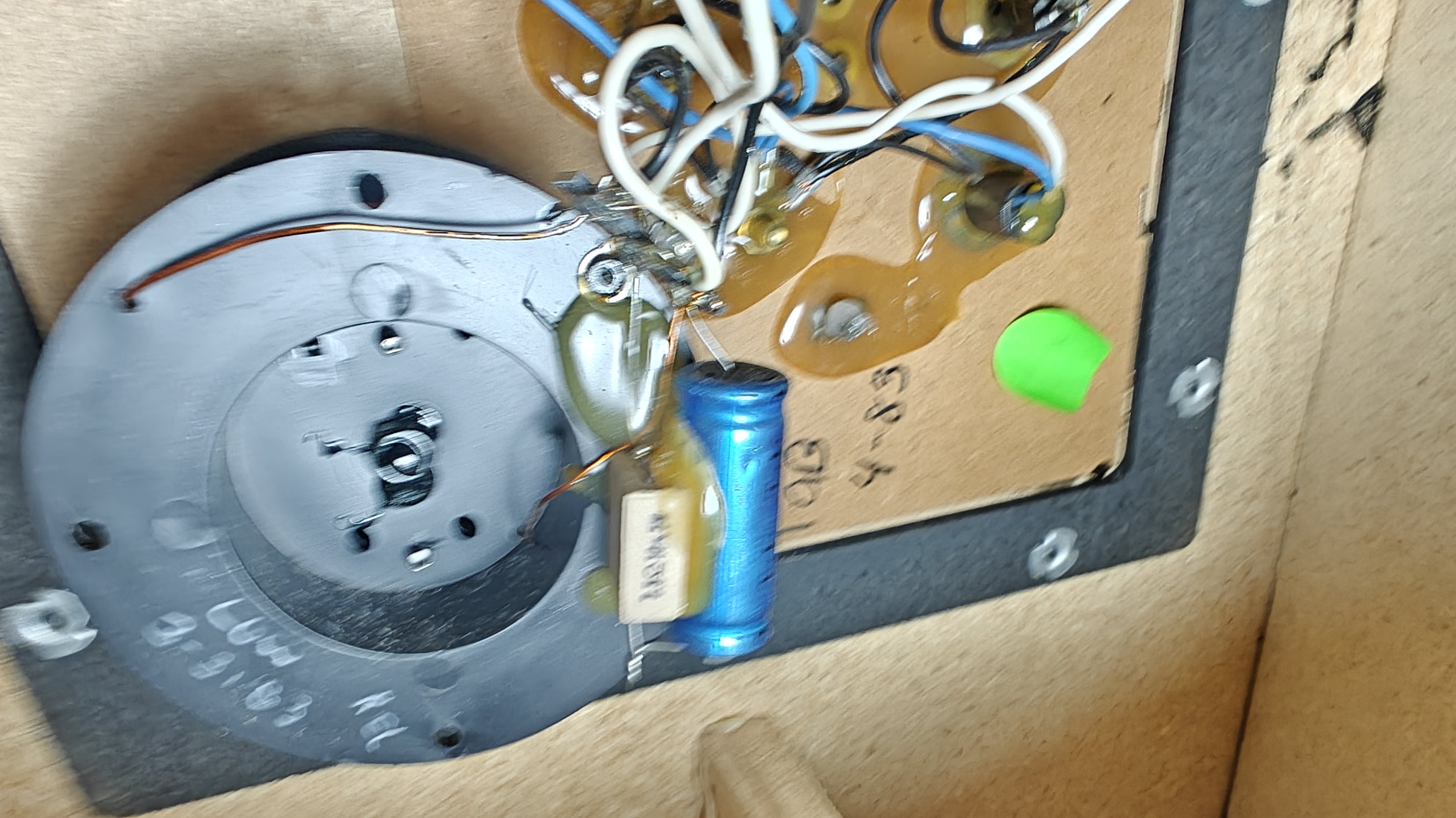

    Hi everyone I just joined I recently picked up a pair of SDA 1 c with the horizontal tweeters. They came with no interconnect cable and the pins have two male post and 1 ground hole I did get them for free but was going to use a speaker negative and positive post to hook these up I do have the round coils on the crossovers had not messed with them yet I want to get the service manual with schematic to make sure just connecting the same pins are okay what's your opinion I can't find a pin interconnect with two female ends thanks

    These seem to be the early version I have two Port holes that control the two upper woofers air escapes when you push them the 4 bottom woofers move with the 12 inch radiator I think they are great once I get everything sorted out thanks for any input
  • Schurkey
    Schurkey Posts: 2,130
    NOT "1C". That's the original SDA1.

    Wear would I get the speak on style plugs and can you send a picture thanks
  • Unknown
    edited September 29
    F1nut Posts: 52,406
    You are also missing a fuse holder cap and fuse. No workie without those.

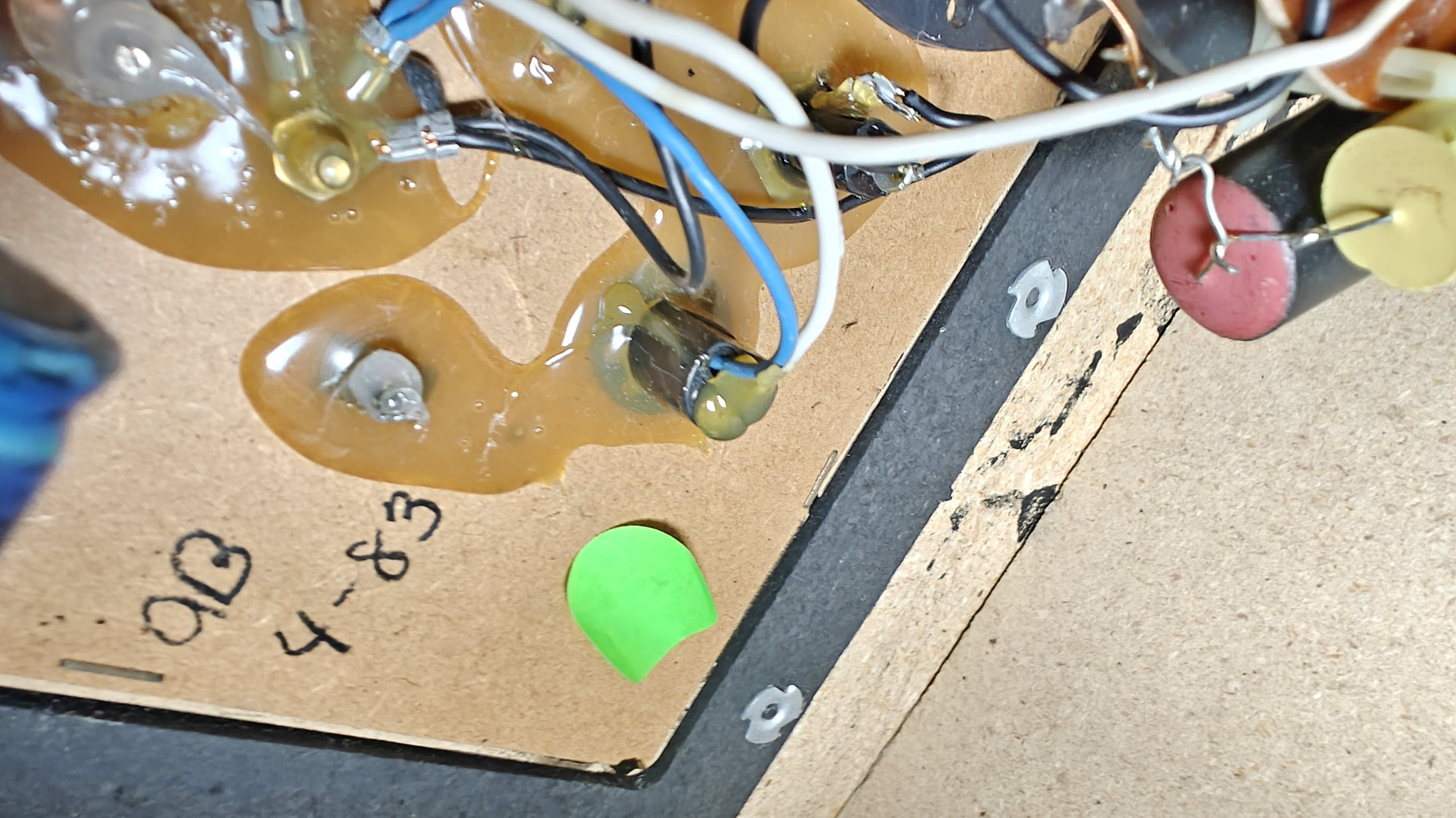

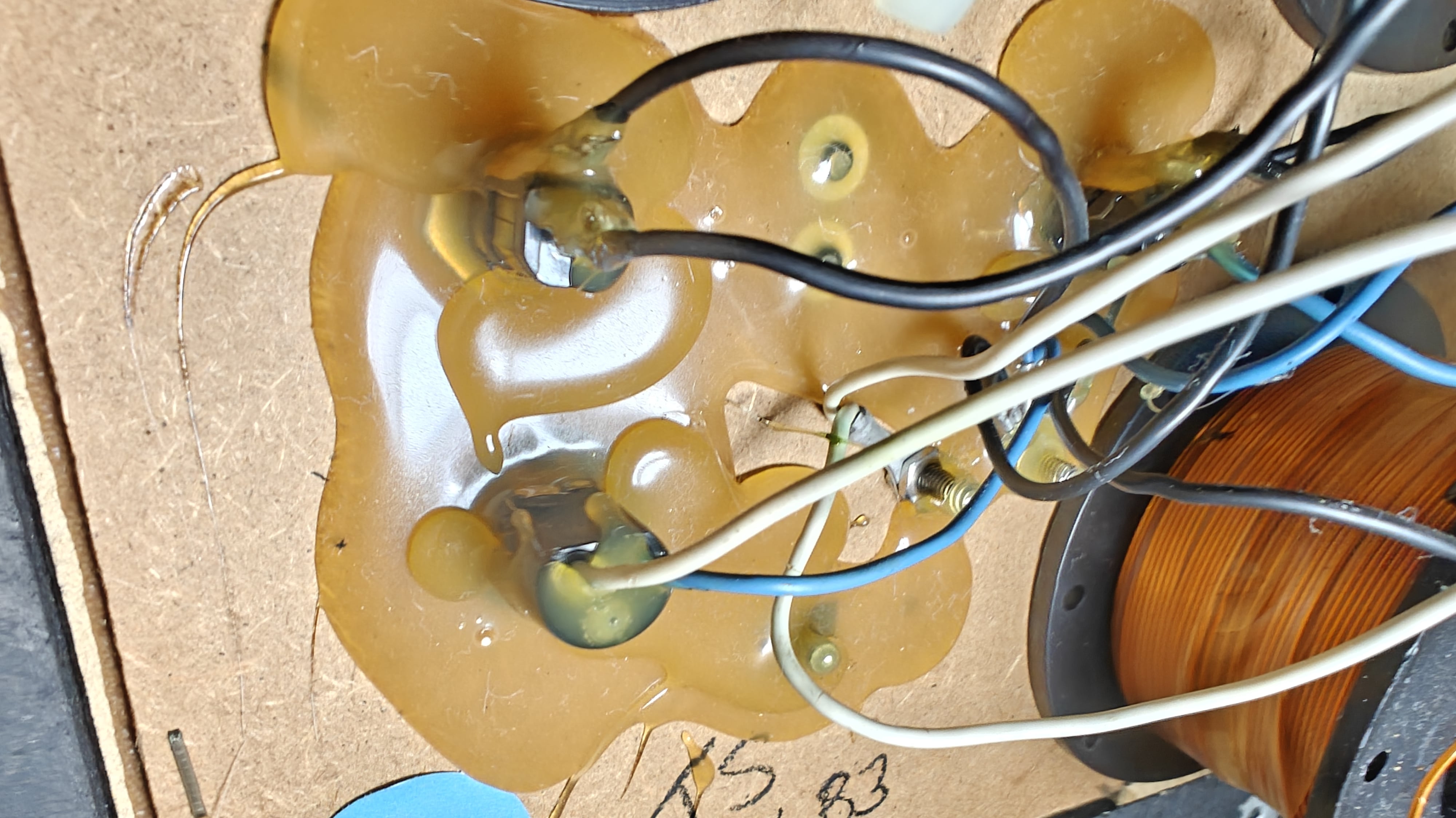

    Thank you for letting me know the positive and negative needs to be switched I would of thought they needed to be the same these are the SDA 1 not A or B or C I plan on fully restoring them to original the two fuse holders I will have to change out with Bussmans I can keep original ones on one speaker they are from 1983 and one 1984 models
  • Rpennino
    I know positive and negative are critical with these but I have no transformer like in the latter models and as you can see on the crossover you can see the negatives and positives are tied together I would think switching the positive and negative would effect the rest of the crossover and short the coils
    SDA speakers do not have a transformer.

    It looks like to me I just need to match blue left to blue right and white left to white right and they should work I seen those pictures when I was researching the wiring thanks for the information
