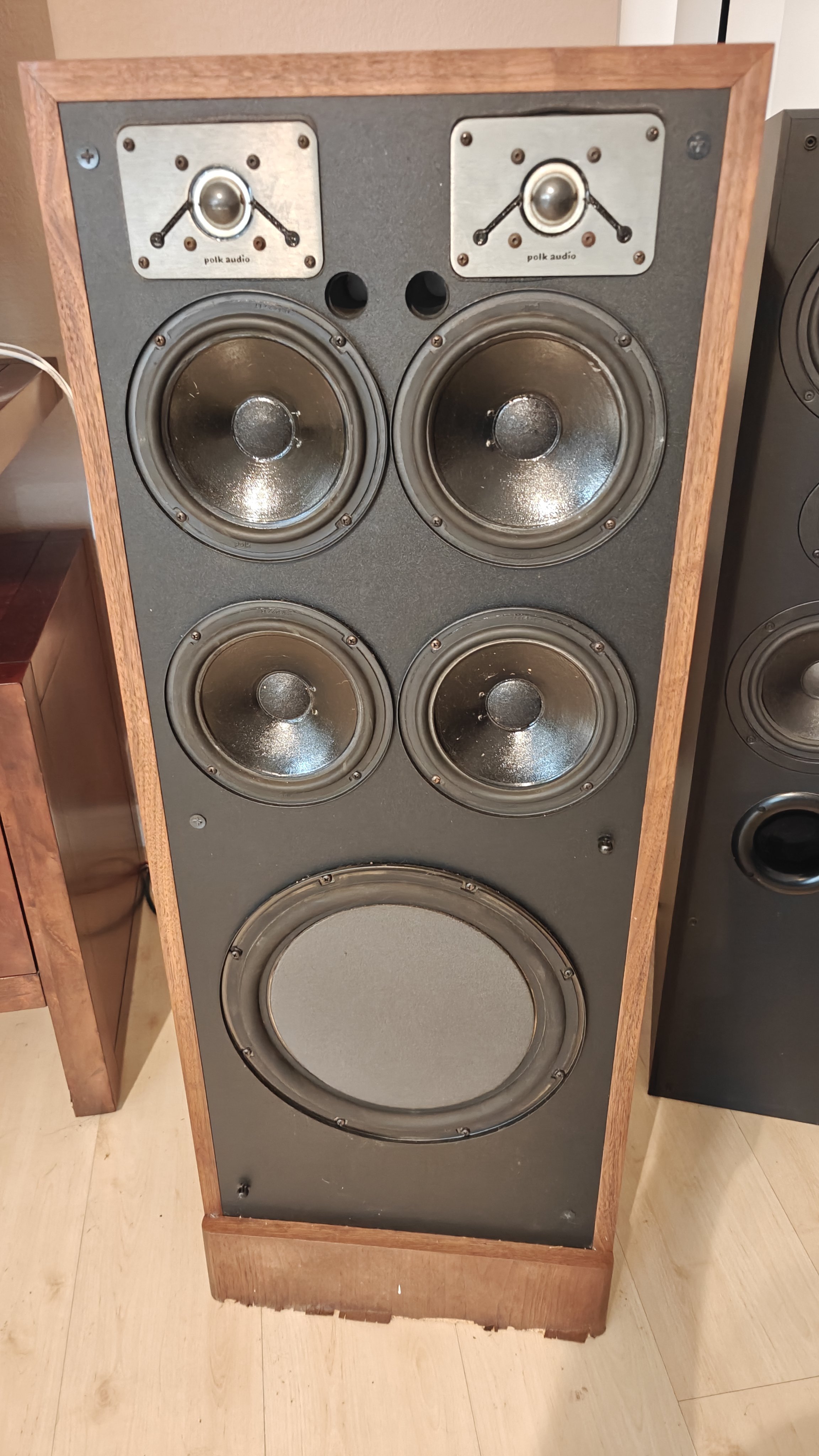

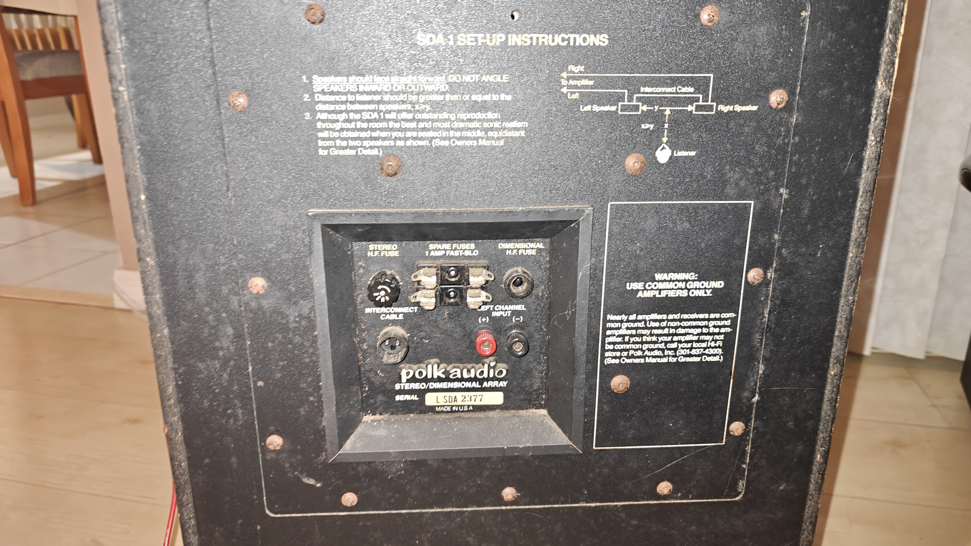

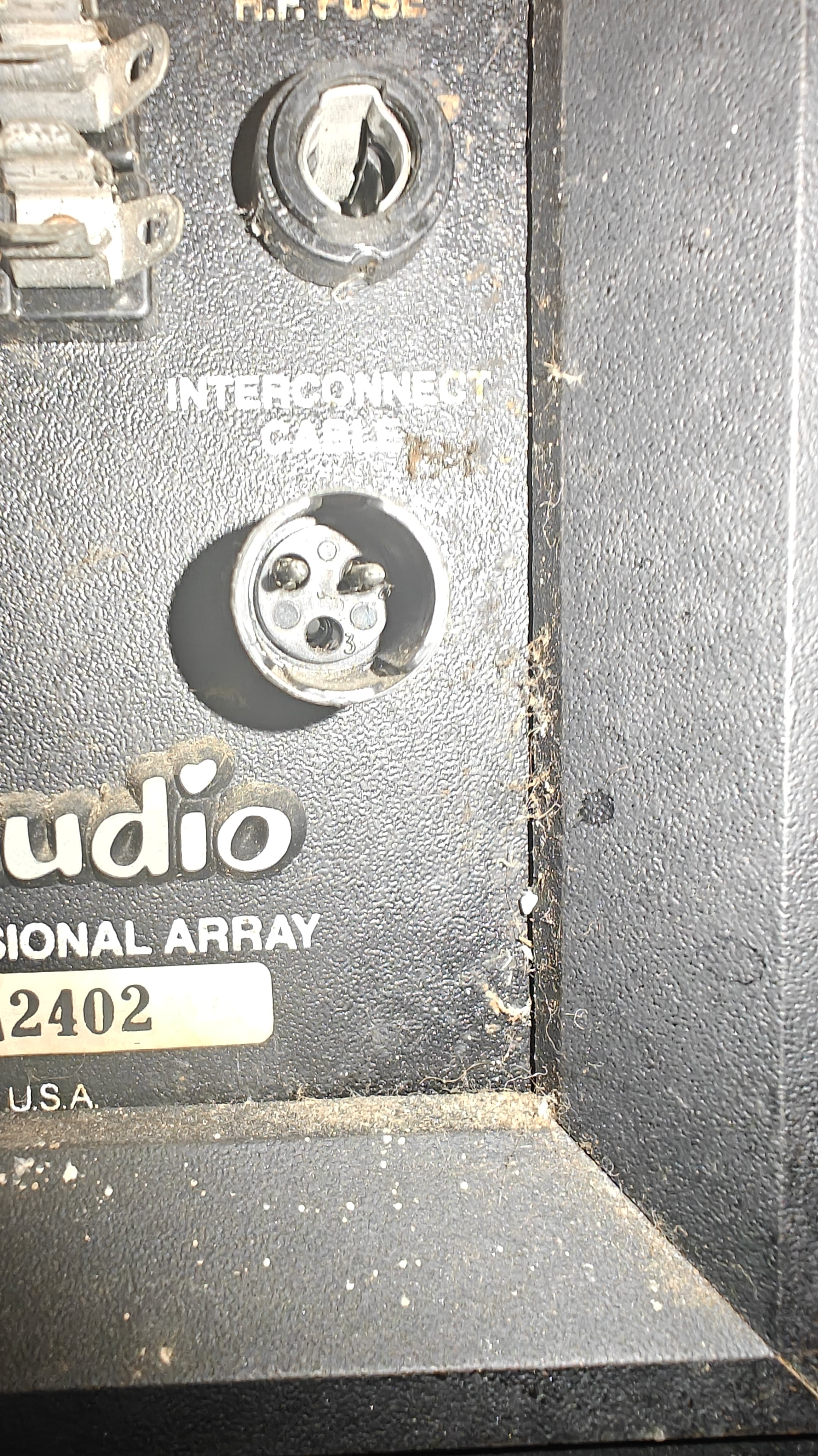

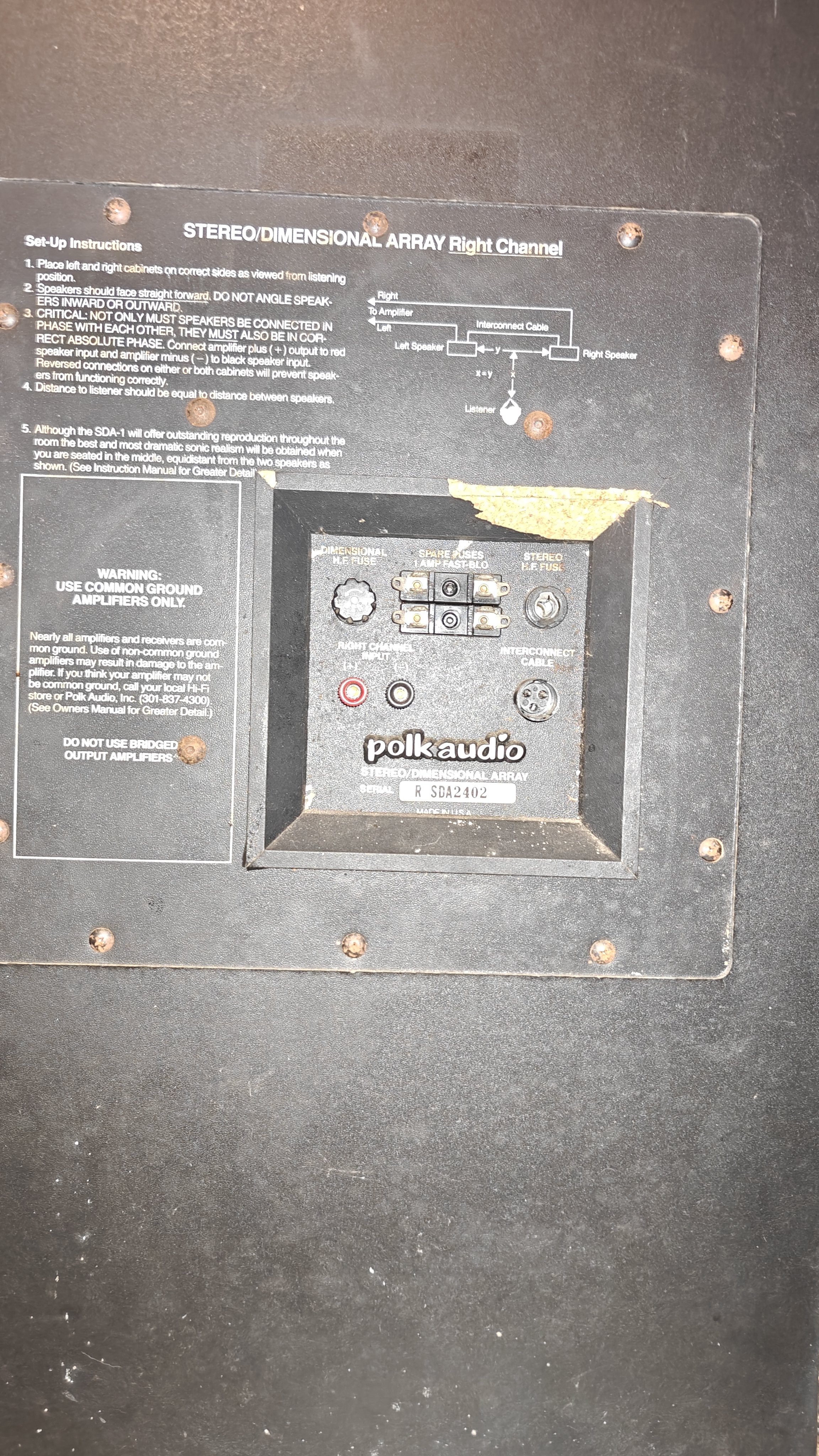

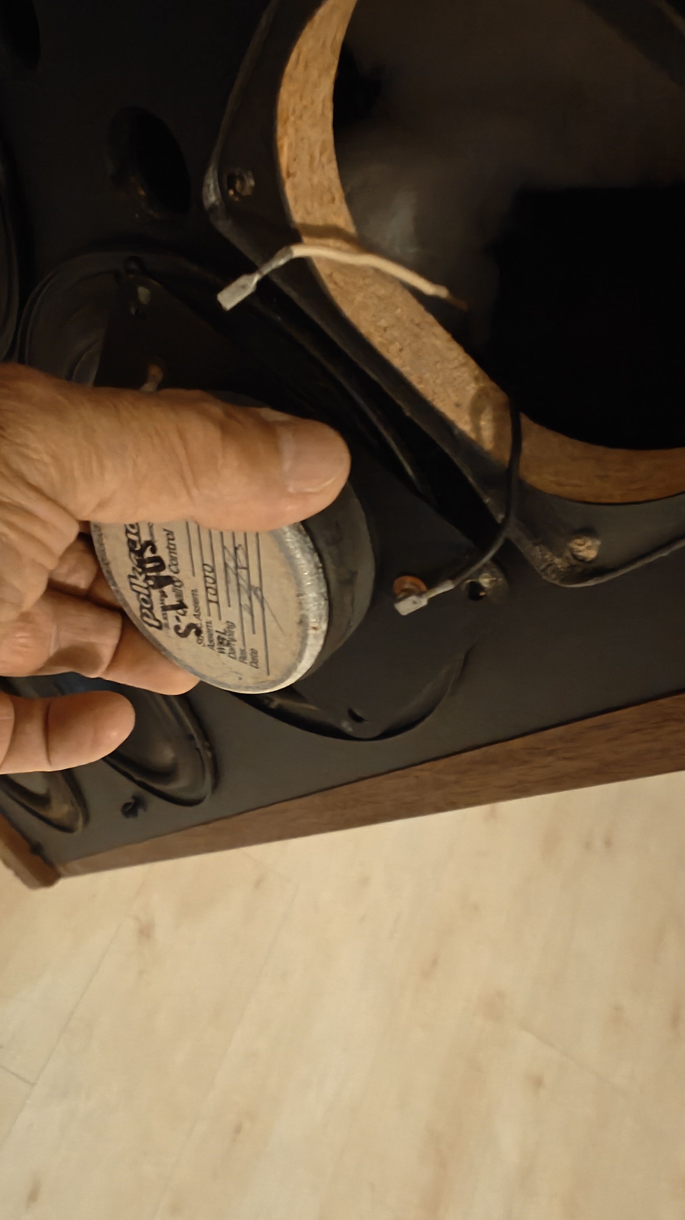

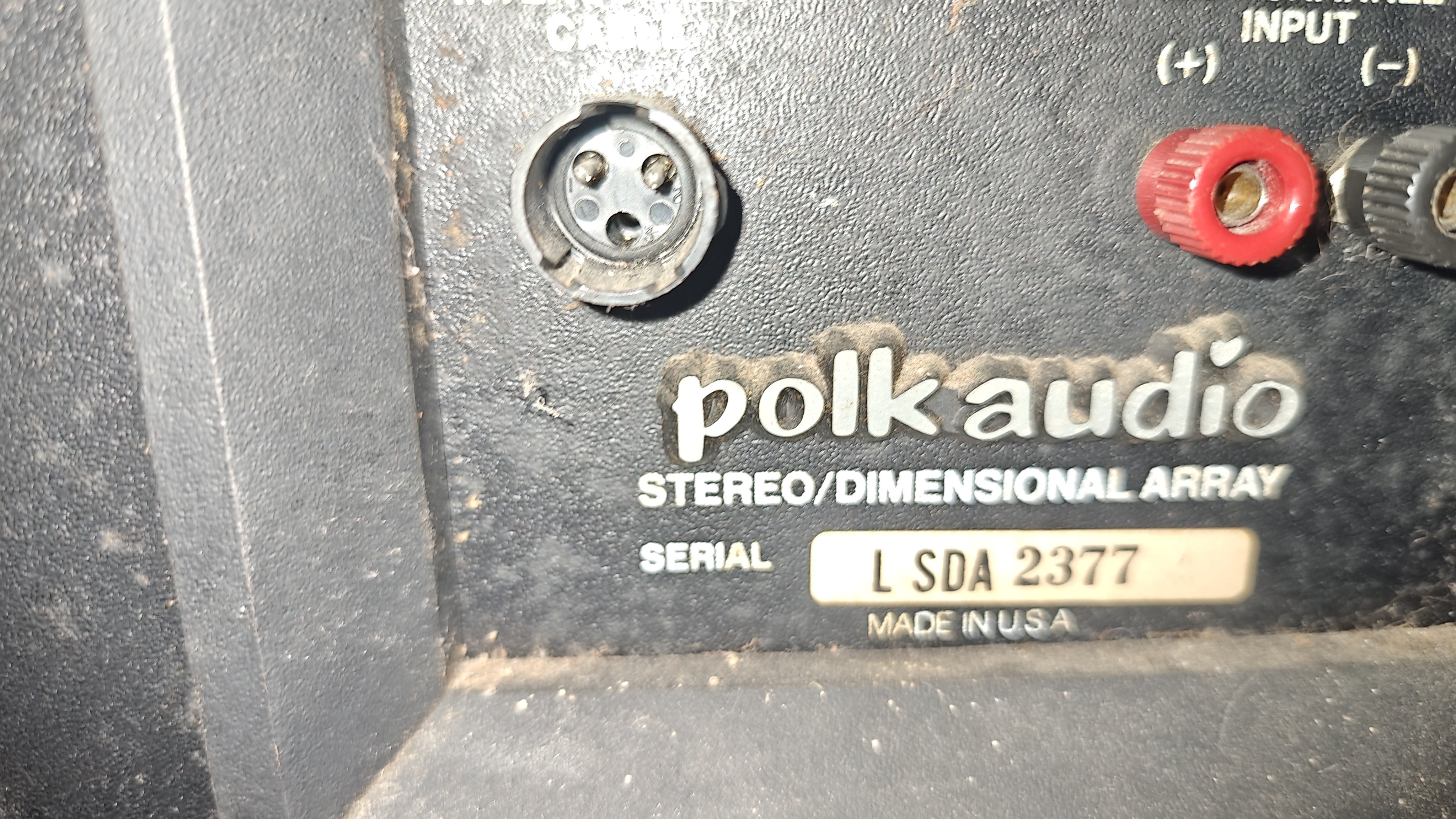

    Hi everyone I just joined I recently picked up a pair of SDA 1 c with the horizontal tweeters. They came with no interconnect cable and the pins have two male post and 1 ground hole I did get them for free but was going to use a speaker negative and positive post to hook these up I do have the round coils on the crossovers had not messed with them yet I want to get the service manual with schematic to make sure just connecting the same pins are okay what's your opinion I can't find a pin interconnect with two female ends thanks
    pitdogg2 Posts: 27,884
    edited September 28
    Pictures of front of the speaker and back binding post cup with cable socket please. That would help us.
    Thanks
  • Rpennino
  • Rpennino

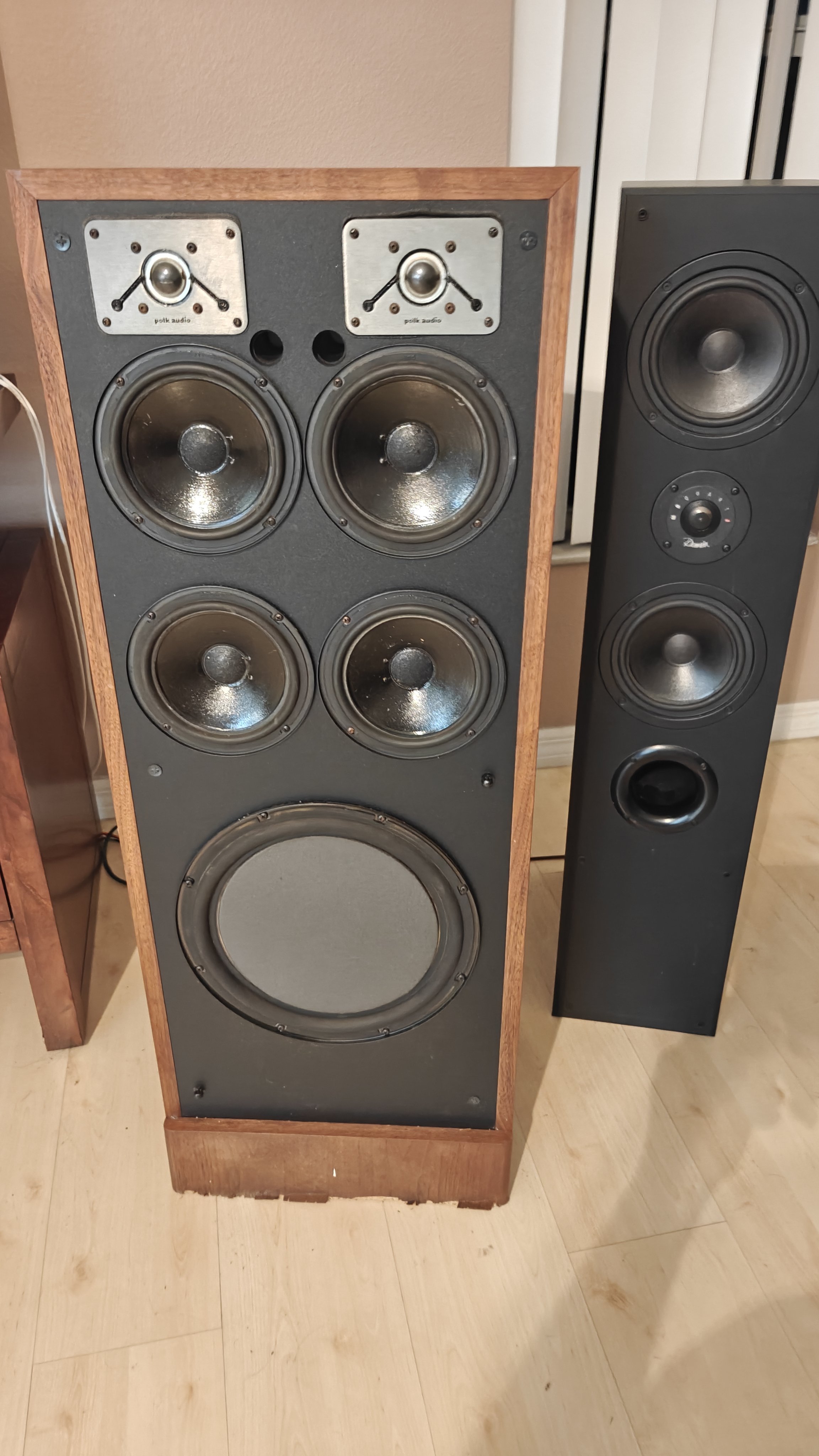

    These seem to be the early version I have two Port holes that control the two upper woofers air escapes when you push them the 4 bottom woofers move with the 12 inch radiator I think they are great once I get everything sorted out thanks for any input
  • Schurkey
    Schurkey Posts: 2,127

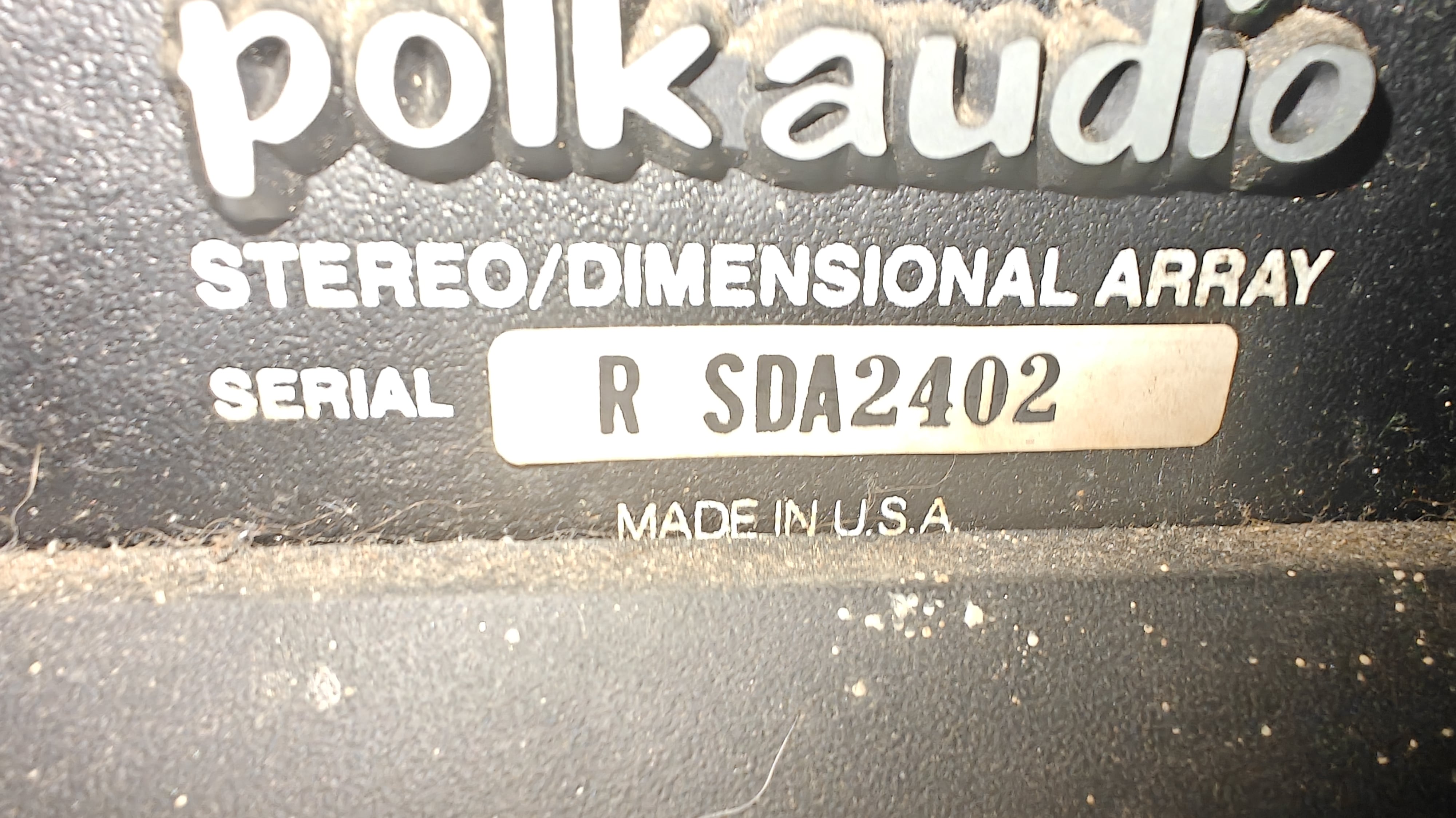

    NOT "1C". That's the original SDA1.
  • Bigbang
    Bigbang Posts: 235
    I think you are correct. SDA1. Not SDA-1c’s.
