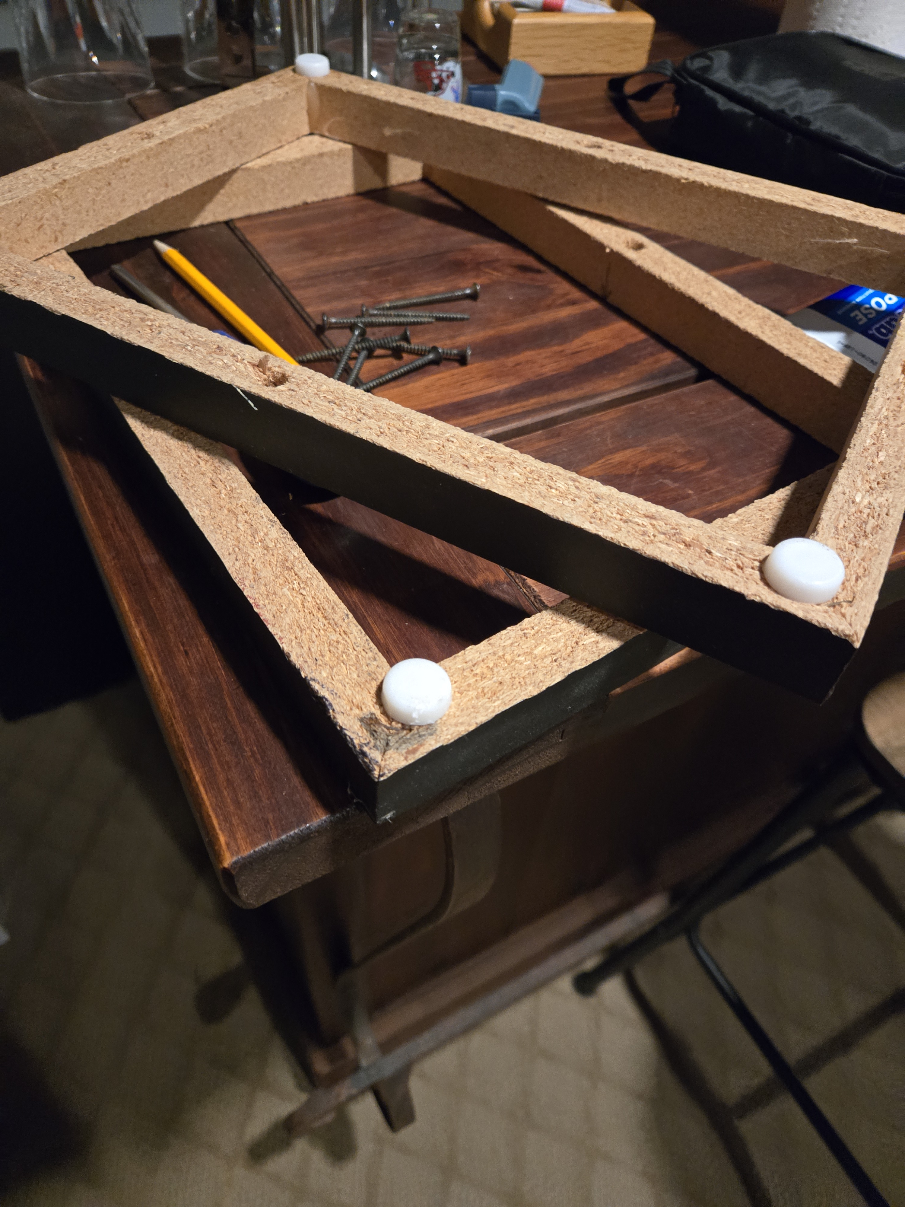

A quick question for vintage experts. Is this the factory method used around 1990 for attaching the fabric or has someone already redone these in the past? I recall my RTA11T used glue for the fabric.
Edit: after taking out most of the staples, I don't see any glue residue. I guess this was factory.See profile for rigs. Nothing else here. -
Just checked my SDA 2B Studios (bought in 1988). The fabric was glued on. No staples. The uneven cuts in yours would suggest they were redone.The arc of the moral universe is long, but it bends towards justice.—Martin Luther King Jr.

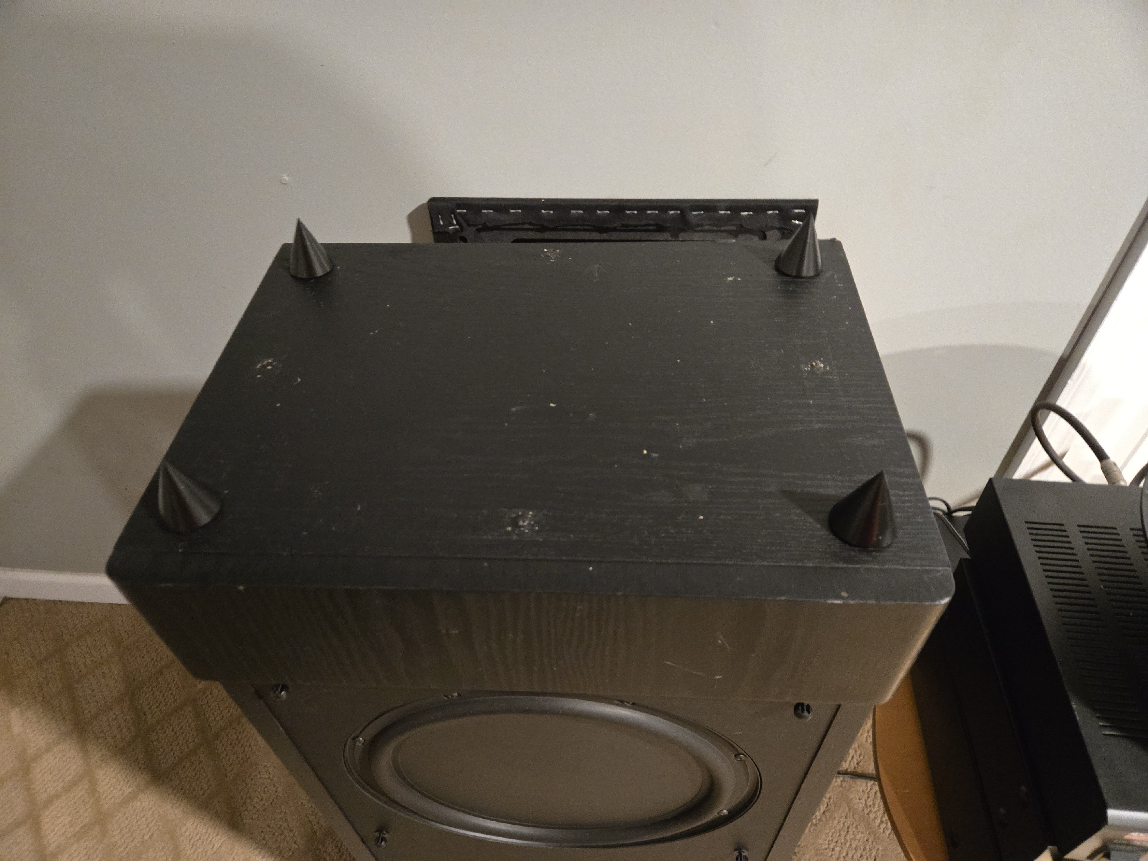

It has been a long time. These were on the back burner, but I finally installed brass cones (black chrome coated) on my 2B.
These gone...
These to replace...
That's about the end to the upgrades for these, but except maybe Trey's felt pads...

I sealed the old holes and the new holes. These spikes needed a full penetration for the threaded insert and post.See profile for rigs. Nothing else here.
