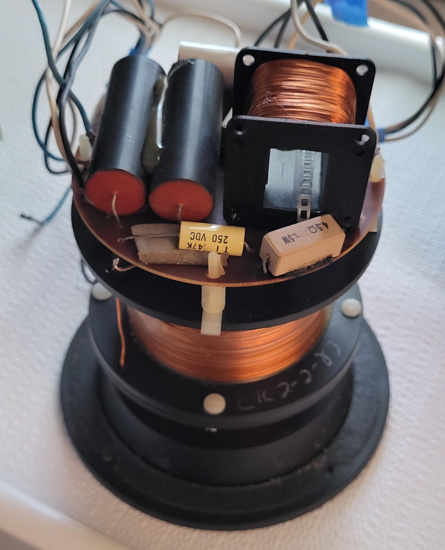

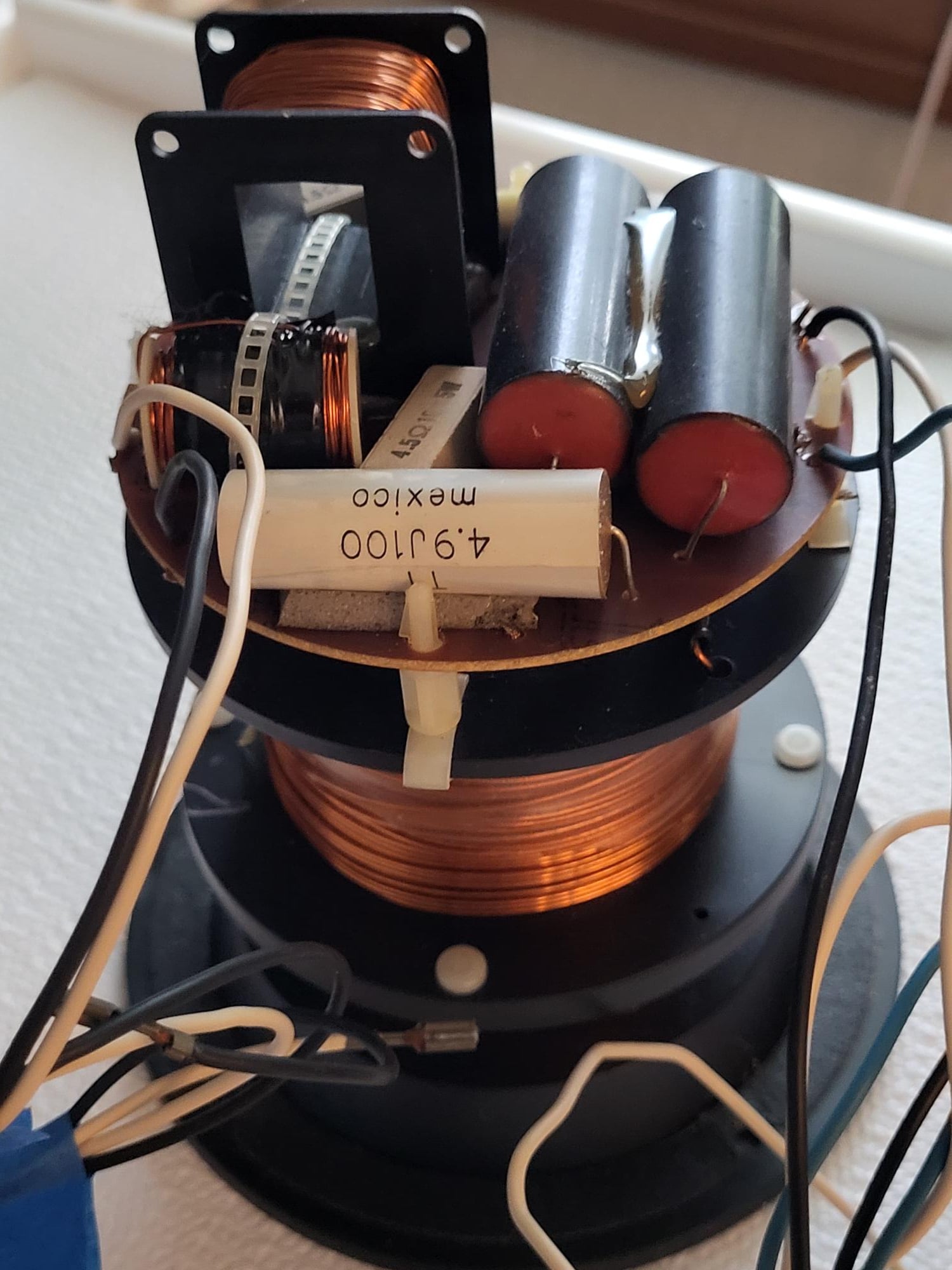

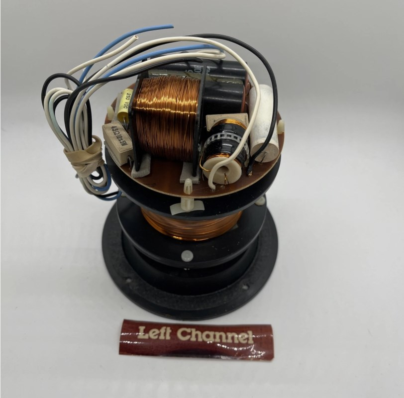

    Is this what your crossovers look like?
    George / NJ
    Onkyo A-8017 integrated
    iFi nano iDSD DAC
    iPurifier3
    iDefender w/ iPower PS
  • motorcityguy
    motorcityguy Posts: 63
    edited August 22
    Yes, mine look just like yours. Mine are dated 2/2/83. (The MW's were also dated 2/83.) The small yellow cap on mine is marked 0.47, whereas the Polk M11 schematic shows 0.5. Curious if yours are 0.5 or 0.47.

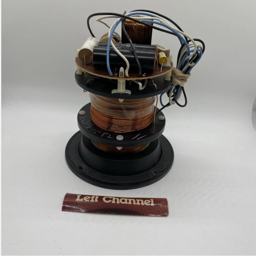

  • Gardenstater
    Gardenstater Posts: 4,880
    That was just a crossover for sale on eBay. I think the large inductor looks fried lol.
