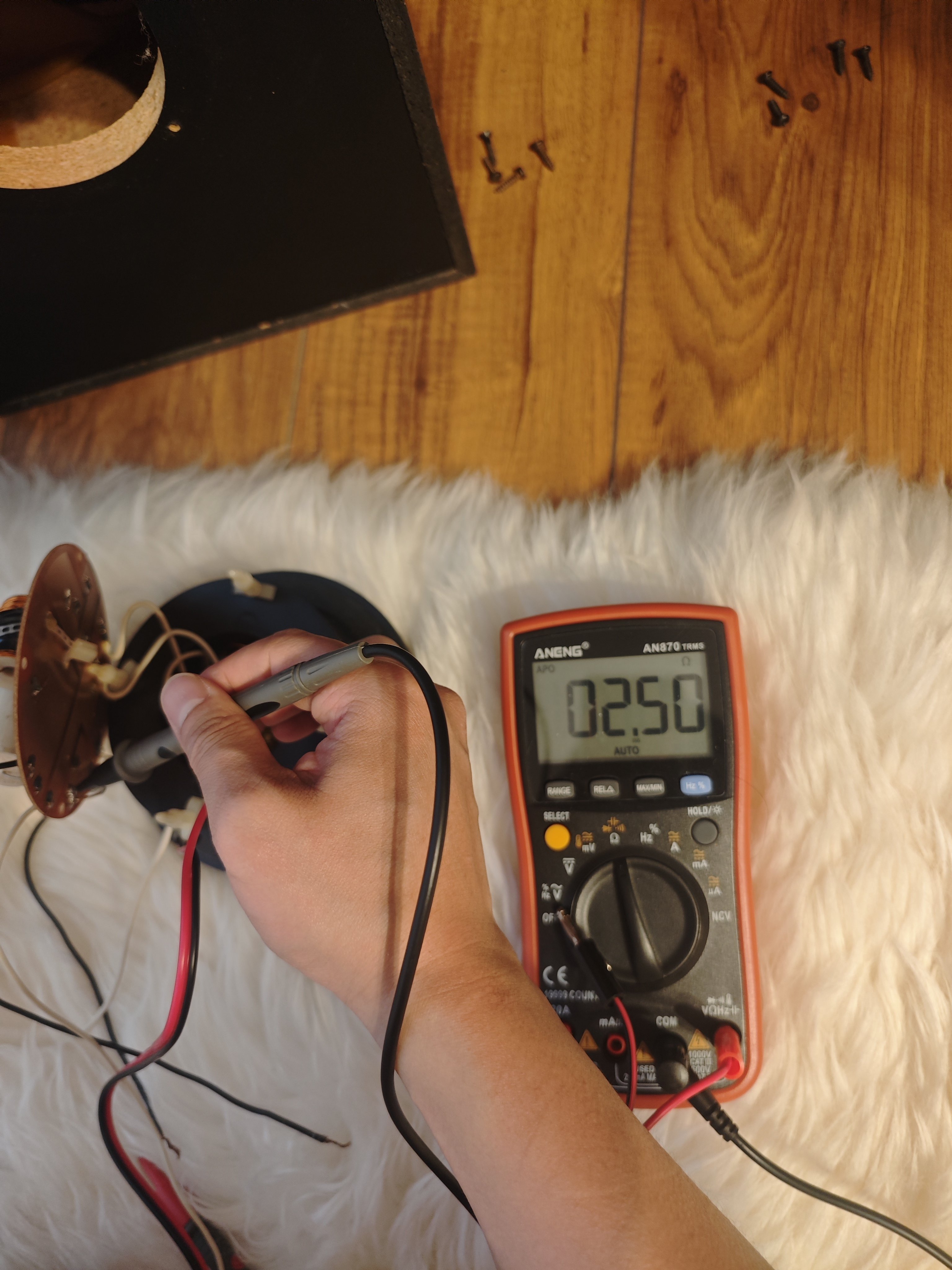

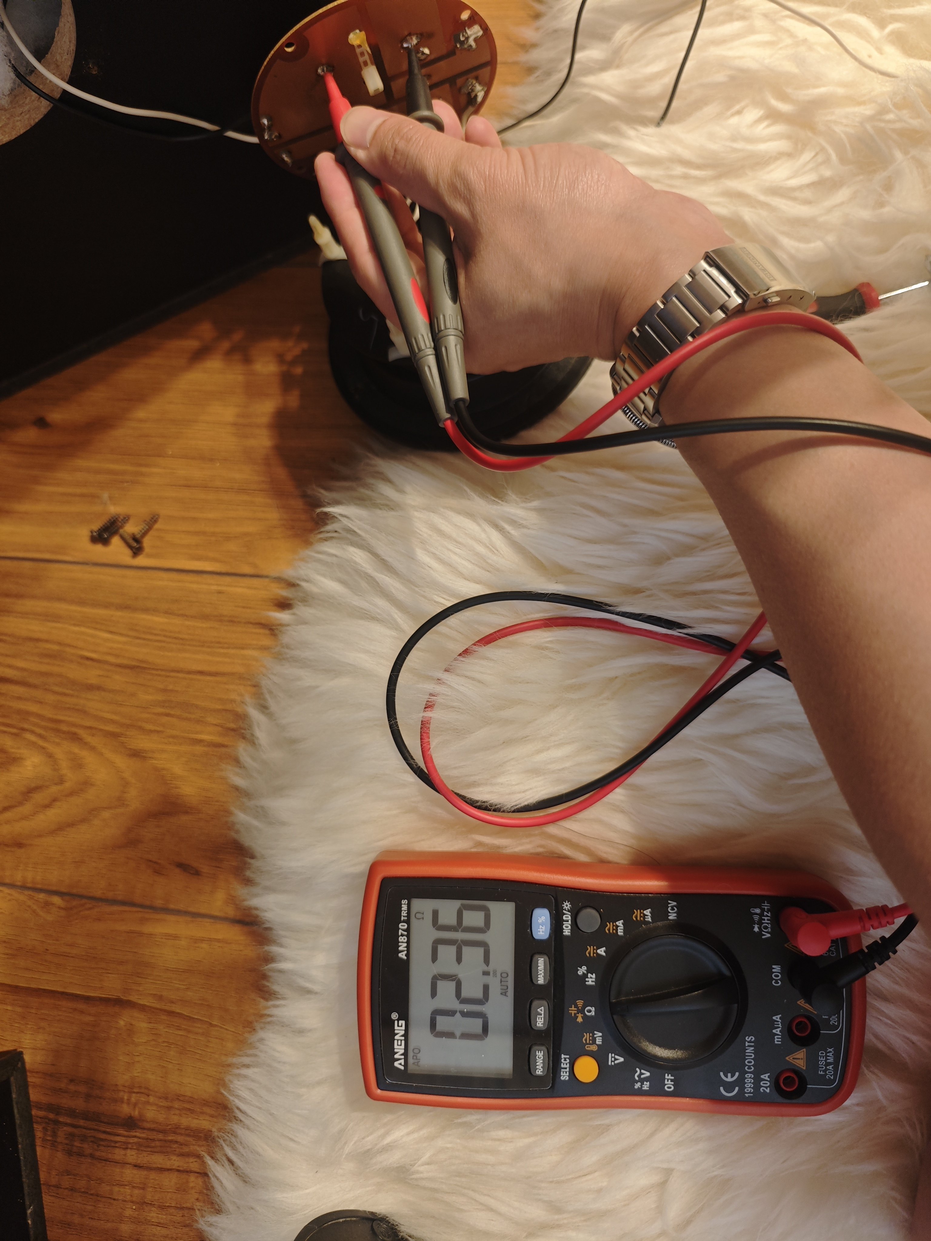

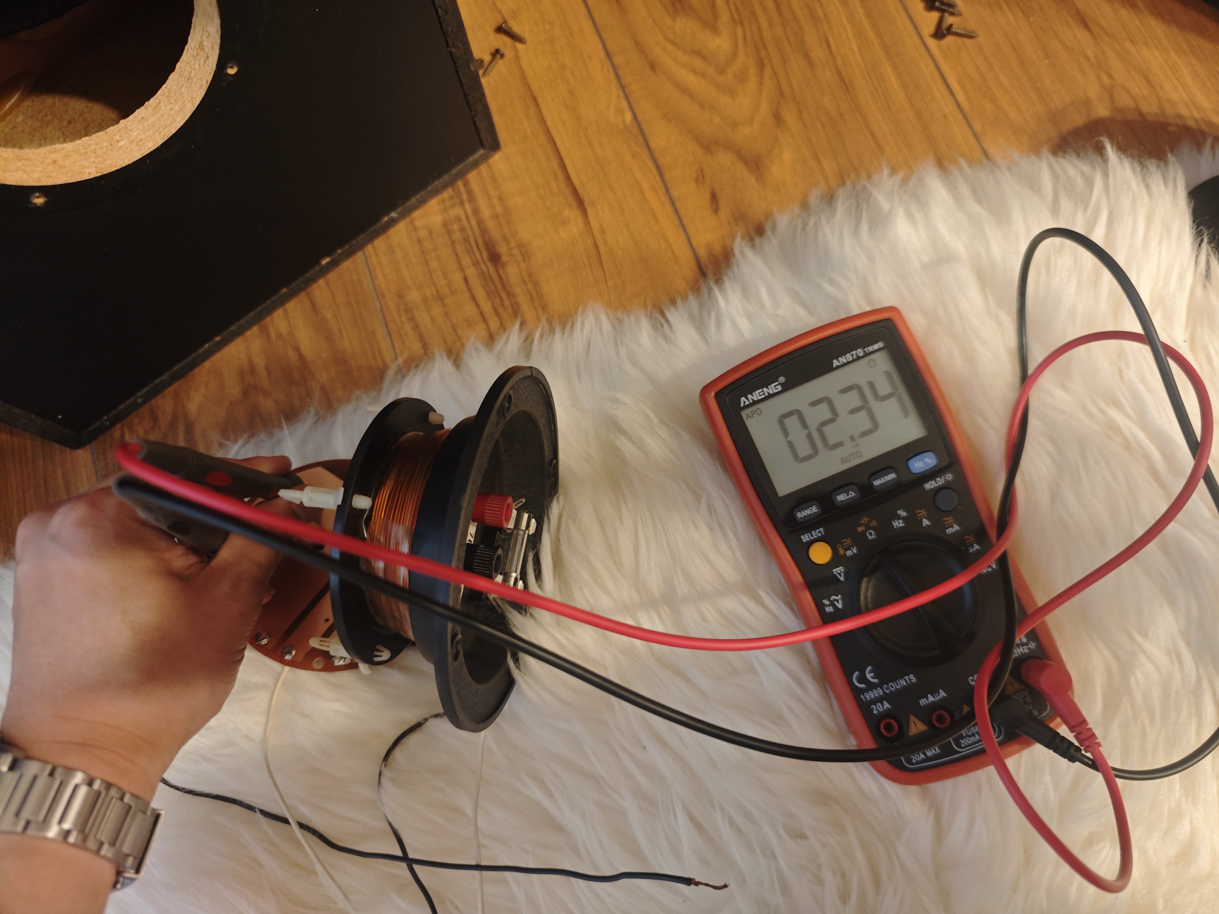

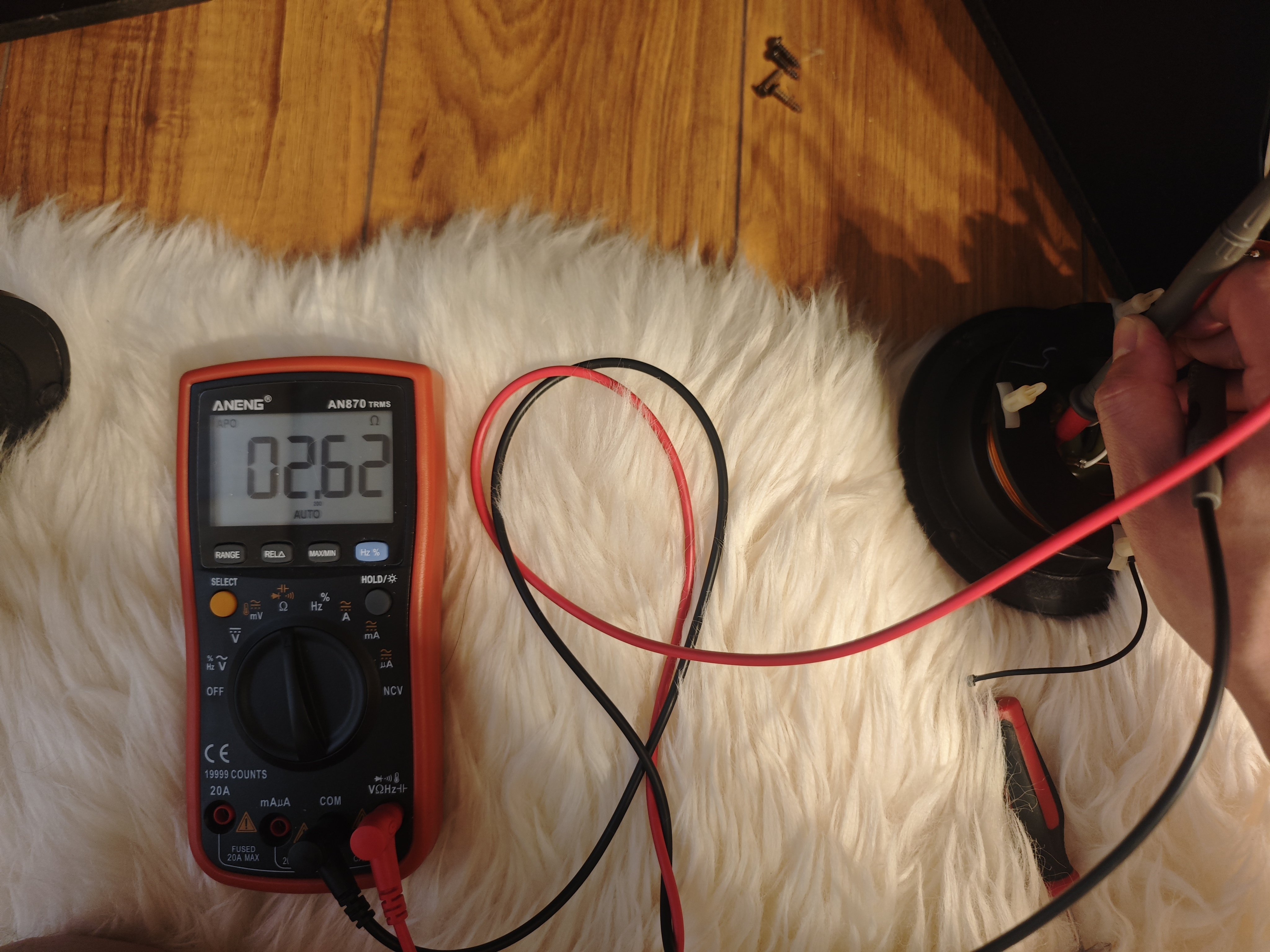

    Here are the DC resistance values I was able to measure from the crossovers. All measurements were taken with the woofer and tweeter removed and directly across the inductor leads:
    - Monitor 7 large inductor (at base of terminal plate): 2.50Ω
    - Monitor 7 small (on XO board): 2.34Ω
    - Monitor 5 large inductor: 2.62Ω
    - Monitor 5 small inductor: 2.36Ω
  • Gardenstater
    Gardenstater Posts: 4,944
    edited July 16
    Important thing is you got basically the same readings so most likely the inductances are the same as well, between 5A and 7B crossovers. Hard to read low resistances without a good meter. When the battery wasn't dead on mine I got around 0.7 Ohms for both on the M7 crossover.
