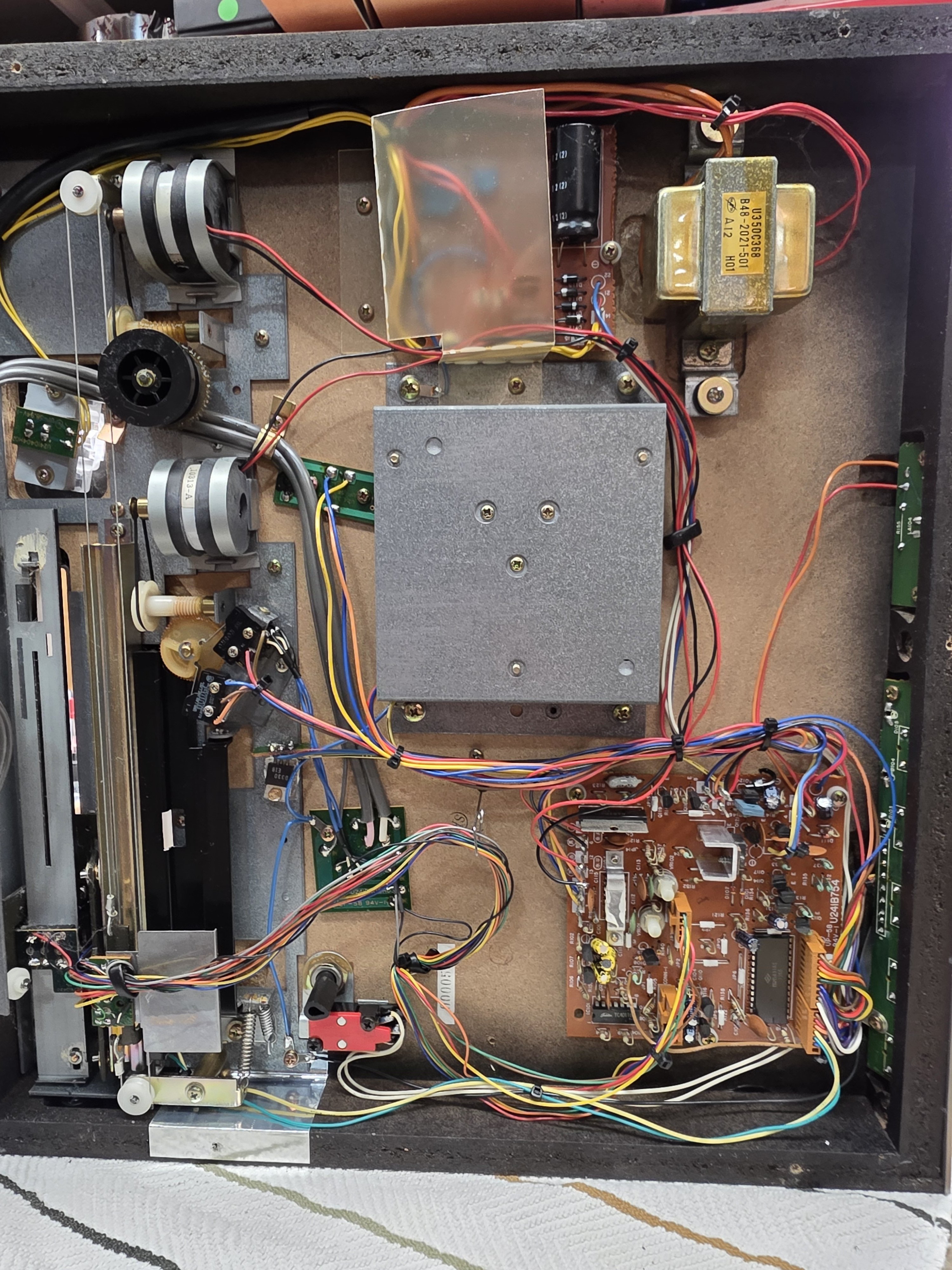

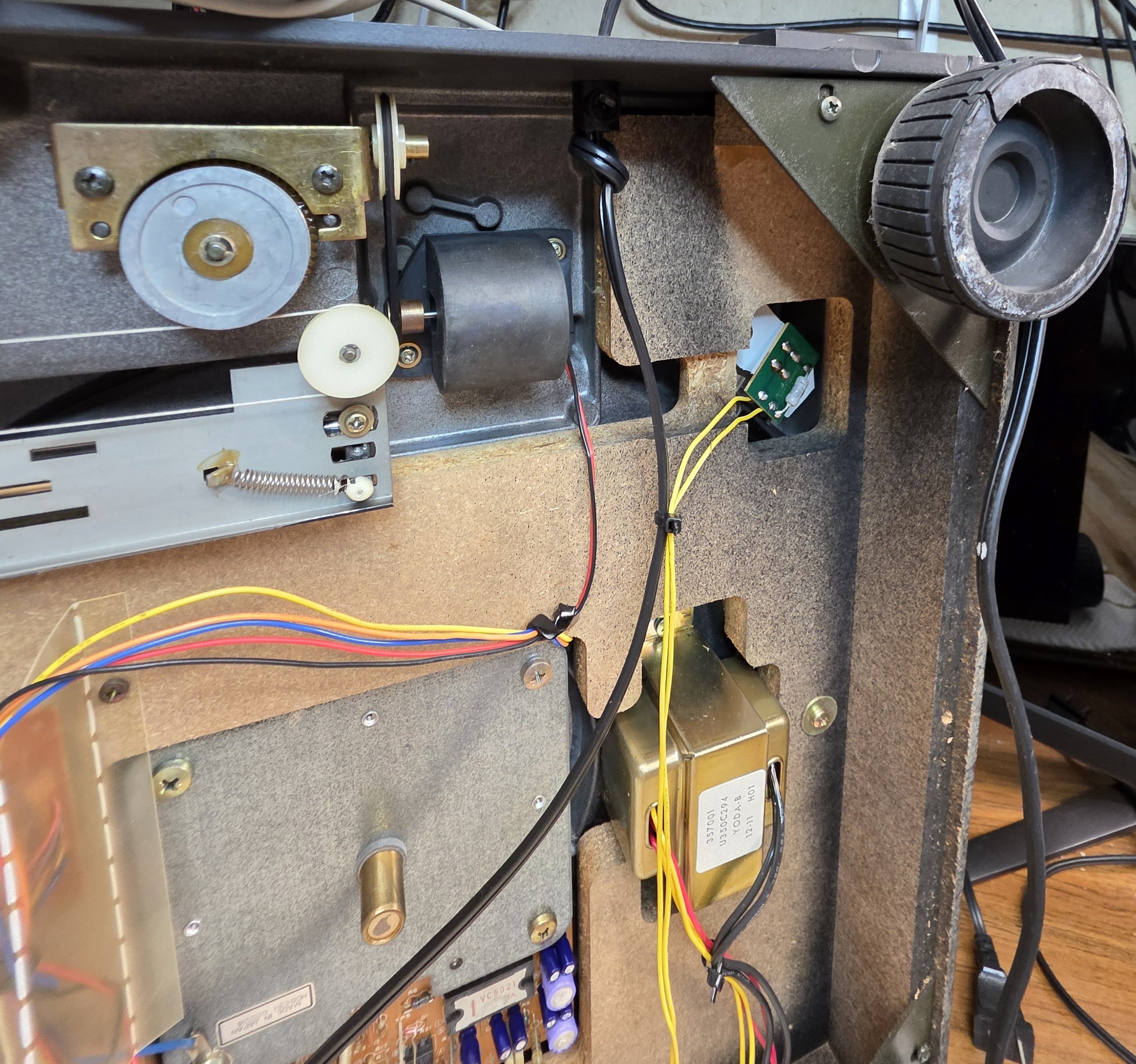

Underside. The downloaded SM is hard to read. Difficult to see exactly what they speak about removing.
I read all the bulbs were all supposed to illuminate with power on. Third bulb is good, no power to it, even when tonearm advanced to end of LP. Have to crack the manual.
Lots of parts to document removal of.
The plate has to come off. The plastic end of spring was just pressed onto a stud.
More to come...
Salk SoundScape 8's * Audio Research Reference 3 * Bottlehead Eros Phono * Park's Audio Budgie SUT * Krell KSA-250 * Harmonic Technology Pro 9+ * Signature Series Sonore Music Server w/Deux PS * Roon * Gustard R26 DAC / Singxer SU-6 DDC * Heavy Plinth Lenco L75 Idler Drive * AA MG-1 Linear Air Bearing Arm * AT33PTG/II & Denon 103R * Richard Gray 600S * NHT B-12d subs * GIK Acoustic Treatments * Sennheiser HD650 * -
SO that's where the screws are for the tonearm shaft.
Just slide it to one side then snug the set screw.
This is the downloaded SM I have to work with. No biggie, we'll figure it out.

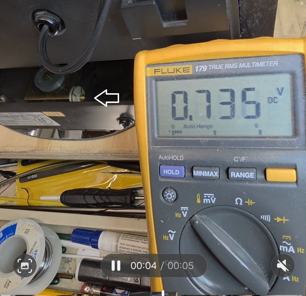

An overdue update. Back in Sept 2025, I tried the LT-30 one more time before Jay picked it up and it acted up. Sometimes it would play fine, tonearm would traverse normally. Sometimes it would hang and skip. If I lifted the tonearm and moved it simulating the stylus following the groove, the tonearm would traverse in the direction I moved arm. I tried diagnosing the problem and failed to find it. I ended up getting frustrated and left it sit. In a post I made at Tapeheads, someone mentioned it could be the horizontal motor.
I had tested the horizontal motor on a bench power supply, and it seemed to work normally. By hand it would spin easily. Power to the horizontal motor is controlled by two bulbs/photocells in the tonearm. When diagnosing the problem and today, I monitored the voltage to the horizontal motor and used a mirror to observe pulley movement. I had made some black lines on the white pulley to detect movement.
The voltage fed to the horizontal motor varies from .450vdc to a little over a 1vdc. The paddle and lights/photocells in tonearm determine how much voltage is sent to motor based on stylus tracking, how far the arm swings. What I didn’t do in my previous testing with the bench power supply was keep turning the motor on and off at a low voltage, like .450. Sure enough, the motor would stop at one point and would not turn with .450v supplied to it. If I bumped it up to 1v, it would turn.
Schools out and Jay had an LT-20 we could use as a motor donor so he stopped by today. We swapped motors and played the LT-30 for almost three hours. We turned it off, then back on. No failures so he went home with it. I hope I didn’t jinx us and he calls me tonight and says it still works.
The organ donor...the LT-20 has the vertical tonearm lift motor under the table while they used a smaller motor inside the tonearm of the LT-30.
The horizontal motor in the LT-30 sits in a rubber block.

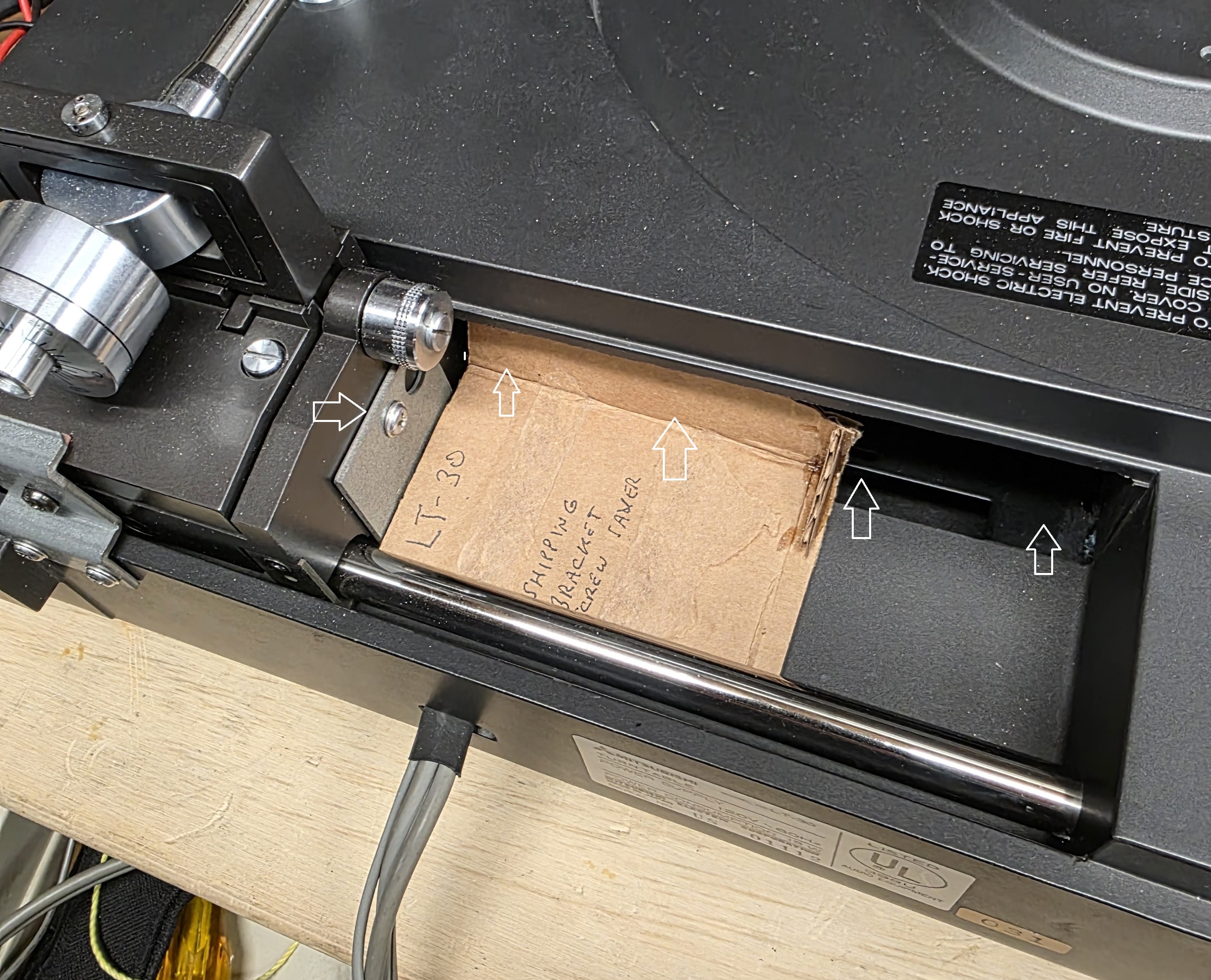

I forgot I made this shipping bracket screw saver last year. Today I dropped that tricky to get in and out screw into the slot that leads to inside, had to remove the baseplate to retrieve it.

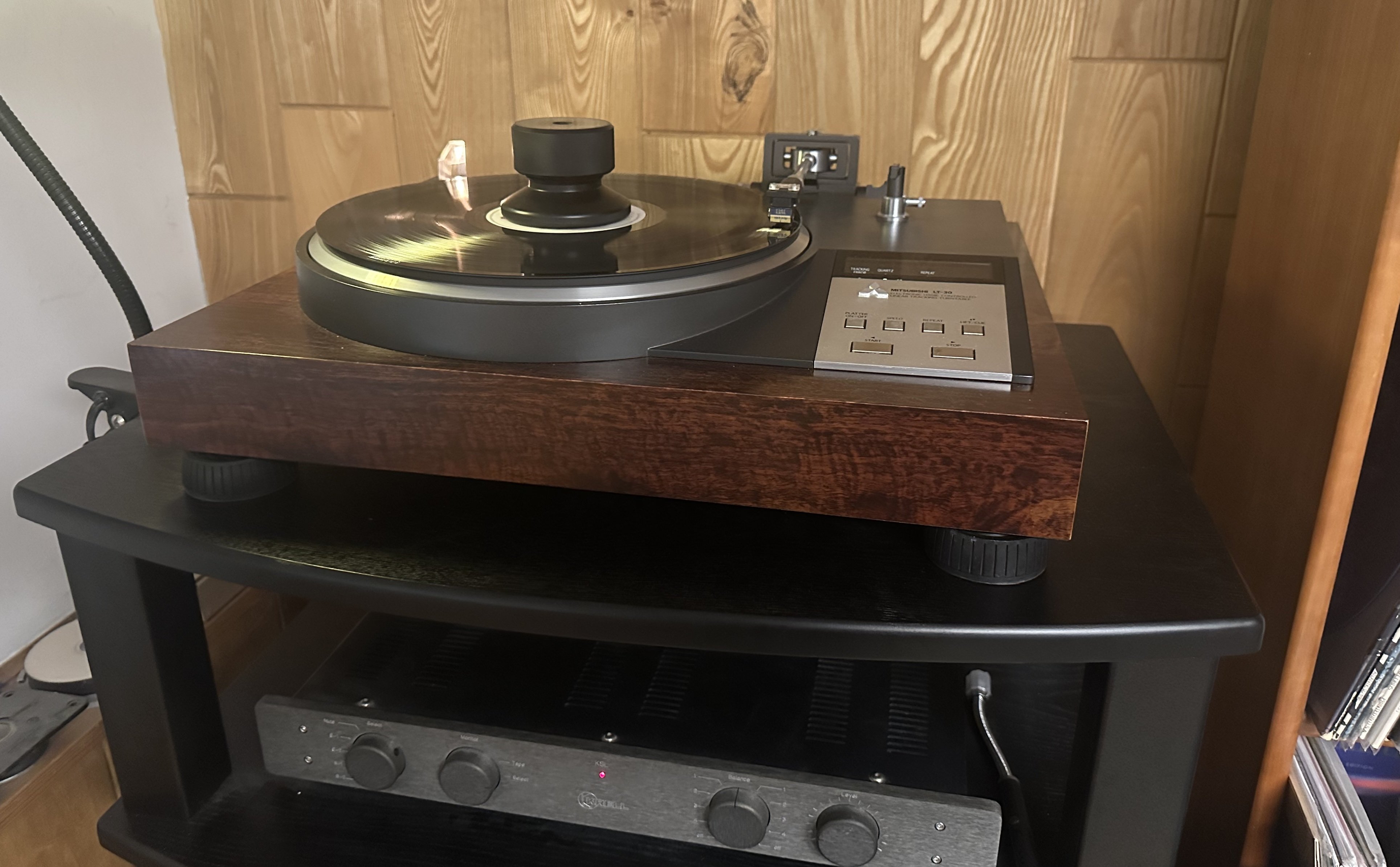

The LT-30 has made it back to my place and is continuing to perform flawlessly. 🤞
When I dropped this off at Rich's, I didn't intend for the puzzle it presented to be so difficult to solve... Like a car with an intermittent fault, this would've been simpler, perhaps, if it had a clear failure, but it kind of, almost worked!
Anyway, as anyone who has followed his build and repair threads has seen, Rich is a pitbull when battling a problem and he'd gotten at least a "best guess" as to what might be the fault--and it appears the motor swap has done the trick. It was somewhere in between comical and painful watching him as it was spinning vinyl on his test bench earlier this afternoon (see photo above)--He had the look of a man waiting for the other shoe to drop and for the tonearm to hang up yet again--I shudder to think of how many hours of grief this repair caused him. At least he's had the "simplicity" of reel-to-reel refurbing to turn to. 😂
So once again, Rich, thanks for your time and talents. As always you've been a generous friend and host; you've done a lot to help me along in my journey with audio in the years I've known you.
Probably should include an action shot, so here it is in situ spinning vinyl this evening at my place. And yes, below it is the Krell KSL I picked up from Rich several years ago, after he'd recapped it with typical care.
