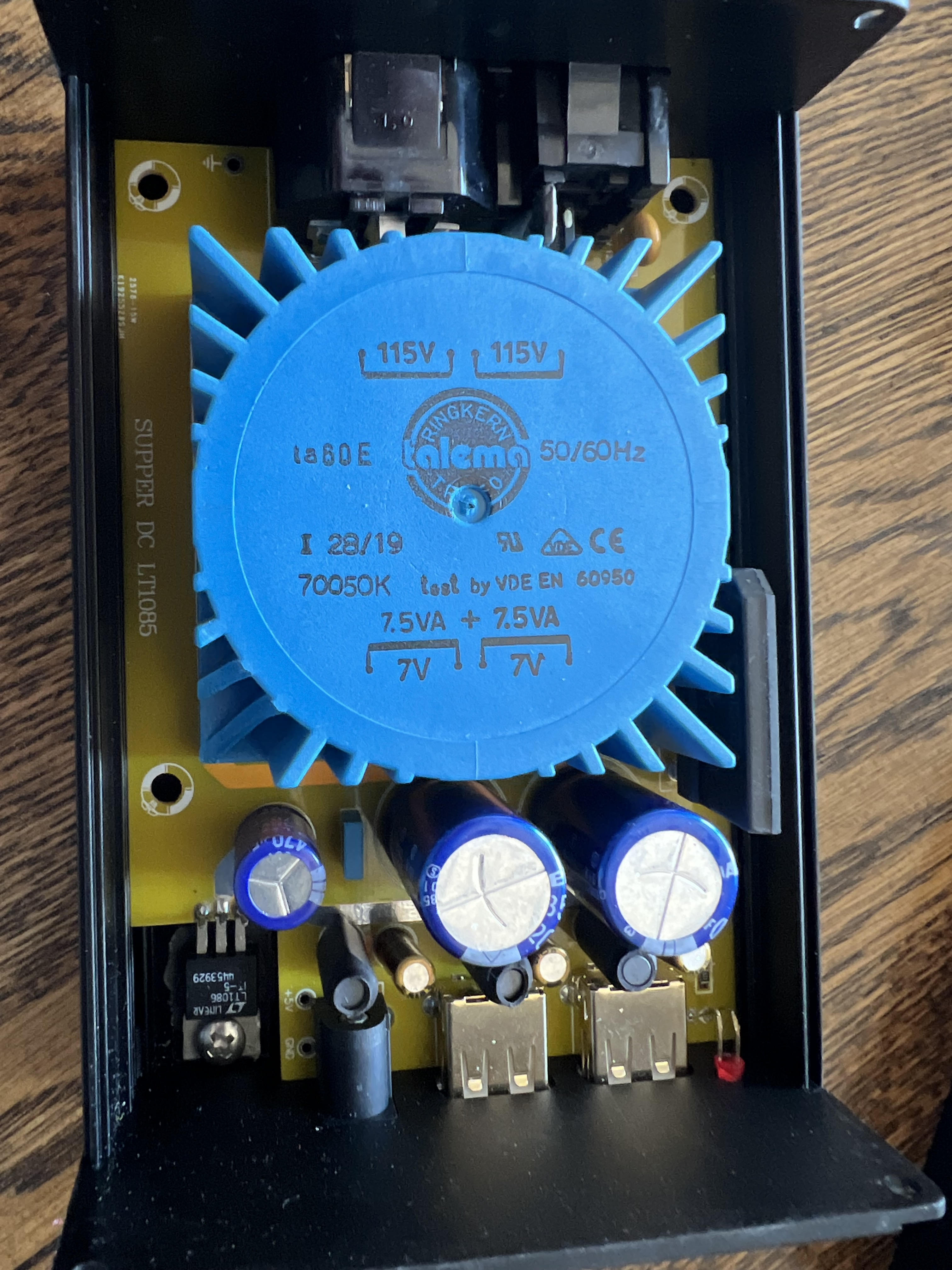

    If anyone is looking to buy a Chinese LPS, this place is fantastic!!!
    I've bought two Zero Zone brands and they are excellent and use quality parts. Super fast shipping. I use one 19V LPS for my Roon Nucleus One and a 24V LPS for my Pass Diy Korg Nutube B1 pre-amp.
    https://www.fyfaudio.com/

    heiney9 wrote: »
    Thanks! Looks much nicer than the ones I got, but I bought them as a lot of 3 for a steal, especially once you factor in shipping and taxes at that time.
    heiney9 Posts: 25,573
    The big difference is the ones you bought have a chip for voltage regulation whereas most, if not all, the FYF units have discrete voltage regulation.
    Their shipping is a bit higher, but I received both of my units within 5 days. In many cases that's faster than I can send letter across town with the USPS.
    Keep them in mind if/when you need a higher performance unit. I was really leary at first because I thought they might be like AliExpress, which can be hit an miss. I actually read a few recommendations off Audiogon. That's how I stumbled onto them.
    I will always buy my LPS's from them. They have lots of other parts, kits and fully assembled products.

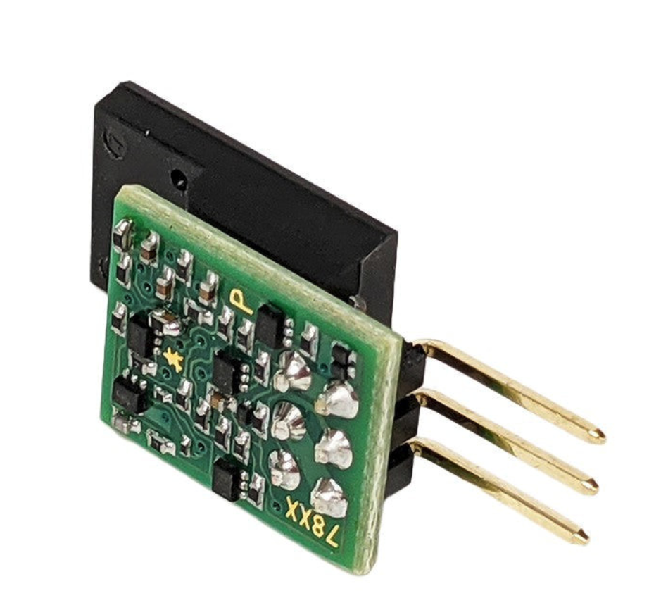

    heiney9 wrote: »
    I think you are confused by FYF's description of a "fully discrete" power supply. I looked at them and they ultimately uses the same TO-220 style 3-leg voltage regulators as the one shown by EndersShadow. I wouldn't call that a chip. It's a standard Analog Devices LT1086 1.5A voltage regulator.
    There are some "discrete voltage regulators", but I'd wager they are not included in any of FYF's kits or completed units because they are usually around $50 each and I don't see anything like that in their kit photos.
    This is what I'm talking about.
    https://sparkoslabs.com/product/ss1117xx-discrete-voltage-regulator/

    billbillw wrote: »
    heiney9 wrote: »
    Ok, voltage "regulator" was used to specifically. The LPS he shows is far more basic than the one I have here.
    Which has better filtering, lower ripple, over voltage, over current, short circuit regulation. MOSfet transistors in parallel.
    In his I see a single monolithic I/C chip that does it all. In mine I see a discrete circuit of components that do the same things, only probably to a higher degree since the parts that form the LPS are discrete and not reliant on a single monolithic chip.
    That was my only point. And they are very inexpensive for the quality and performance you receive. I was in no way trying to belittle his purchases, just showing in the future FYF supplies more bang for the buck. Buy from them or don't.
    https://www.fyfaudio.com/products/100w-hiend-version-linear-power-supply-for-audio-device-dc19v-5a-with-emi-filter?VariantsId=11009
    https://www.fyfaudio.com/products/50w-linear-power-supply-audio-with-protection-dc5v-9v-12v-15v-16v-18v-19v-20v-24v-28v?VariantsId=10843

    heiney9 wrote: »
    Those are for sure nicer than what I got and the price for the second isn’t too bad even with shipping.
