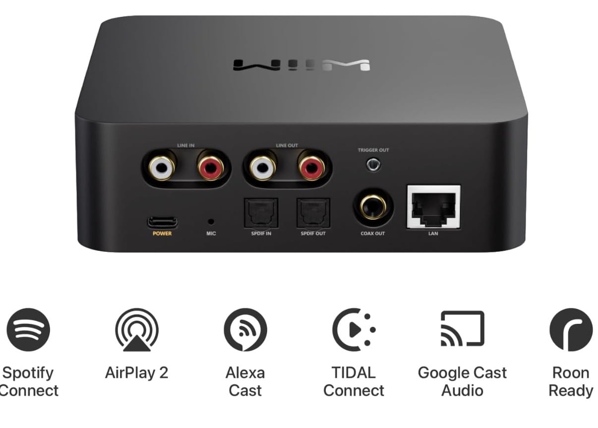

I have a PS Audio Gain Cell DAC that I purchased in the forum, and a buddy of mine is considering its purchase. He mostly streams, which I was going to get into but have not yet done so, and thus I’ve never even used the PS Audio DAC. He has a Wiim Pro Plus and a Marantz PM-10 integrated amp. The amp only has analog inputs if I remember correctly. Really nice amp. Not familiar with the Wiim or its outputs. My question is given his equipment, what would be the optimal way to hook up the PS Audio DAC for an audition? Thanks.

    Don, it appears that DAC has both RCA and XLR inputs and outputs. Same with the Marantz. Why wouldn't that work?

    I would go coaxial out from the Wiim streamer to the Gain Cell DAC then analog out from the DAC to the Marantz PM10.
    The power supply on the Wiim Pro Plus is a pretty cheap design. The Wiim Ultra is better.

    Or you can go USB wiim out to dac in USB

    A Ifi wall wart makes a difference as does a linear PSU, neither are that pricey.
    I run a WiiM Pro Plus with a Chinese linear PSU direct to my Pathos and it sounds quite good.
    Also like the EQ it has built in but I’m sure there are minor compromises in making but I’m ok with them.
    The WiiM has analog and digital outs, so I’d go with whatever digital out you prefer (spdif or coaxial) and then not use the EQ.
