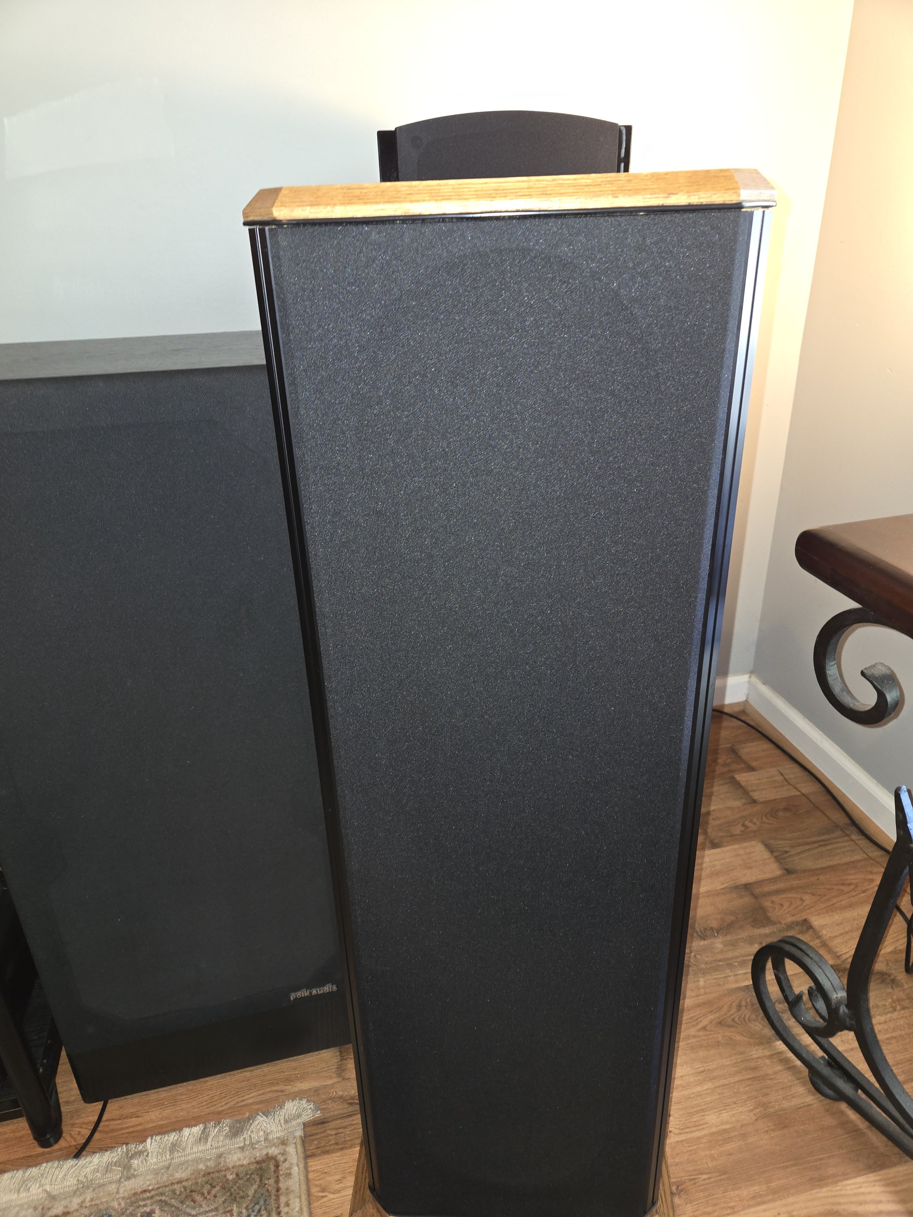

    Still a struggle to get photos, but you get the idea...
    I was surprised that these are overall larger than my Revels. They are a tad bit shorter, but take up more floor space.

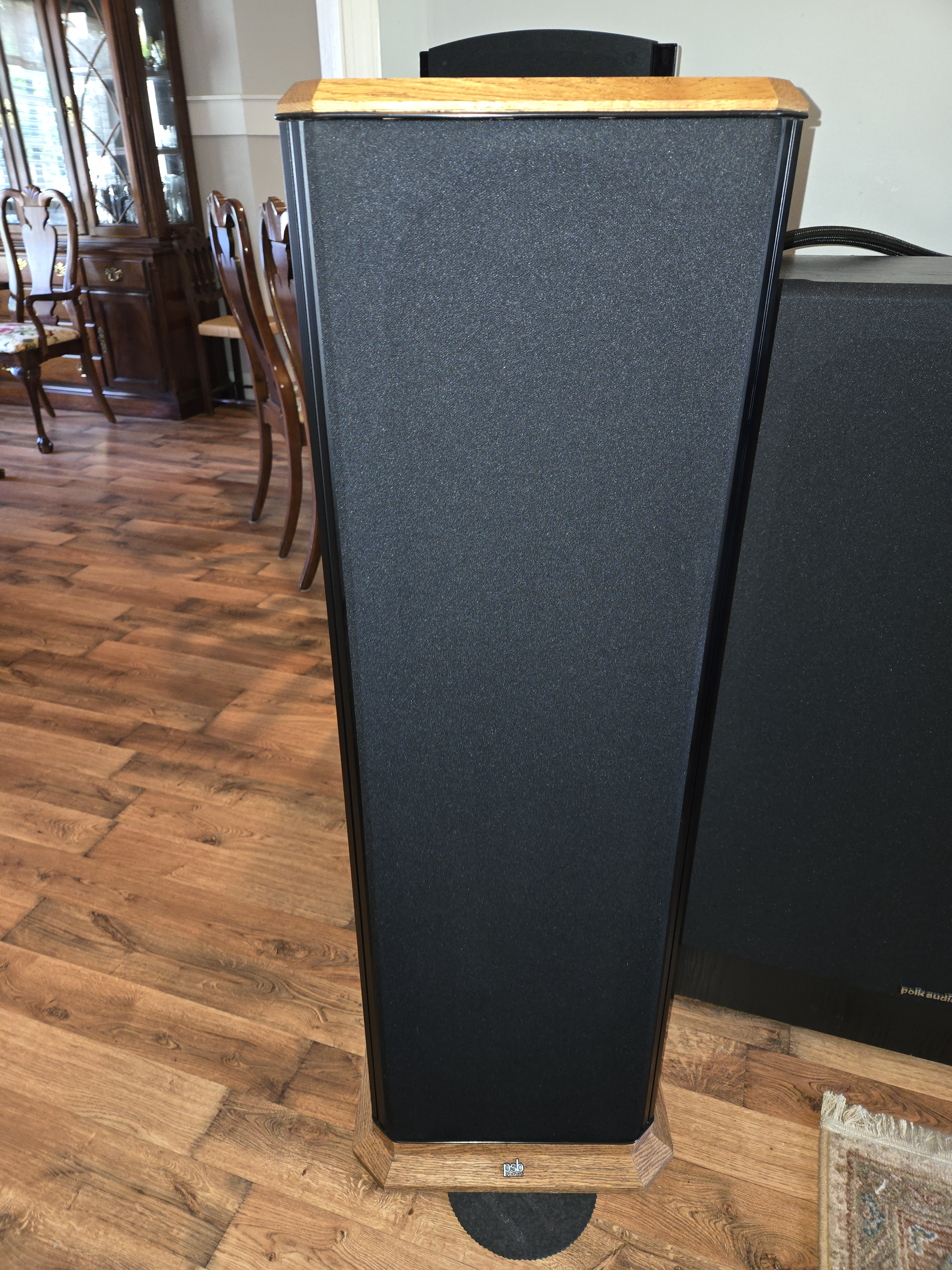

    edited May 2
    I thought I might need to re-fabric the grills on the PSB because of pet hair, stains, and smells, but some vacuuming, careful use of Woolite in a damp sponge sponge and a clean rinse rag did well. A couple of sprays of febreze also helped. These are actually still in really good shape. Promise, these are the last pictures... :D

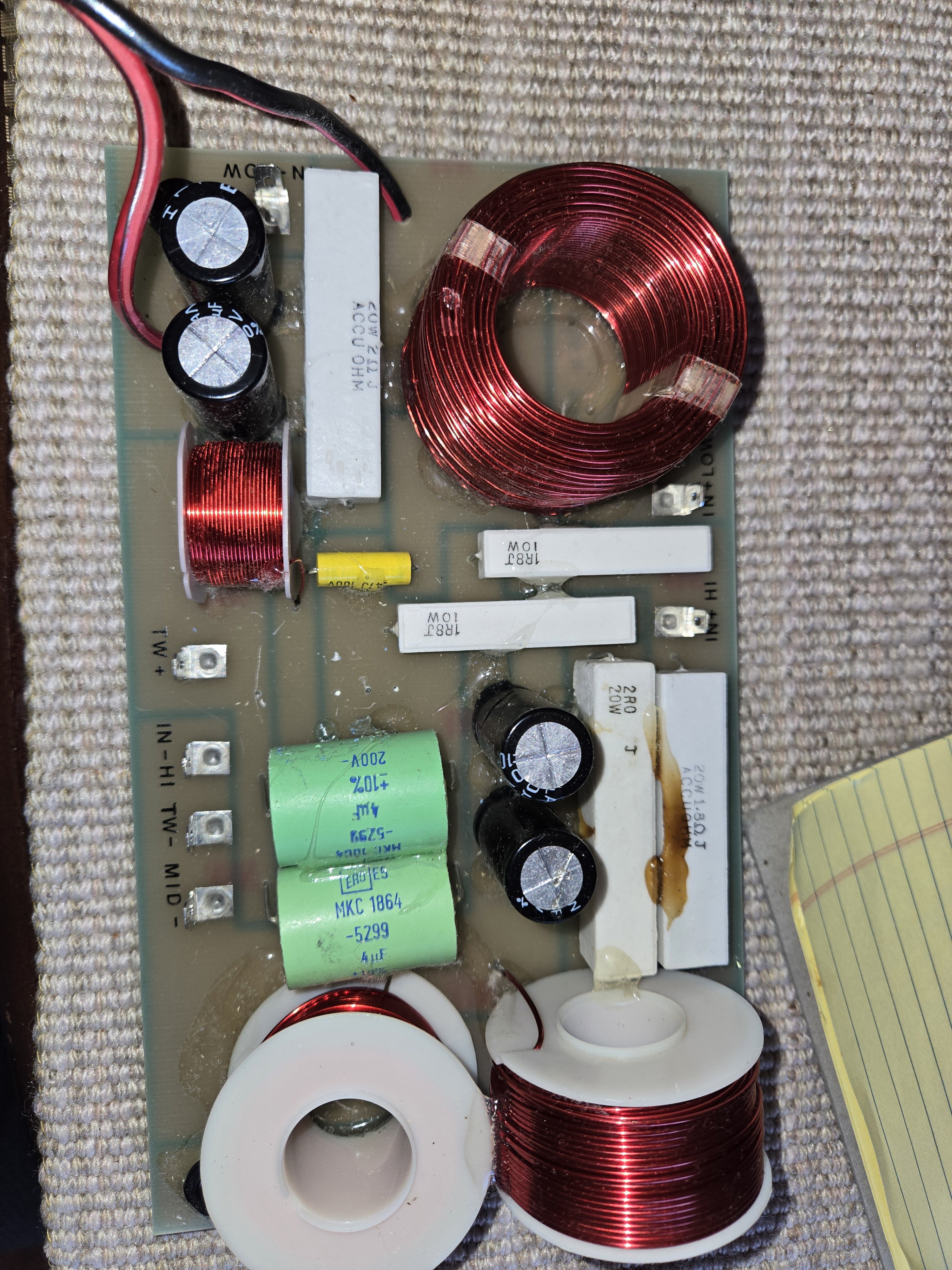

    I ordered parts today to do a crossover refresh. This design has four 100uf non-polar electrolytics in each board. I'm not even contemplating a swap to a metalized poly for those. Just new Jantzen 5% axial non polar electros. Some Mills resistors in the tweeter section, Jantzen 20w sand cast for the rest, and some clarity caps for the midrange shunt, which might not even be worth the upgrade over electros, but at least those are small value and can fit, unlike the 100uf, which would be more than 2" diameter. At the last minute, I did add a couple Clarity SA for those yellow .47uf poly caps.
    The mid-range shunts caps are hiding behind the inductor to the bottom of the photo.
    VR3 Posts: 29,740
    edited May 2
    When you rebuild the crossovers go to heat sink mounted resistors for the 20 watt guys and don't look back
    billbillw Posts: 8,219
    edited May 2
    VR3 wrote: »
    Well, order already in. Do you have any links to what you are thinking? Maybe if I refresh them again when I'm 75 I'll consider it. If the values were available, I probably would have tried the Dayton Precision 20w this time around.
    VR3 Posts: 29,740

    Those 20 watt stock are already getting hot, the discoloration in the glue being the tell.

    I plan to mount the 20W with an air gap, which is also how the later models were assembled. Those powertron are pricey. Not putting that kind of money in these inexpensive vintage speakers. I'm trying to keep the sound close to Paul's original intentions, which is good. It's good to know those metal foil options are there if I run into problems with the resistors again.
    VR3 Posts: 29,740
    I would recommend cutting the leads off the old resistors and mounting the new ones on top of the old ones
    Ok. Good idea. More thermal mass.
    @VR3
    Parts finally came today after a 10+ day hold at customs. Trey, do you have any "best practice" ideas for replacing those radial 100uF electros with the larger axial Jantzen nonpolars that I got? I figured I would solder and heat shrink an insulated extension on one end of each axial and have the other end tight on the through hole and glue them vertically. I don't think there is enough room to have them horizontal on the board. I know...you wouldn't be using nonpolar electros, but you know how huge, and expensive 4 x 100uF Clarity Caps would be.
