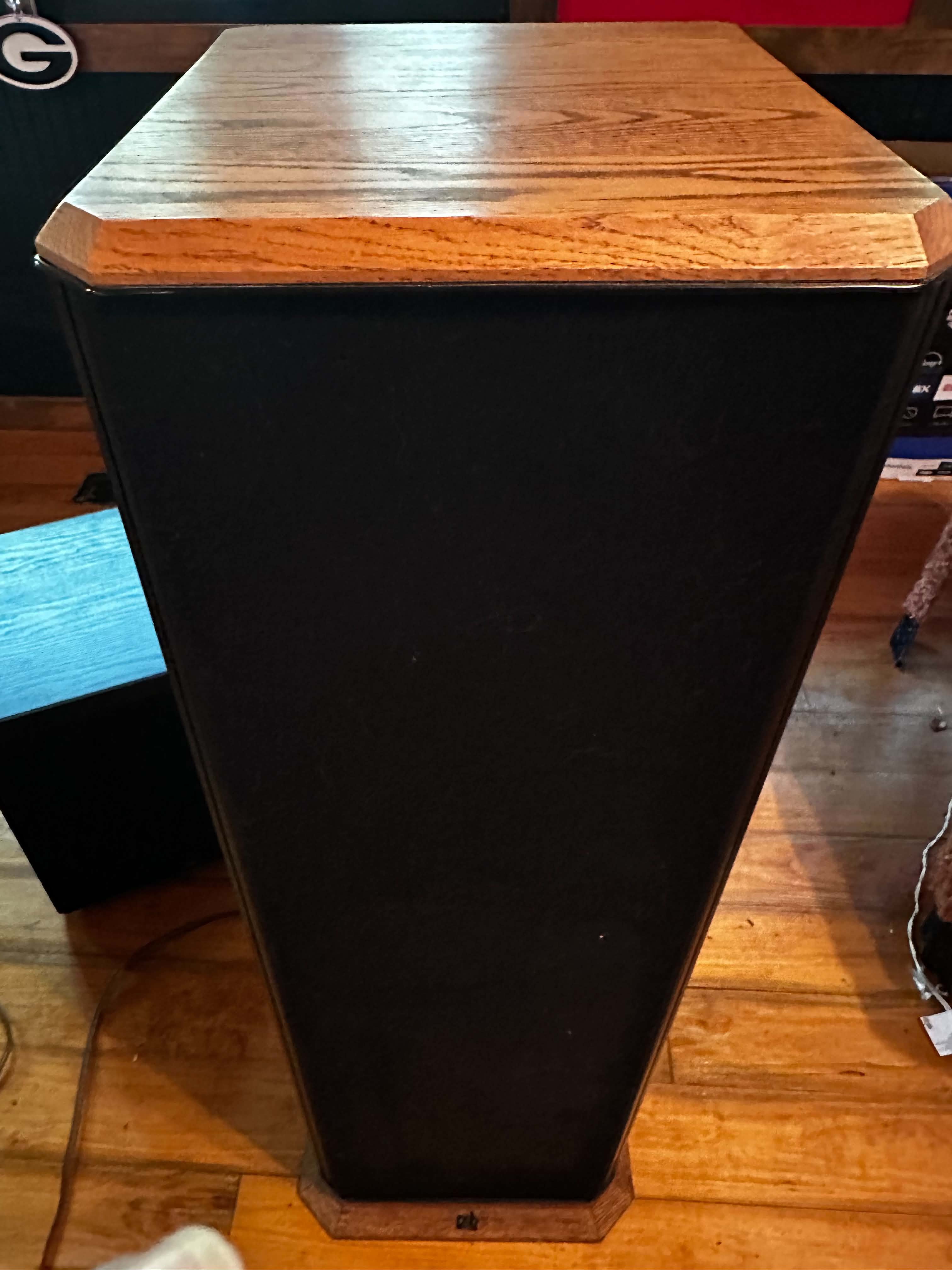

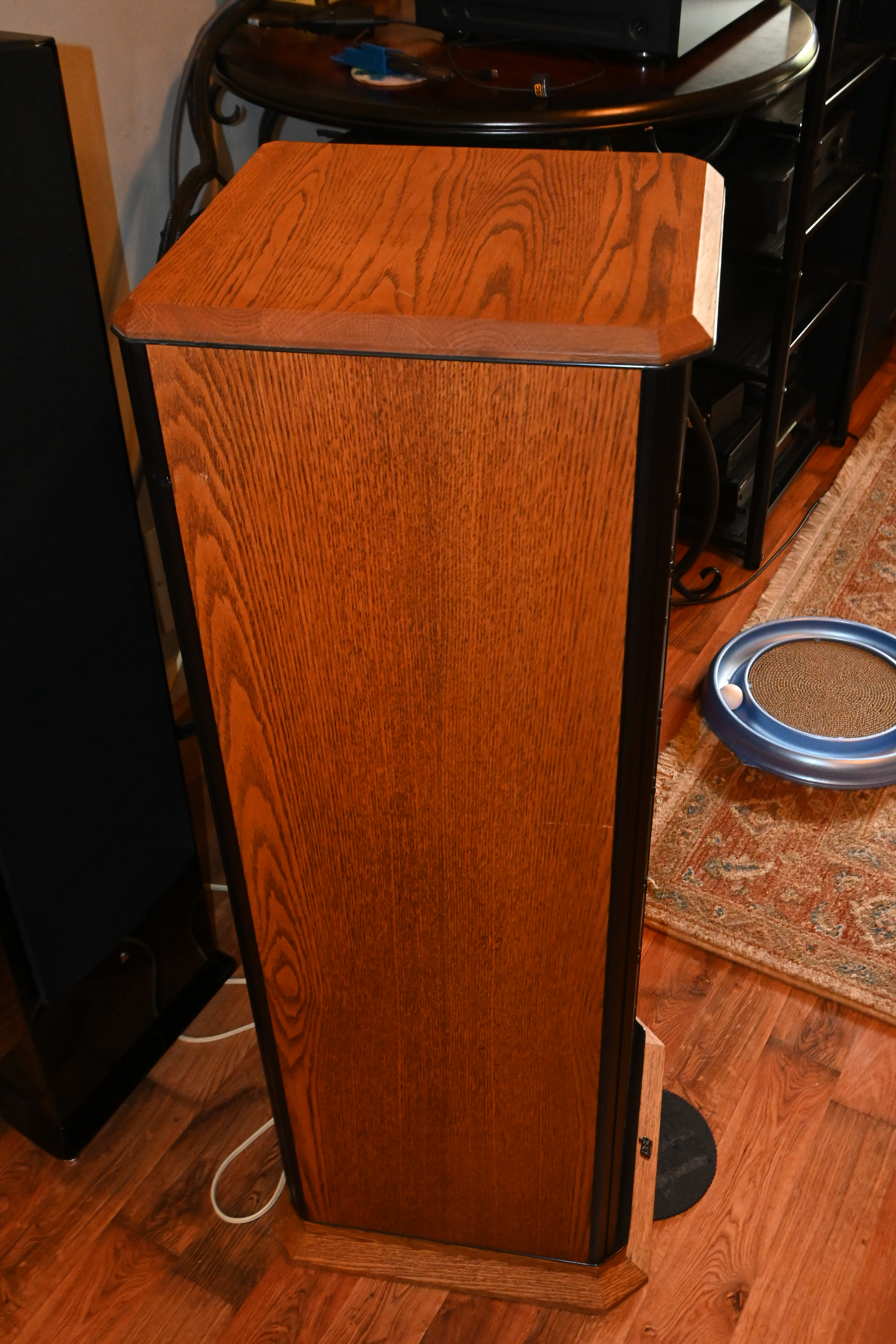

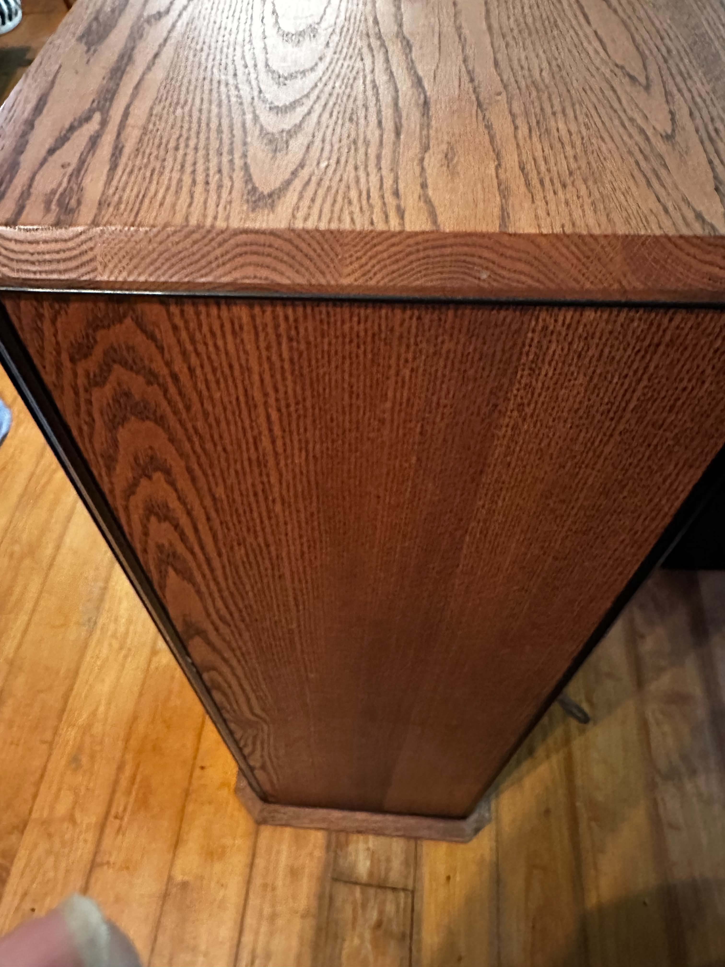

    This is a speaker that I've been wanting to hear for more than 20 years. Before I had my Sony SS-M9, or Mirage M3, or SDA-1C...I saw one pair listed around Atlanta and I didn't jump on it and have sorta regretted ever since.
    I haven't been looking super hard, but I really hadn't seen any come up for sale near me...until now. It's a bit of a drive, but should be less than 4hrs round trip.
    Am I crazy for getting a pair of these really just to "try" out? I already have two pairs of full range of speakers awkwardly next to each other in the living room. I don't really have room for 3 pairs, so something will have to go to another part of the house...or get sold. I understand this probably won't even come close to the refinement of my Revels, but most people that have lived with them all seem to say, its just a fun speaker to listen to. A sort of Mustang GT of speakers vs a refined Porsche type speaker that the Revel is. I know a few old timers here had the Gold or the Gold-i at one point. Not sure if any of them are still around. I figure, I can resell if I don't like them. Hoping it isn't a wasted trip to find something wrong with them. I don't think the seller really knows much about them. Perhaps they were inherited or something? Anyway, this is what makes the hobby interesting.
    billbillw Posts: 8,112
    I'm a sucker for real wood. I've grown kinda bored with my plethora of all black speakers...Revels in piano black, SDA2B studio black, RTiA7 black, R200 black...you get the picture.
    These look pretty nice in the wood department. She sent me photos of all sides and they are clean looking. Someone clearly never put a potted plant on top of them.

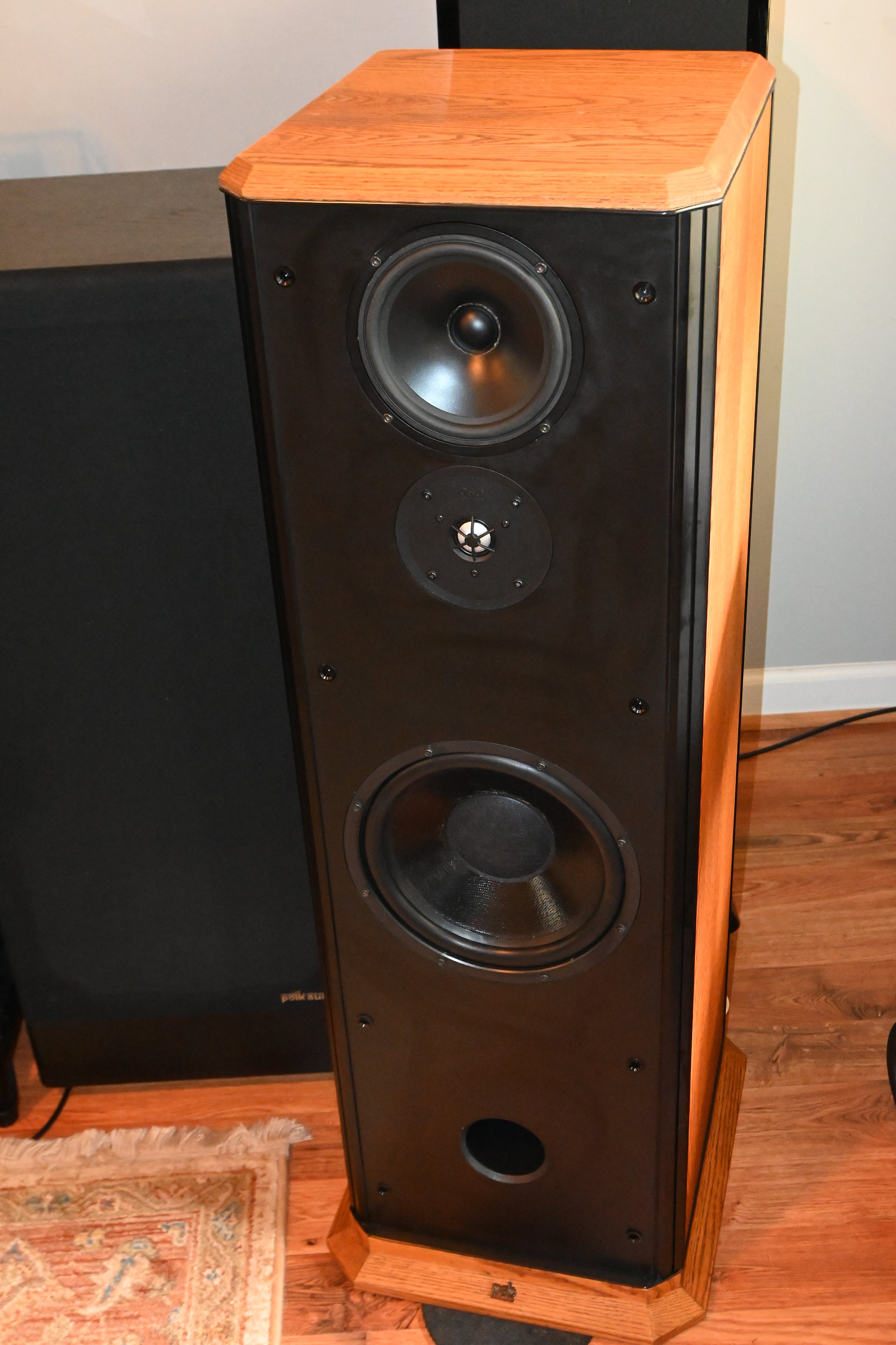

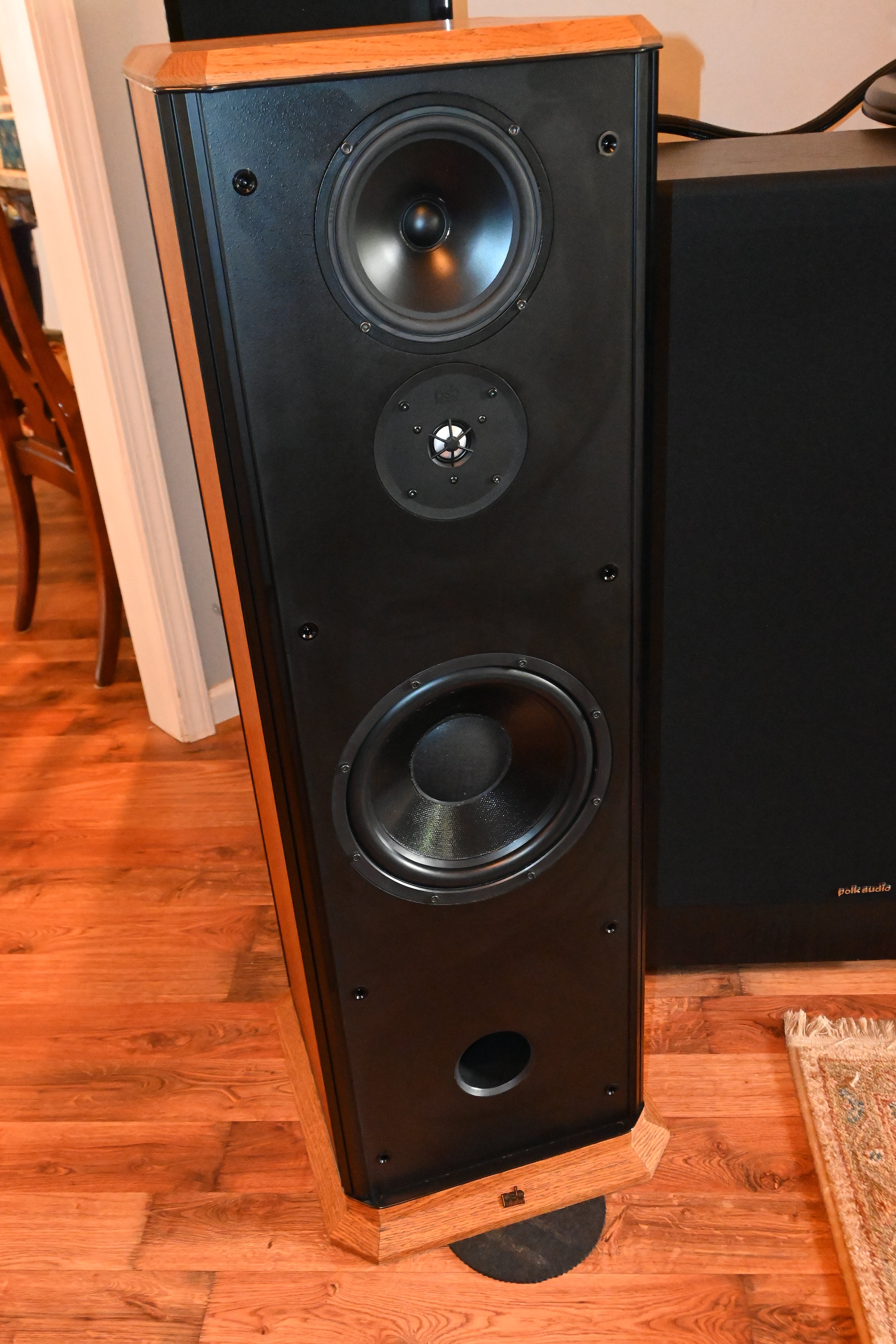

    Still a struggle to get photos, but you get the idea...
    I was surprised that these are overall larger than my Revels. They are a tad bit shorter, but take up more floor space.

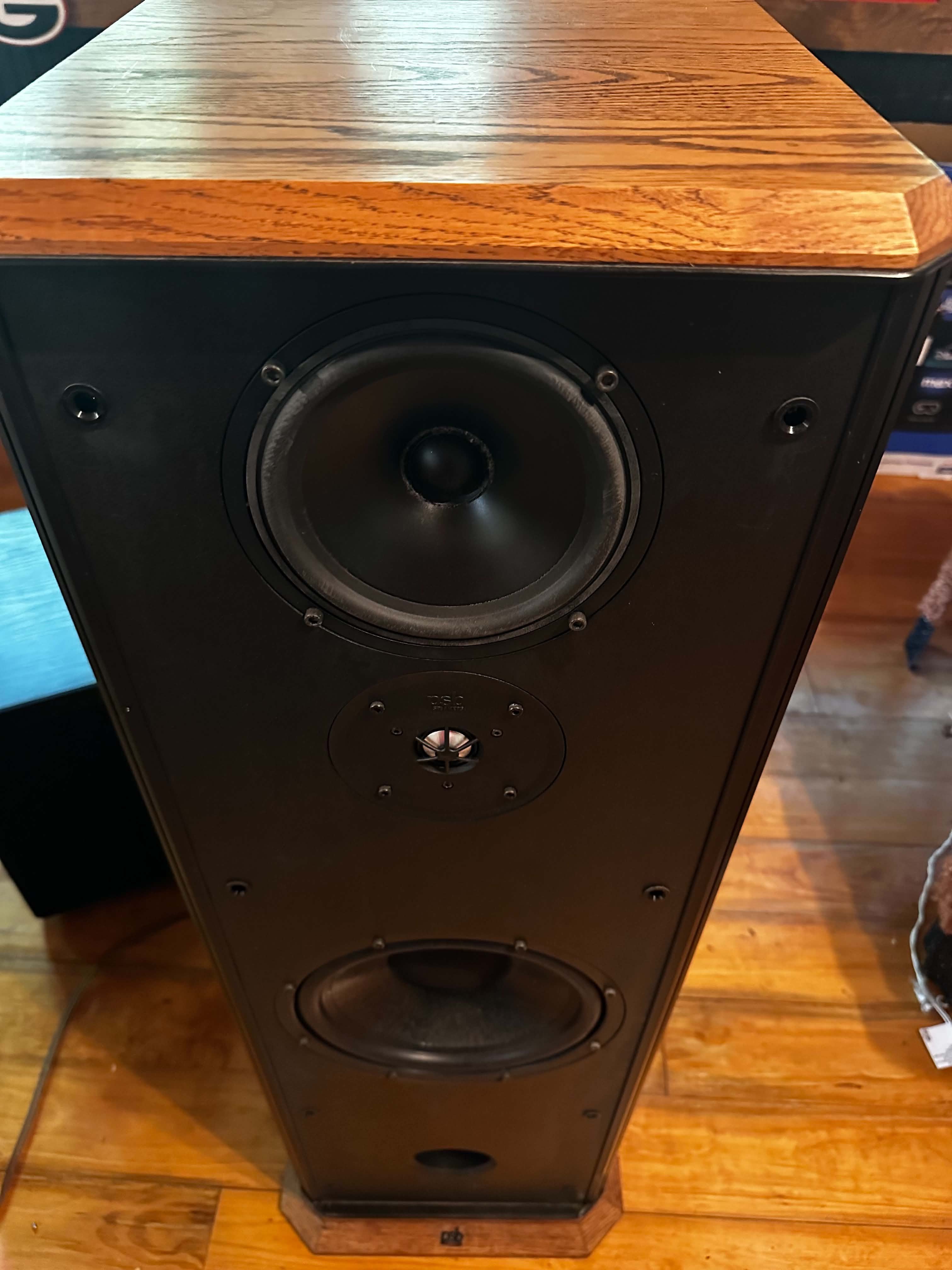

    I thought I might need to re-fabric the grills on the PSB because of pet hair, stains, and smells, but some vacuuming, careful use of Woolite in a damp sponge sponge and a clean rinse rag did well. A couple of sprays of febreze also helped. These are actually still in really good shape. Promise, these are the last pictures... :D
