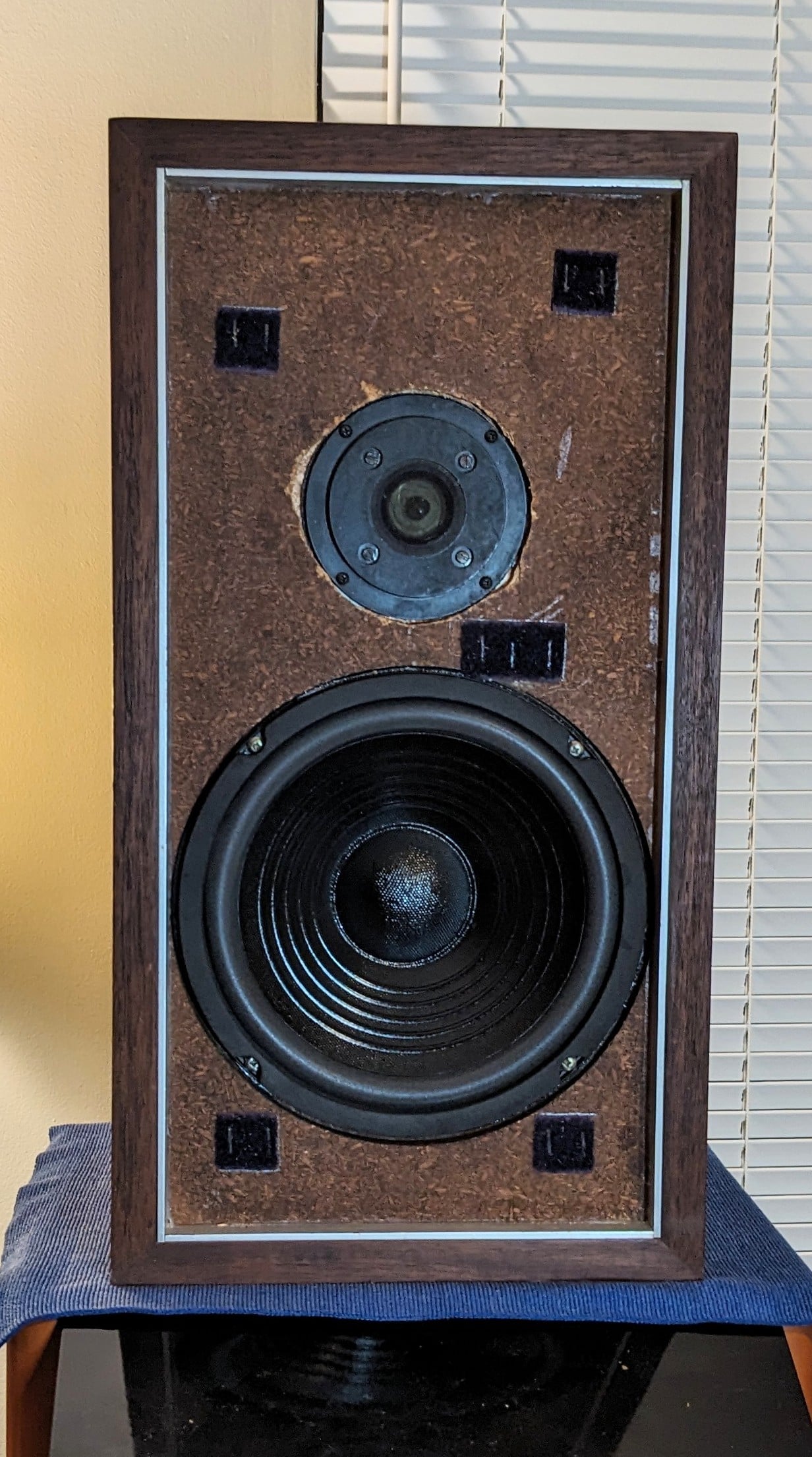

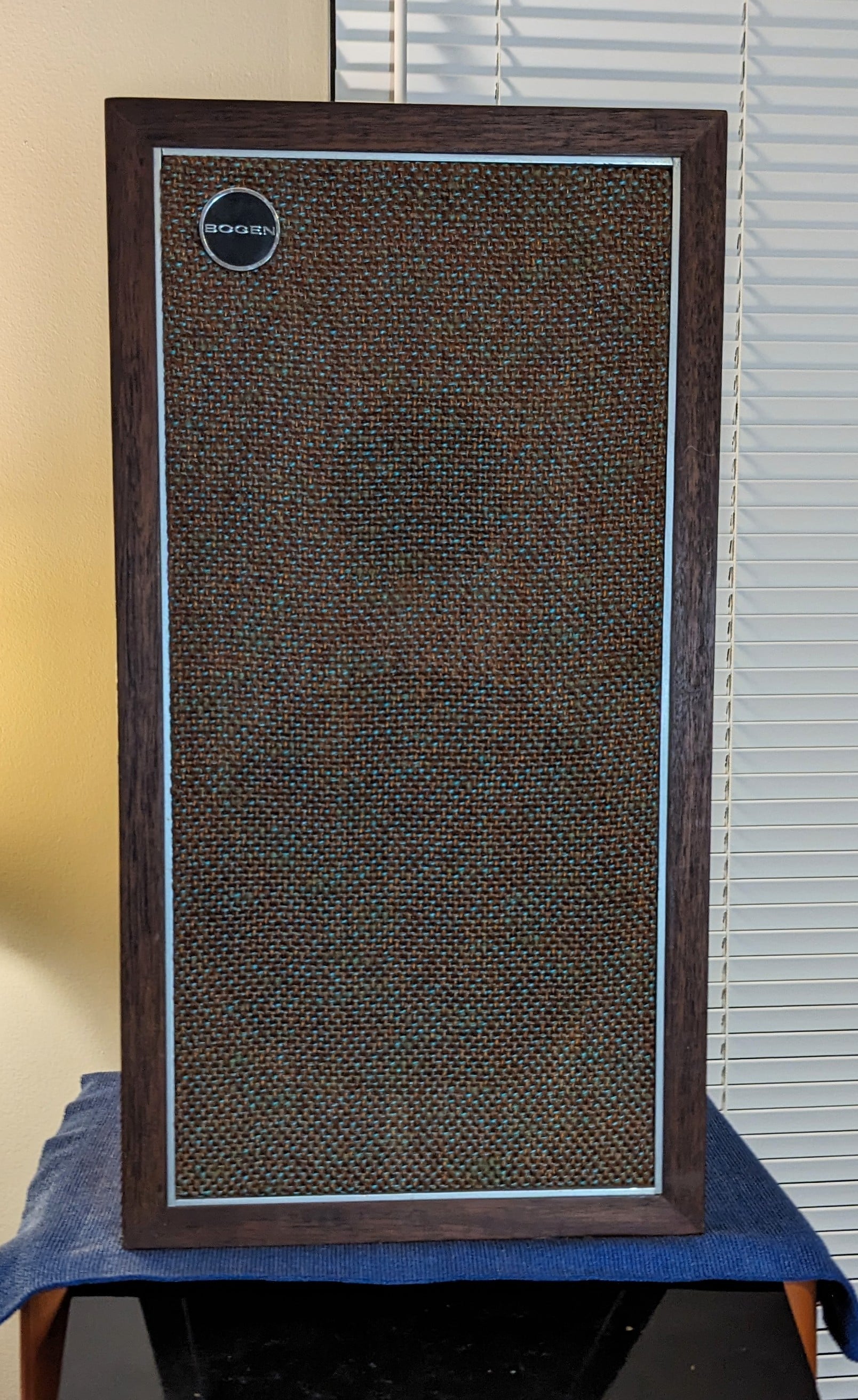

I have a pair of very vintage Bogen LS20 speakers from my dad's collection that I want to refurb. Before you ask, "why bother?", this is primarily for wifey, who loves the vintage look, especially the grill cloth fabric. The cabinets are in good shape, along with being quite solid at 3/4" thick. The turquoise thread accent is really nice (and better in person), along with the metal strips that frame the grills.
I agree with her on the looks, but not the sound...even under the best conditions. In one of the speakers, the woofer voice coil is rubbing, and the paper tweeter cone has a tear. So, I'm considering replacement drivers, and a new two-way crossover. The original woofers are 8", and have DC resistance of 3.5 ohms. The tweeters are 3.5", and are at 8.5 ohms. Cabinet volume is about 0.81 cubic feet. These are sealed/acoustic suspension speakers.

Love the vintage resto-mods. Looks like real aluminum strips/trim in the baffles?

Thanks for the responses. Lots to consider with both drivers and crossover. Here's a pic of the original crossover:
Looks like an air-coil inductor, and not sure about the capacitor. The L-pad variable resistor is clearly corroded, so need to evaluate that further.

After digging through my Dad's collection, I found a pair of Philips AD 0160/T8 dome tweeters with good continuity, and then ordered some modern 8" woofers from Parts Express. Enlarging the baffle cut-outs for the vintage Philips tweeters was a challenge (free-handing with a router), but luckily they are hidden behind the grill cloth. The new woofers were basically drop-in replacements.
The resulting speakers sound very nice. I think they will more-than serve their purpose in a future small living space for kitchen and entertainment, with a vintage flair.
