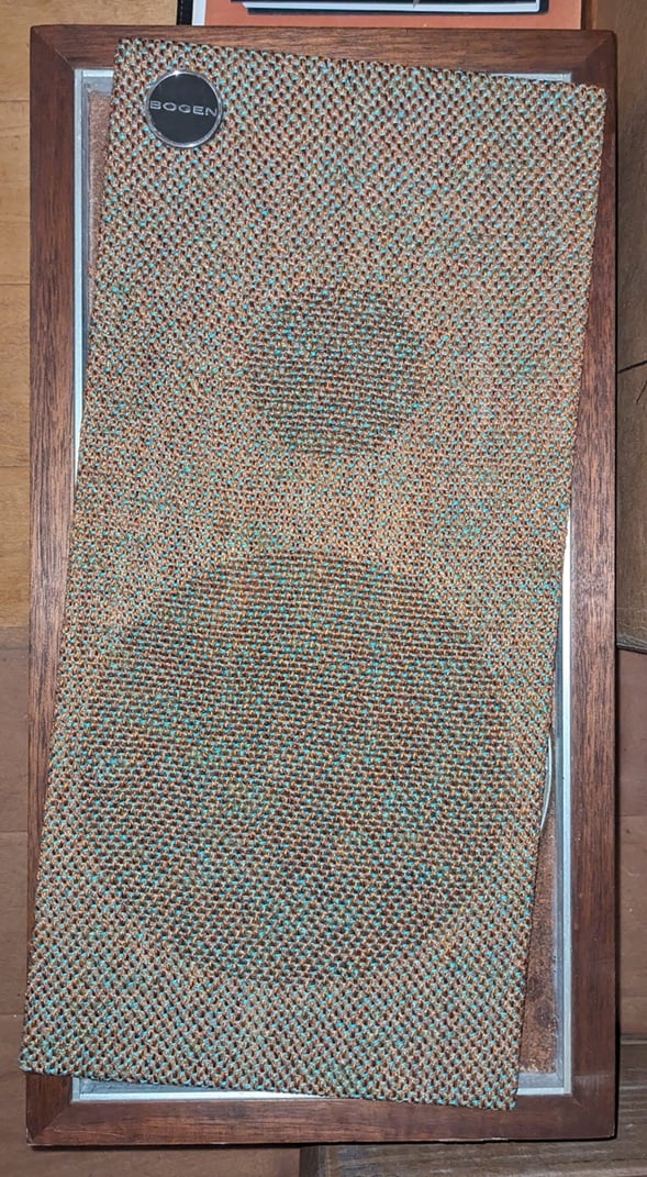

I have a pair of very vintage Bogen LS20 speakers from my dad's collection that I want to refurb. Before you ask, "why bother?", this is primarily for wifey, who loves the vintage look, especially the grill cloth fabric. The cabinets are in good shape, along with being quite solid at 3/4" thick. The turquoise thread accent is really nice (and better in person), along with the metal strips that frame the grills.
I agree with her on the looks, but not the sound...even under the best conditions. In one of the speakers, the woofer voice coil is rubbing, and the paper tweeter cone has a tear. So, I'm considering replacement drivers, and a new two-way crossover. The original woofers are 8", and have DC resistance of 3.5 ohms. The tweeters are 3.5", and are at 8.5 ohms. Cabinet volume is about 0.81 cubic feet. These are sealed/acoustic suspension speakers.
