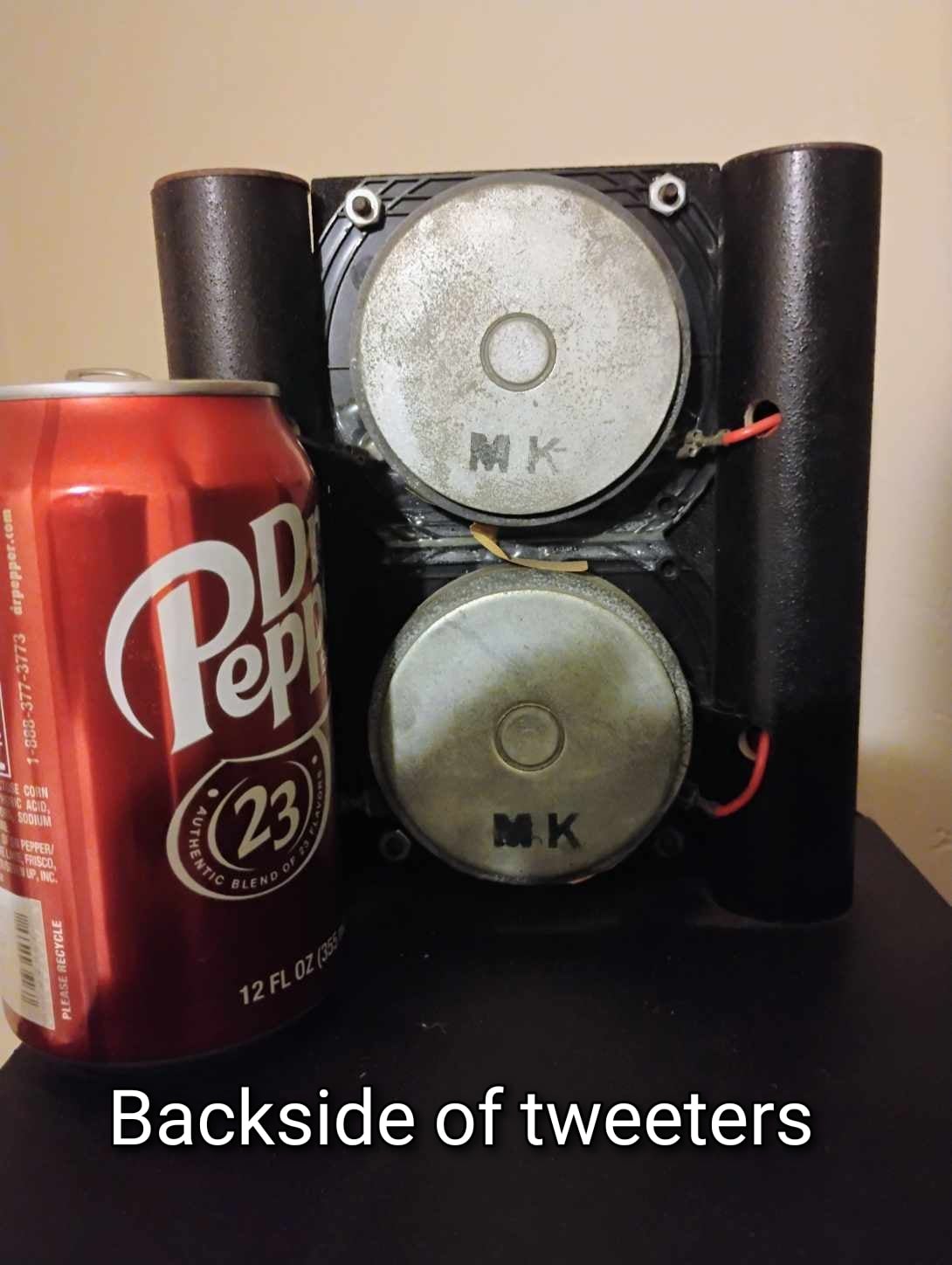

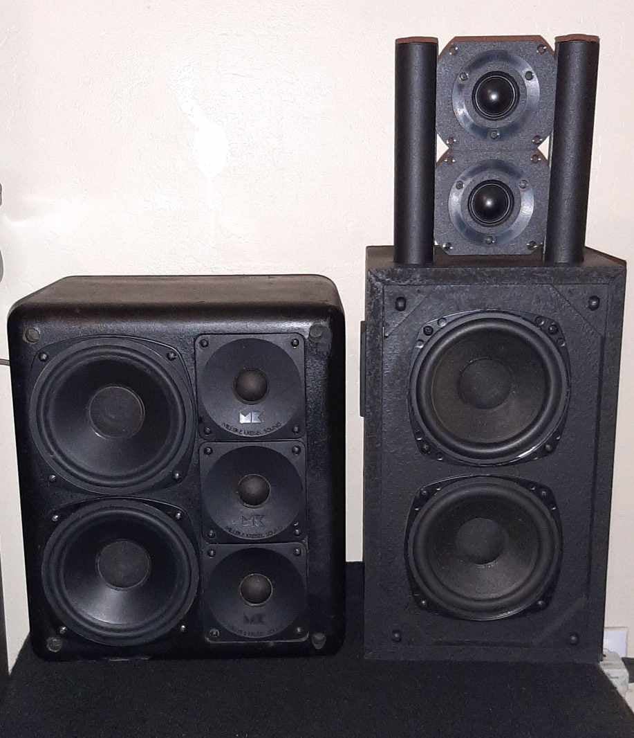

    Oh and I'm getting original cable with it positively. My friend who's selling or sold them to me is very knowledgeable in audio equipment I'm VERY fortunate to have met him. He has a pair of speakers that remind me of the SDA STS 1.2 at least in physical size. He has the Mirage M1si. I know completely different bipolar I mostly meant size. At least as far as from what I have read. I absolutely loved the sound of the Mirage I think they are the BEST speakers I've ever heard. Today is the 17th and I get them on 20th I can't wait. I feel like kid waiting for Christmas! I'm also very appreciative to you all here everyone has been informative and polite. A while back I joined a Facebook group for vintage Infinity speakers and I had joined because I had just bought a pair of Infinity Overture llls and wow was that a rude bunch of people! I like to experience different brands and models of speakers . I liked the Overtures but my biggest complaint was the highs I like lots of highs and they had one small tweeter. While I had them I bought a pair of M&K SX-4 which had 2 huge tweeters mounted on top of speakers and I fell in love with the highs so much better so then I bought a pair of M&K S100Bs which had 3 tweeters. So I had 5 tweeters on front left and right I ran both pair for fronts on A/B setup. I love lots of highs and with both of those up front I had plenty the motor for tweeter looked like it belonged to a mid or small sub. I'll post a pic in case some you haven't seen. I was told to expect even more highs from these !bw4mr0cpudjk.jpg
