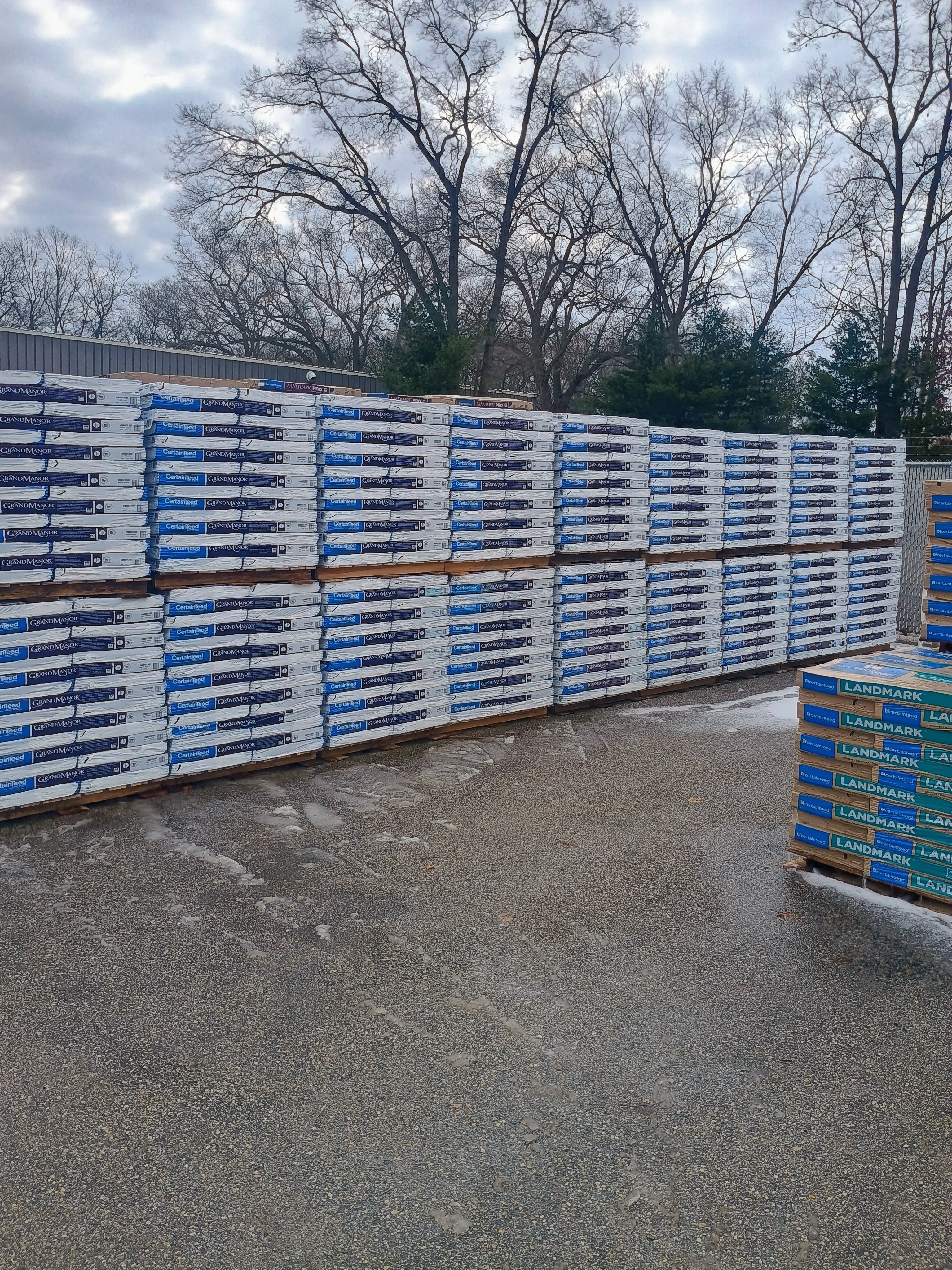

    These are the shingles for a new house I'm about to start roofing, only about 600 bundles.
    pitdogg2 Posts: 27,639
    That will get you a couple of new tubes.....
    Viking64 Posts: 7,722
    Damn, I would be an invalid too if I installed that many shingles.

    Viking64 wrote: »
    It's about 120 square of shingles, but these shingles are 5 bundles per square.There is also some small copper roof areas.

    invalid wrote: »
    Viking64 wrote: »
    FWIW I am glad I'm not paying the property taxes on that home.
