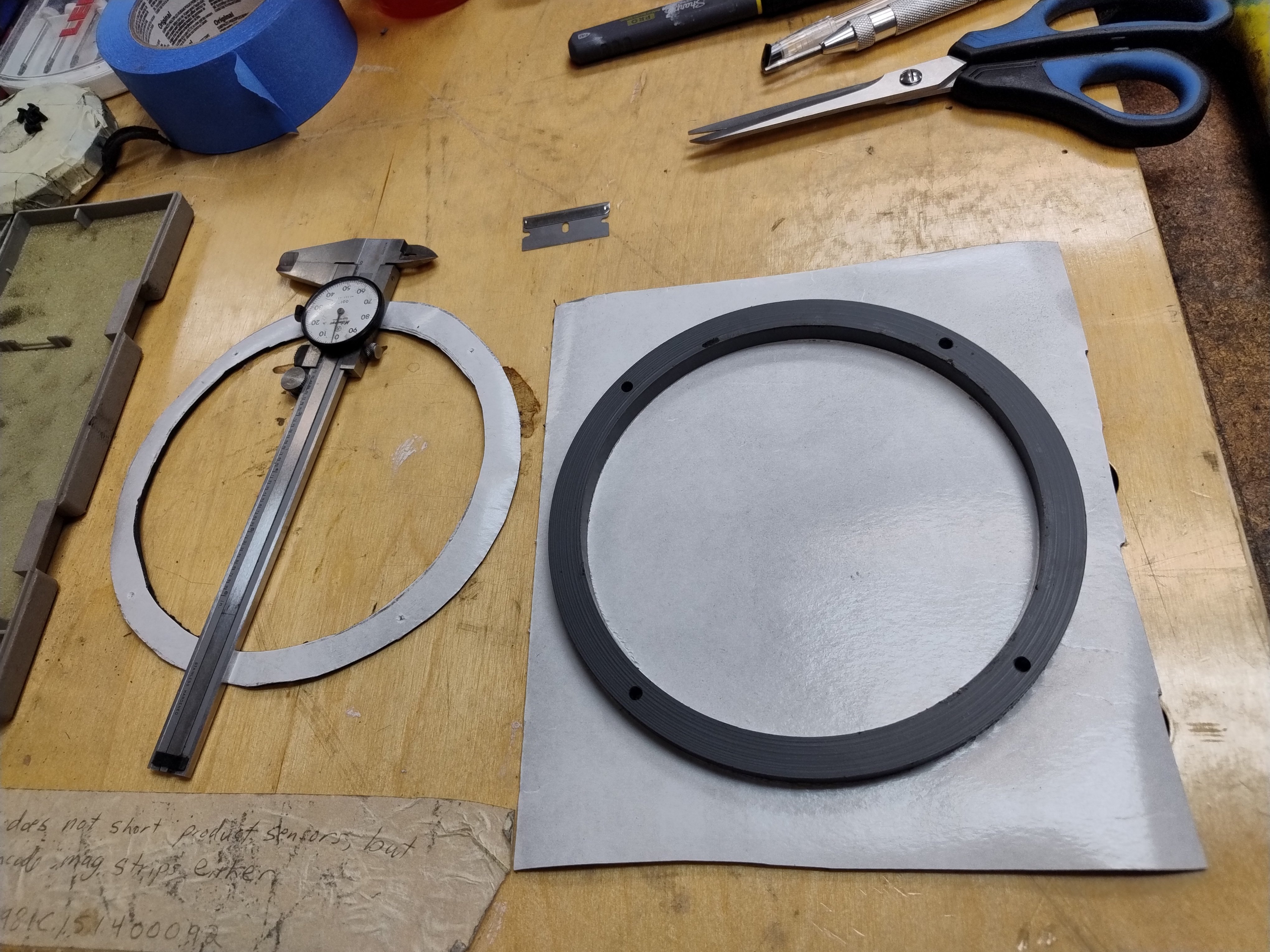

    On page 2 of the glue pic, It is most important that the glue completely surrounds old woofer, tweet, and port hole. The bridge between woofer and tweeter is rock solid on the previous set now as I checked with a screwdriver on the re-foam process. The edges alone would hold the plate with no issue as this glue is mega strong.
    That said, I am taking your advice and removing the old woofer instep/base on this set as I know that the bridge will still be rock solid.

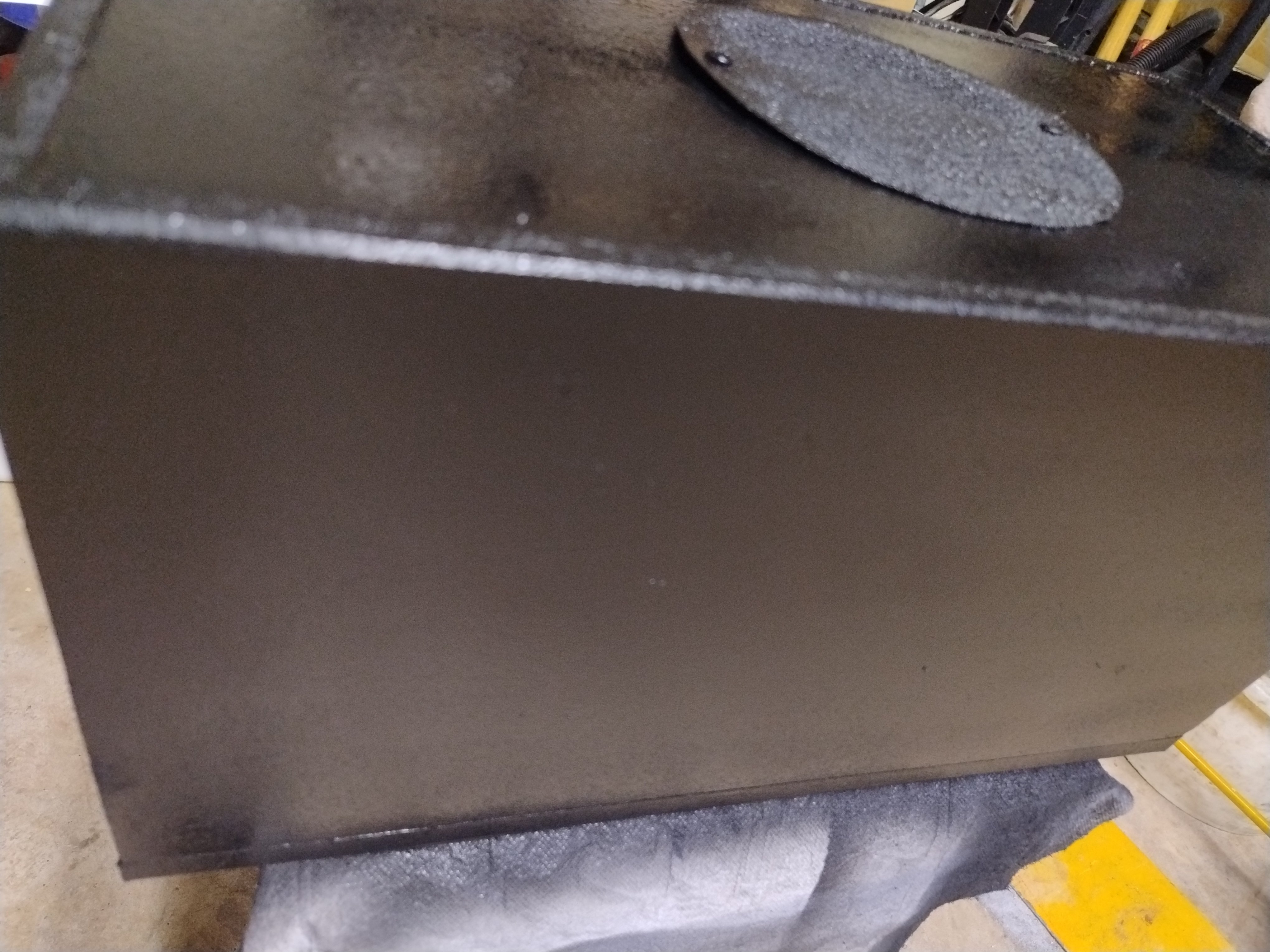

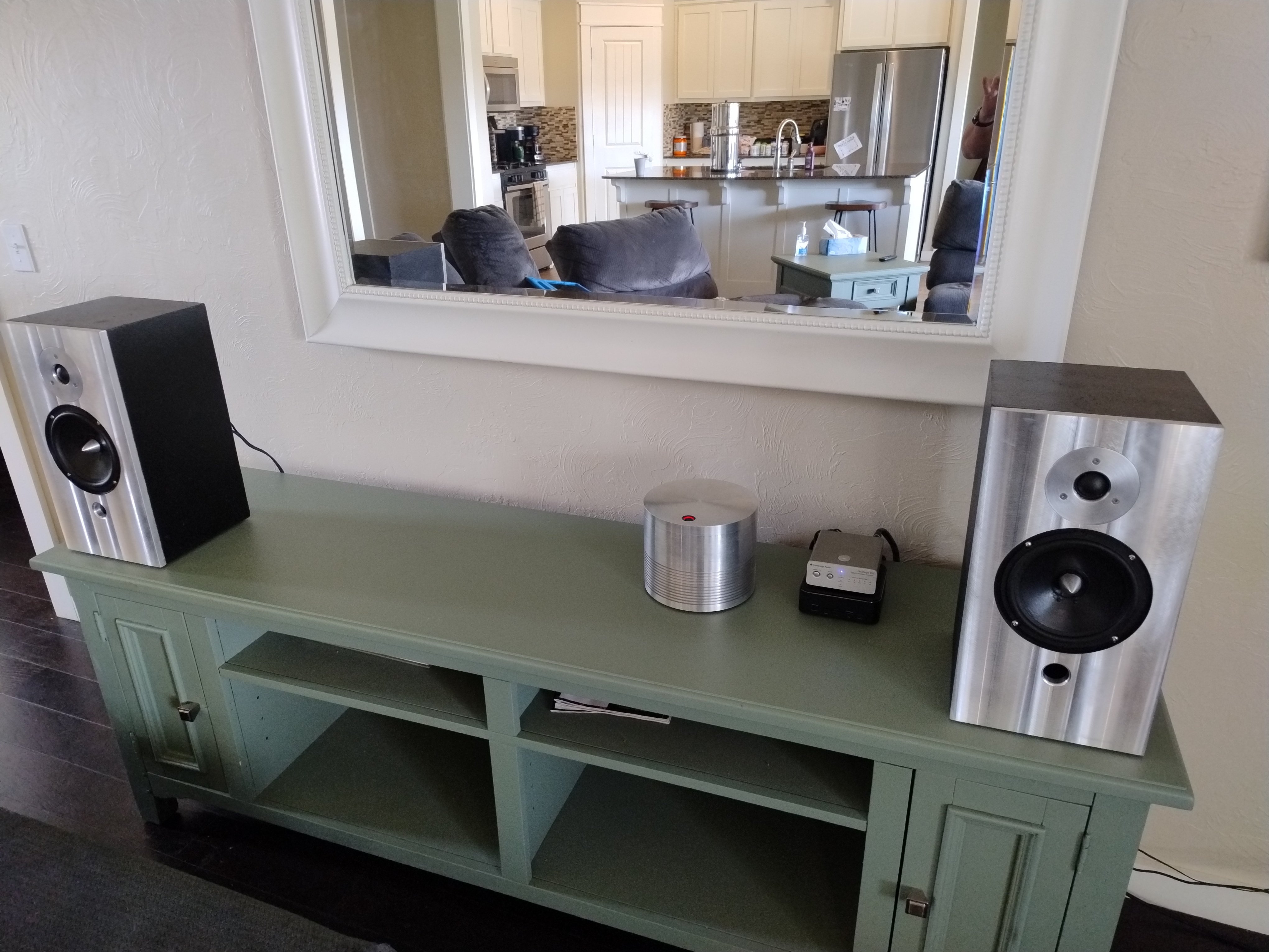

    I'll post my progress here on this side project. Got an old set of these back with a blown tweeter, gouged cabinet and slight dent on the woofer. They were set up in a game room near a pool table.
    Herculiner works better than Rustoleum for sure...
    xschop Posts: 5,389

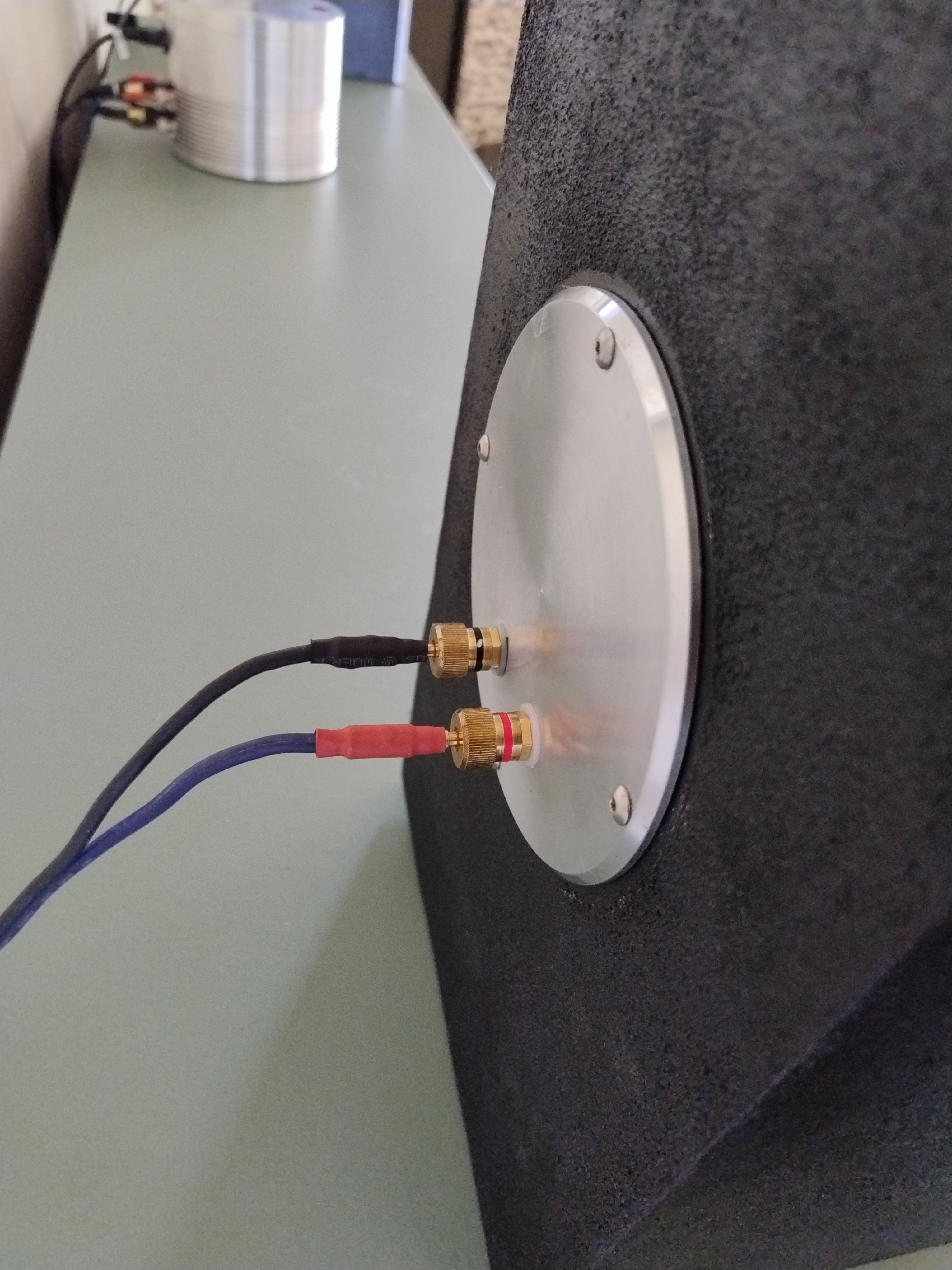

    Soldered in new tweeter leads...
    xschop Posts: 5,389
    This one I carefully sanded around baffle edge and added water putty to area that particle board got gouged. Luckily no metal was nicked. Rest of it looks good.
    xschop Posts: 5,389
    Cabs are done. I'll have to throw the other one together in the morning and have a listen. Only spare plugged 6502 I have on hand has the 8 hole mod and a carbon fiber one....
    Wonder what Mr. Polk would say @ what I do to his classics...

    Really could care less what anyone thinks. Best sounding vintage midrange from these. Just gotta dial in the highs. Looks like this tweeter just needs an extra 0.5 ohm on the circuit.
    F1nut Posts: 51,970

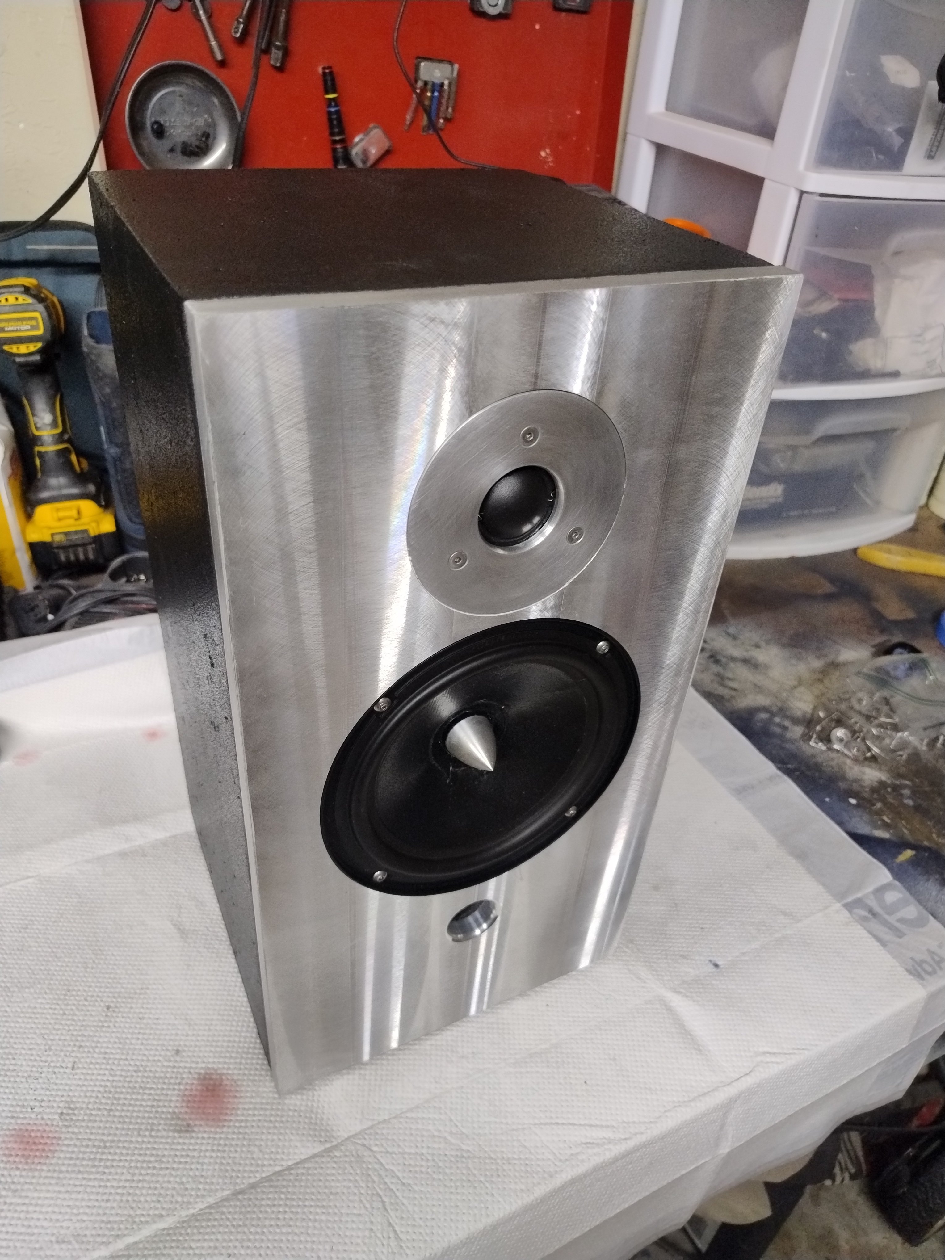

    I like the look of the aluminum bezel. How thick is it?
    xschop Posts: 5,389
    edited March 22
    All of them were 5/8" 6061-T6. Think I stated it before. The KSi of the alloy versus the particle board is a huge difference.
    Got a couple 2 ohm resistors to swap out later this evening. It's really hard to say if its even needed.
    Amazing the bass these put out too with the extra air space and port size.

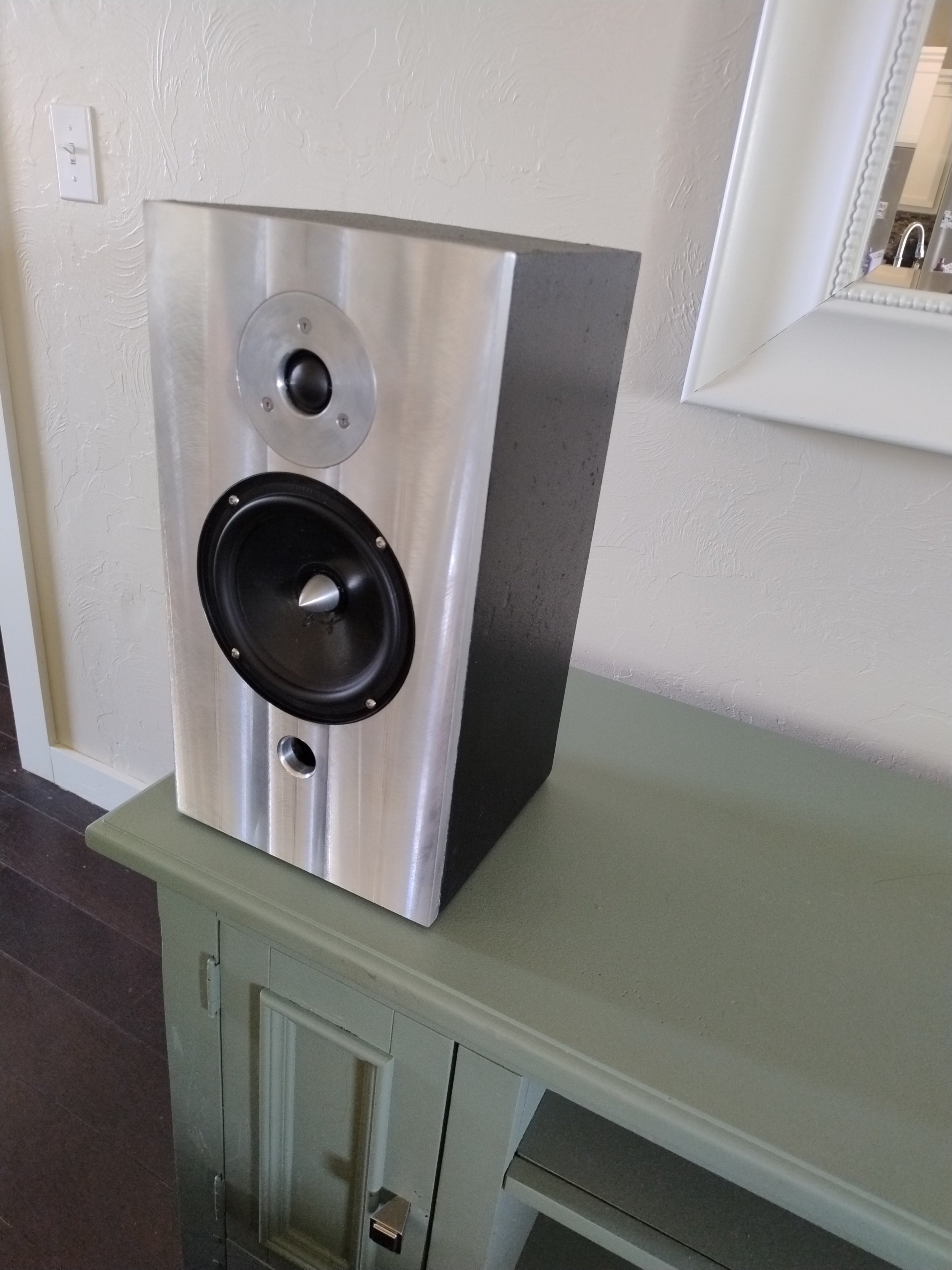

    WAF factor is a hit too and I like I dont have to build stands...bonus
    I'll let the forum decide. Billet face CRS+ this go round?

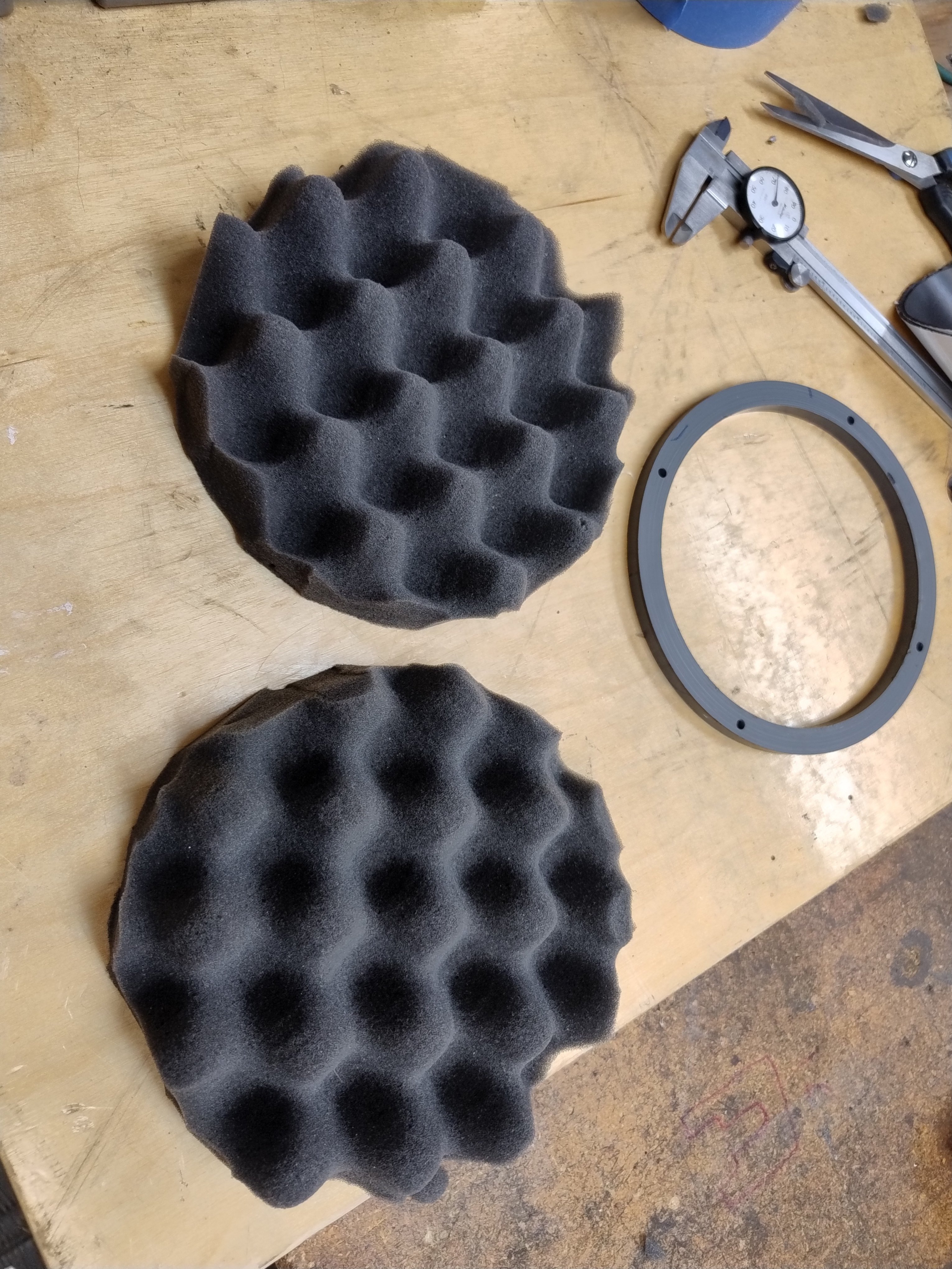

    Made newer gaskets from 0.070" self-adhesive neoprene foam rubber material.
    Also will install 6" diameter sound absortive foam on top of X-overs as they sit right behind MWs in these models....
    And these drivers I put in already had @Gardenstater
    foam frame mod done to them as well...
