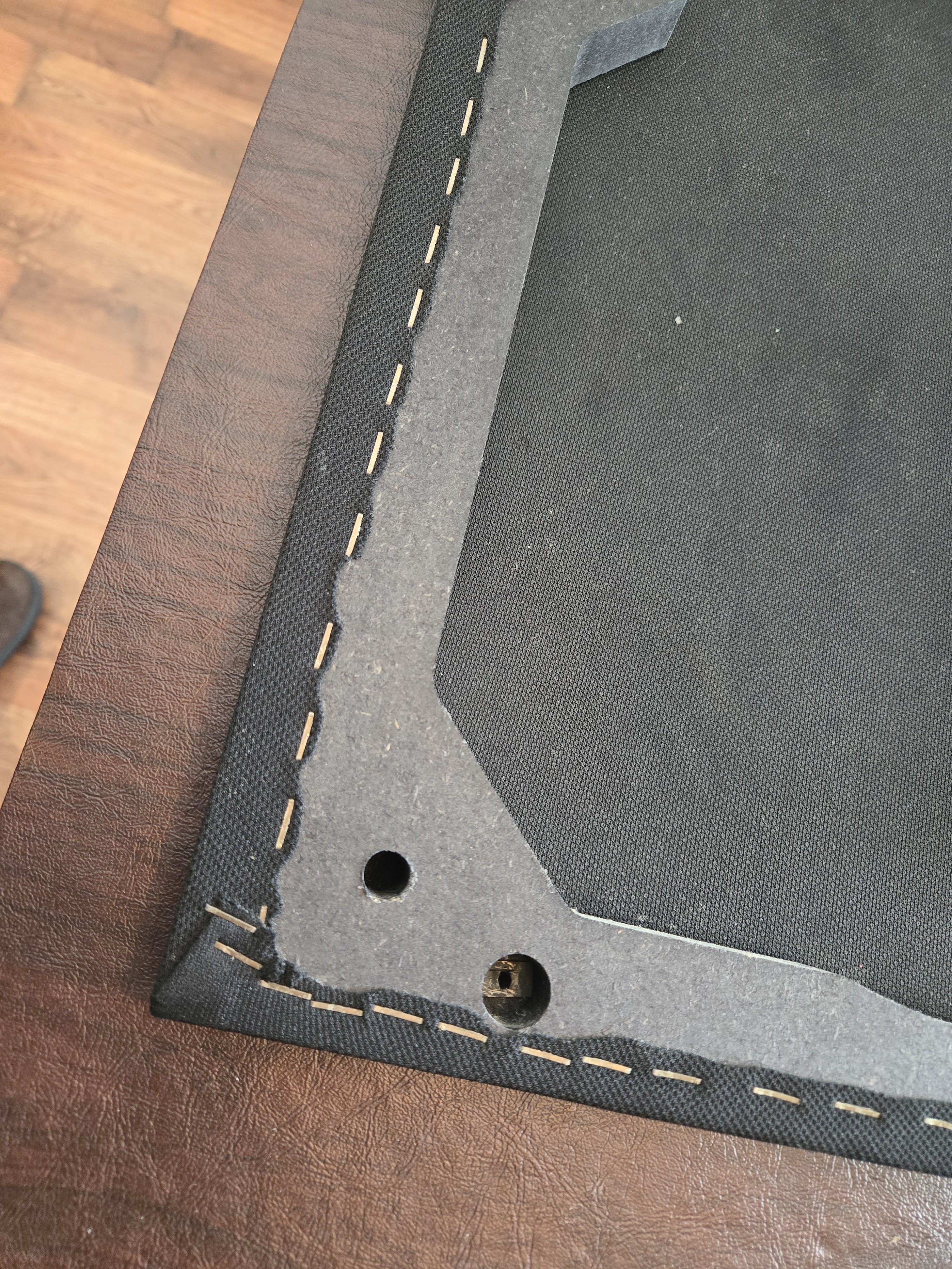

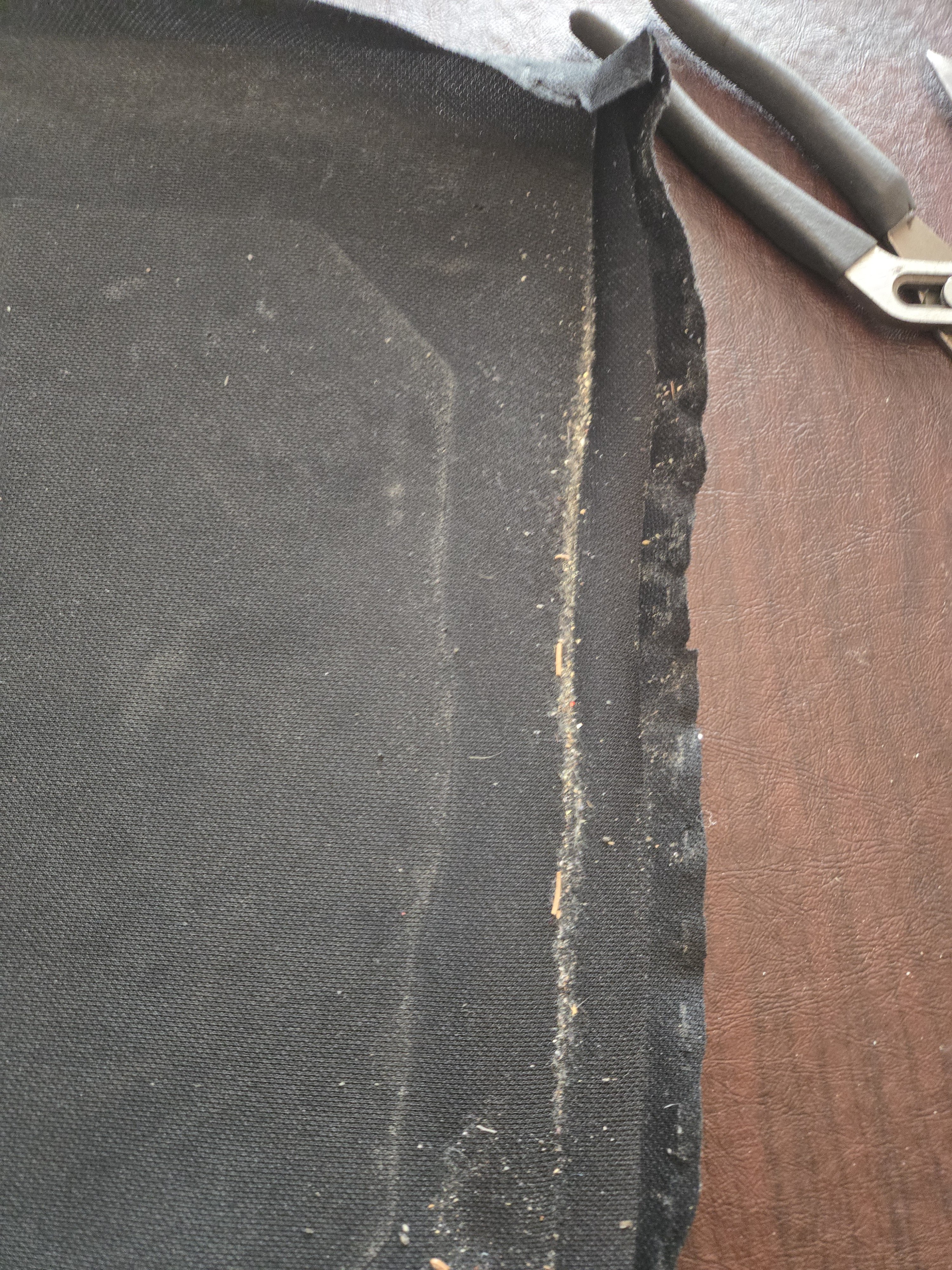

    A quick question for vintage experts. Is this the factory method used around 1990 for attaching the fabric or has someone already redone these in the past? I recall my RTA11T used glue for the fabric.
    Edit: after taking out most of the staples, I don't see any glue residue. I guess this was factory.

    Just checked my SDA 2B Studios (bought in 1988). The fabric was glued on. No staples. The uneven cuts in yours would suggest they were redone.

    Yes, my sda2a was the same way.

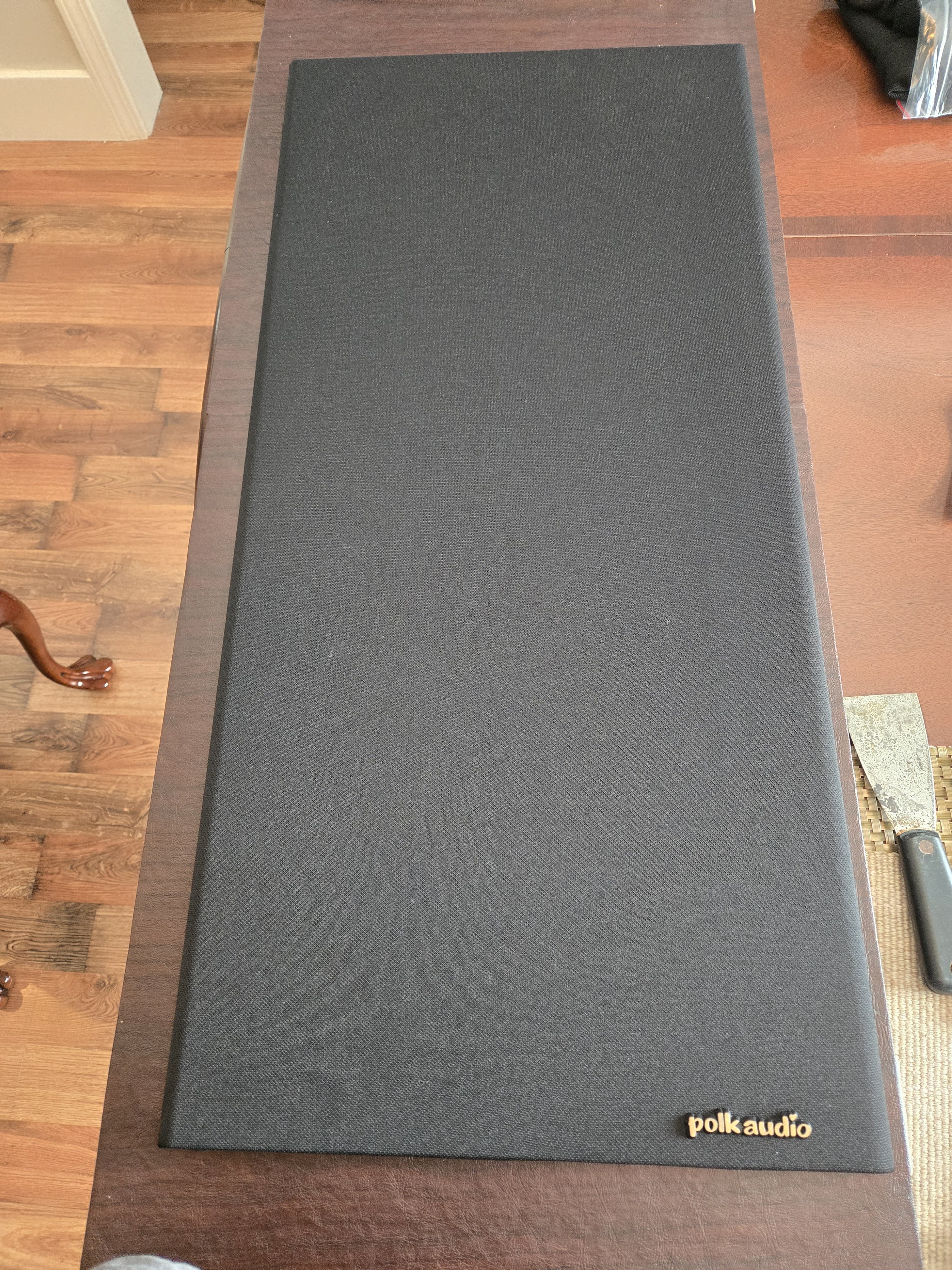

    35 years of dirt 😬
    Done with the first one.
  • Conradicles
    Conradicles Posts: 6,388
    Looks fantastic! Good job.

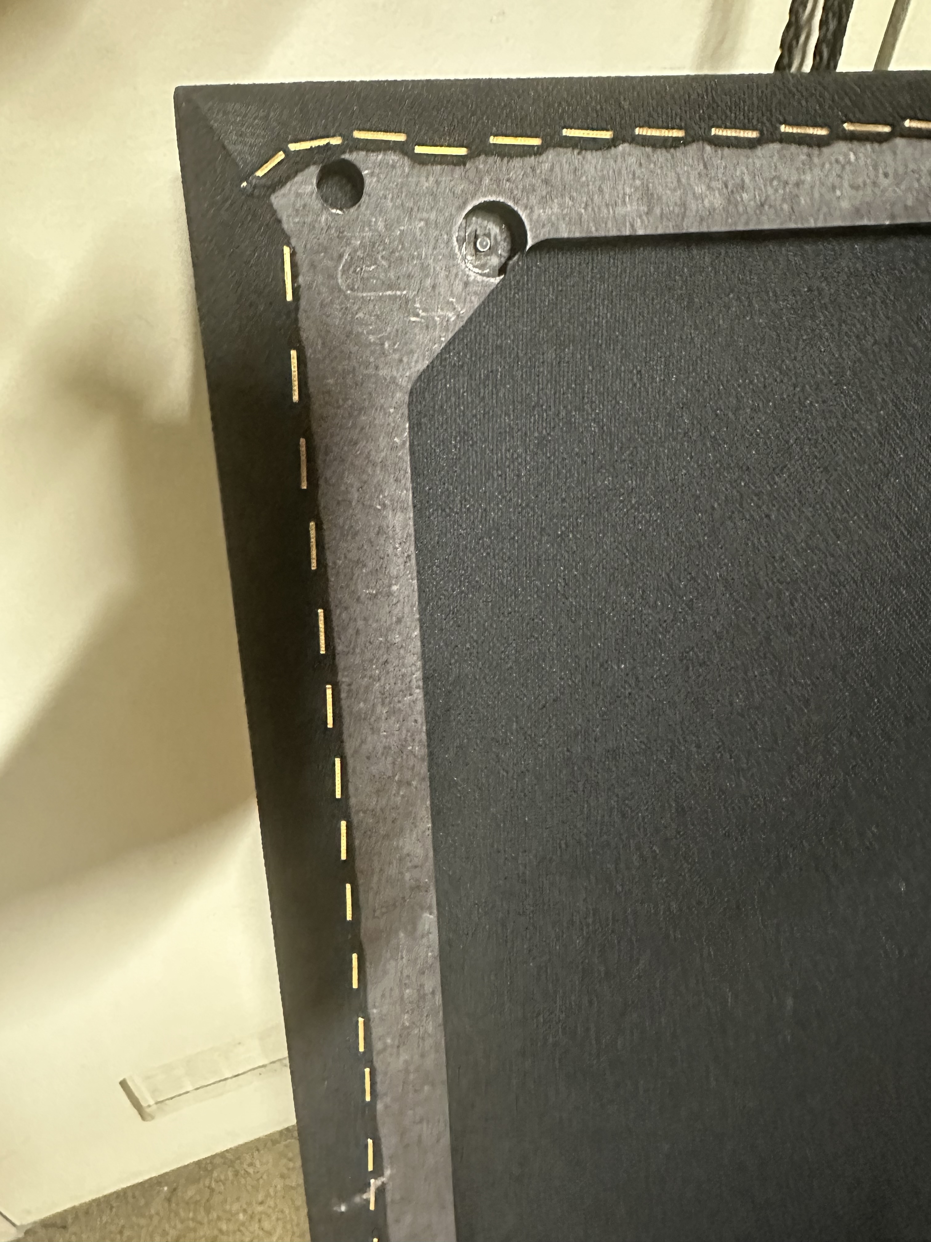

    A little late to the party, but my 2B Studios (originally blade-blade):
    Jay
